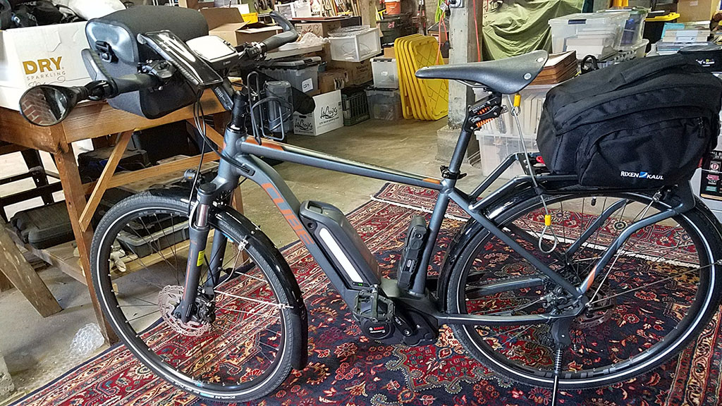

That looks totally boss! Those tires look great. Hows the ride? Pros and Cons? What model Cube is that anyway?
My Cube is a Touring Hybrid Exc 500. One suggestion I might offer. I suspect you will find the original fenders not quite wide enough to really keep you dry on a wet road. When I went with the wider tire, I went the extra mile and got wider fenders too. It can make a real difference, if the brideg on your front fork has enough clearance. Of course my tires are not quite the fattys that you got at just 2". Are yours the 2.5s or something even bigger?
Thanks Alaskan for the kind comments, your bike looks awesome too, love the colour matched rack . Cube cross hybrid pro Allroad is the model. Yes I had to up the size of the fenders from the original cube 50mm to planet bike cassidia 65mm fenders so that I had full coverage. The tires are 60mm (2.4”) so not quite fatbike but pretty beefy. As far as the trade off goes, I would definitely say that they do not accelerate like the skinny 622-42 tires, they likely won’t be as efficient and I will probably use a higher level of assist to compensate (or get a better workout). That’s ok by me though because the battery will last me to the office and back without issue even in turbo mode if necessary and I feel much safer at speed and cornering with these on and my teeth aren’t rattling anymore. I think bigger tires are a luxury that is made possible by an assist and I think that something like this (or your 2” big bens) are a better match for these bikes. I did keep my original wheel set and I will probably fit some big bens on them. I can probably get better efficiency on the big bens if I’m going on a longer ride but I will stick with the 2.4s for my regular urban riding.

So here’s the finished product with fat 29r fenders added. I’m loving this for the streets of Toronto in spring (also known as construction season). The whole bike no longer rattles going over cracks, potholes and manhole covers.
Bike looks great! I have the exact model and I'm thinking of getting Big Apple 55-622 or 60-622 for mine, as I don't have any 27.5" rims. You didn't have any problem fitting the Super Moto-X tires to the frame at the chain stay? I'm a bit consern that 60 mm might be too close.
Hey Johan,
No issues with the fit of the supermotos on the chain stay. I have about a 6mm on either side. I bought the 27.5 rims off kijiji for 120 so I didn’t feel so bad about buying rims. Having said that I also fitted the 50-622 big bens on the 622 rims and they are awesome as well. I think these are the perfect tires for this bike. I will be using the super moto tires for winter but the big bens are way faster.
