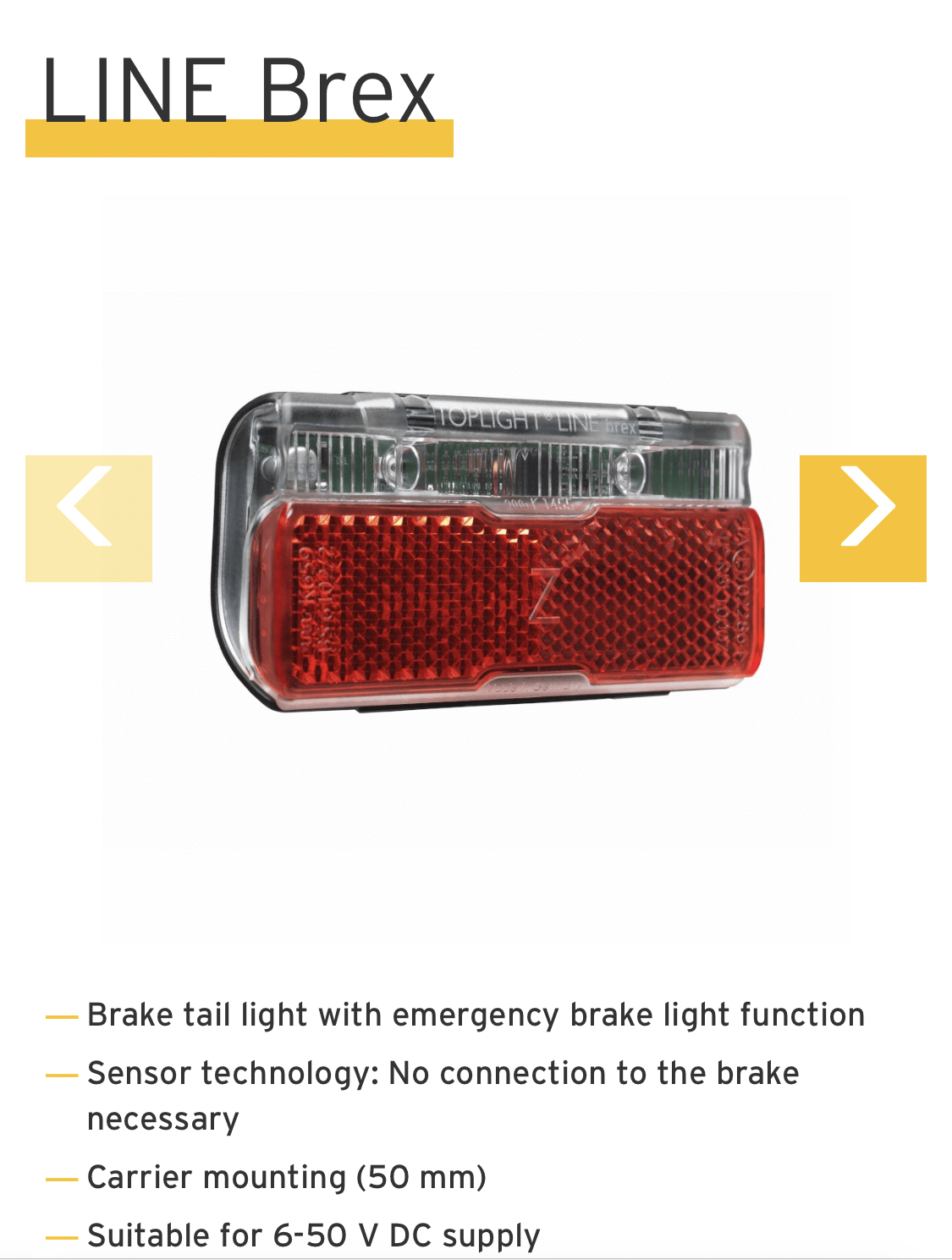

Update.
Swapped the rear light for a Busch & Muller, Line Brex rear light. This has a braking function, but works sensors, rather than needing a switch and new cabling.
Admittedly it is not as immediate as the SuperNova as it doesn’t come on when you start braking, but when you are almost stopped. It is a good compromise as it is a straight swap for the existing light.

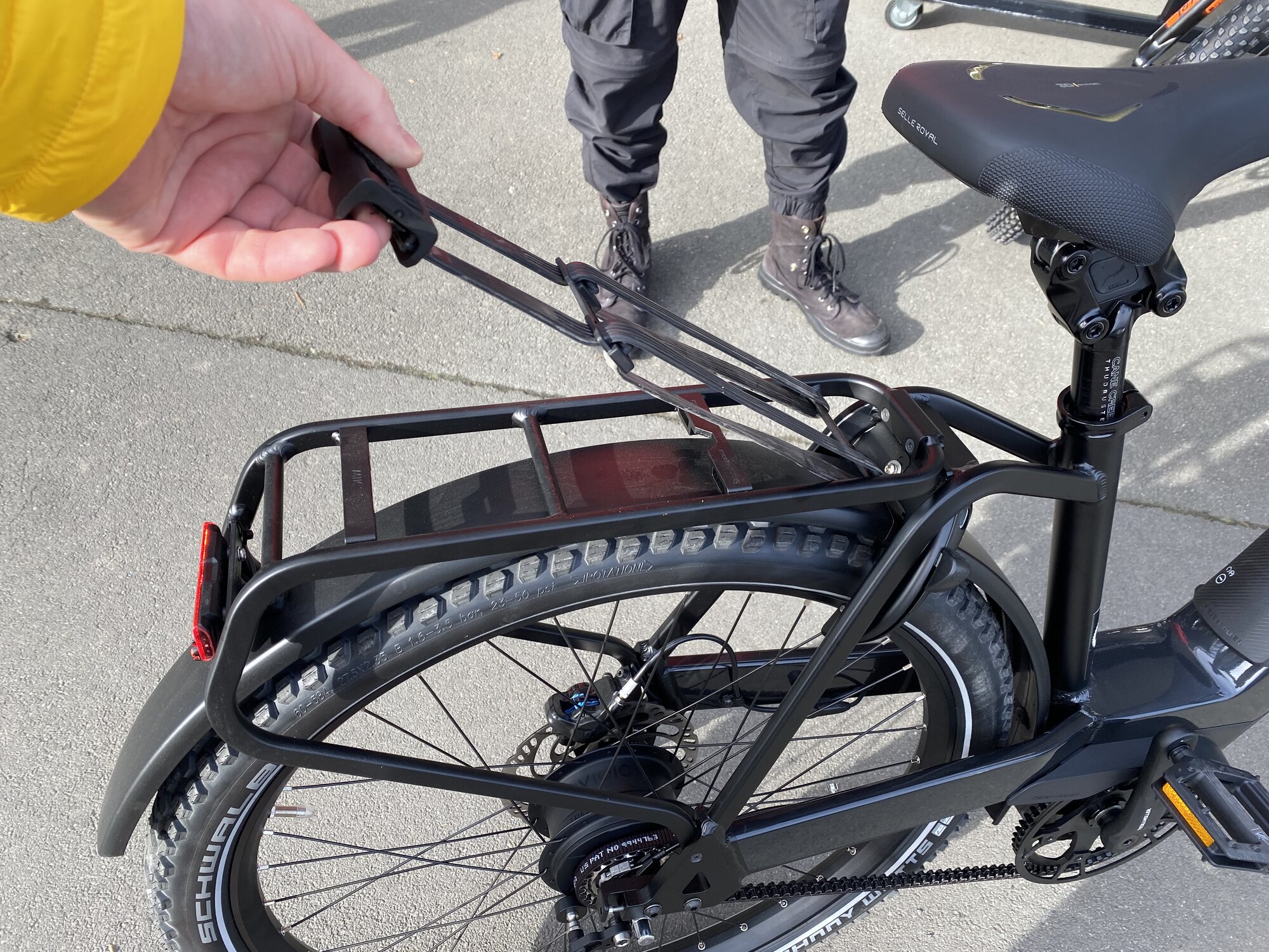

The HS models do have a brake light fitted as standard.
Interesting - explains why my SC2 has it - but we did test ride a Nevo 3 not a HS model and it had brake light - same as your wife’s I guess…. @JVBulman any idea if this a big job?
Hope it’s not a hard thing to retrofit ….
