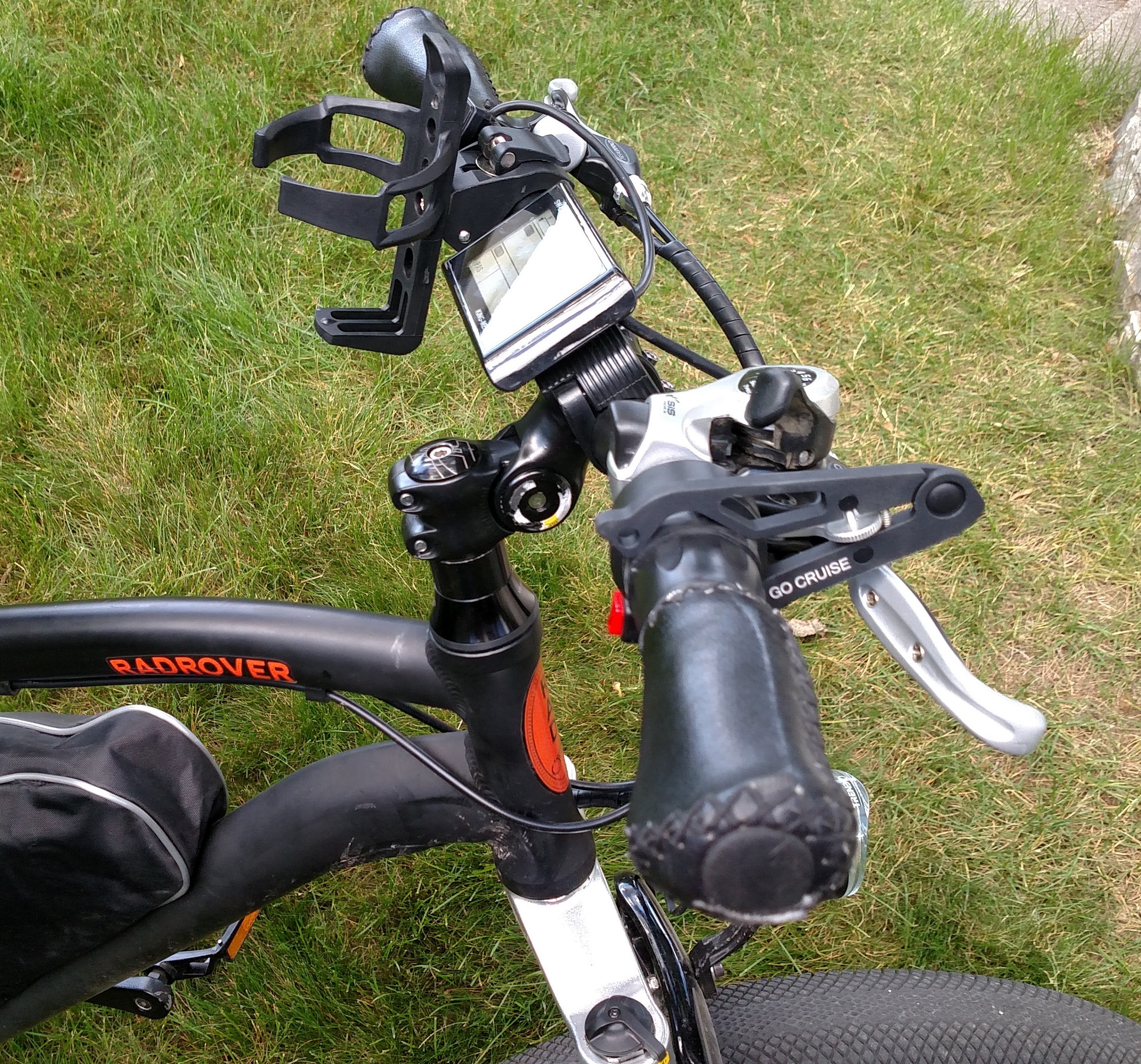

After riding 200 miles with this bike stock, I decided I needed some changes. 1) I added a bottle holder. 2) I went with a new seat and a Cane Creek Thudbuster post. I would have preferred the bodyfloat but couldn't justify its costs. 3) I put on an Ibera PakRak rear rack. 4) The ugliest part of the bike was the battery which really stood out and screamed ebike. So I mounted a Ibera triangle pack. I didn't even notice until after installation that the orange on the bag matches the radrover orange, I like that. 5) I added a device to the throttle that acts as a cruise control. It's a little gimmicky but a fun option. It attaches on and off the bike in seconds. I rarely use it, mainly on long bicycle path type of rides. 6) I wanted to sit more upright so I added an adjustable stem that brought the handlebars both closer and higher. 7) The biggest change would be the tires. During the summer I realized I wanted to go on longer pavement type of rides. I went with the Vee Speedster. A much quieter ride, with the knobbies people would hear me coming a hundred feet away. I gained 2 mph with throttle only. These tires stick like glue on hard surfaces. The trade-off is when I do go off payment you have to be more careful, they do slide out on loose gravel fairly easily. I do live where there is snow in the winter so I will go back to the stock tire in the fall so I can ride in the snow a little bit. View attachment 6391 View attachment 6392

Pic of Radrover with Suntour SP-12 NCX, Thudbuster neoprene dust cover. Taken before replacing the stem and pedals:
Sunlite 0-60 degree 95mm Stem:
BC pedals for my size 14 shoes:
