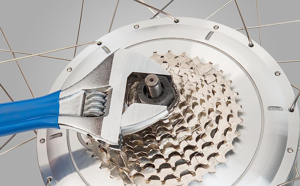

To remove it place the wheel with tire on the ground and turn it counter clock-wise using your weight. You can extend your wrench with a piece of pipe. I am not so sure with a wench though.
You want to buy a Park FR1-3 freewheel removal tool for most modern Shimano freewheels. Its center hole will allow the standard 9 pin motor cable to go thru, if your motor has the cable coming out of the axle. Won't work for the fatter 9 pin cables used on bigger motors.
I found that if I mount the Park tool in a vise, even a 100 lb wench can grab the tire and lever off any freewheel, no matter how bad it was stuck,

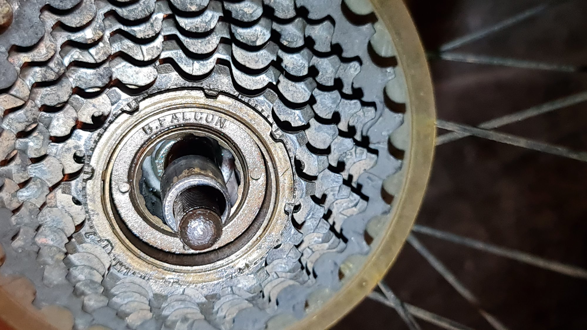

Strike one, tool didn't fit over my 14mm axle. Park tool on order now. Will try again....

If it looks similar ~ 12 point Spline Tool is probably FR~7.
Remove axle to use tool.

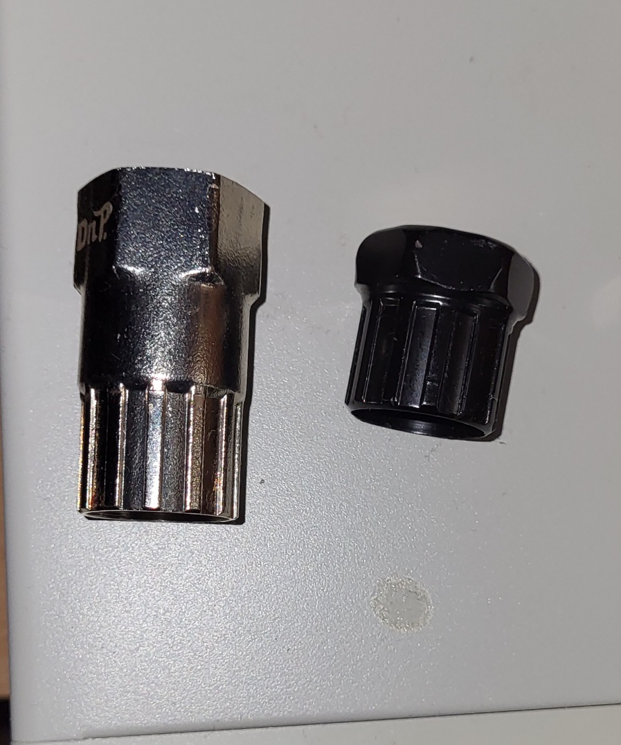

Just ordered one of the freewheel removal tools from Area 13 for the dnp freewheel. Hope it fits over the M16 axle and into the splines for the Wired ebike.
The tool should fit over the axle and into the splines. It's the hole in the end of the tool that has to be Big enough to fit over your motor cable connector.
I bought a $27 drift maniac dnp freewheel and the $16 dnp removal tool to go with it.
It came to $88.86 CAD with all the shipping and tax. 😁
https://forums.electricbikereview.c...required-or-not-necessarily.57147/post-670650

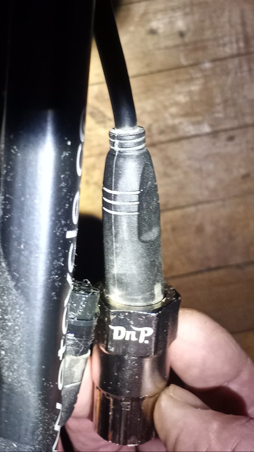

The removal tool has the large hole and my Big 750 watt motor cable connector from my first ebike fits through it,..

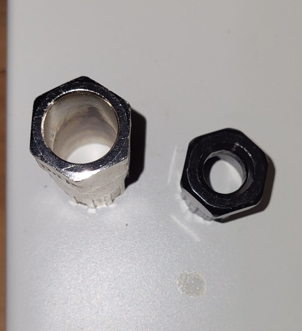

The dnp removal tool is made with proper steel, and it's got a longer reach than the standard knock-off removal tool,..

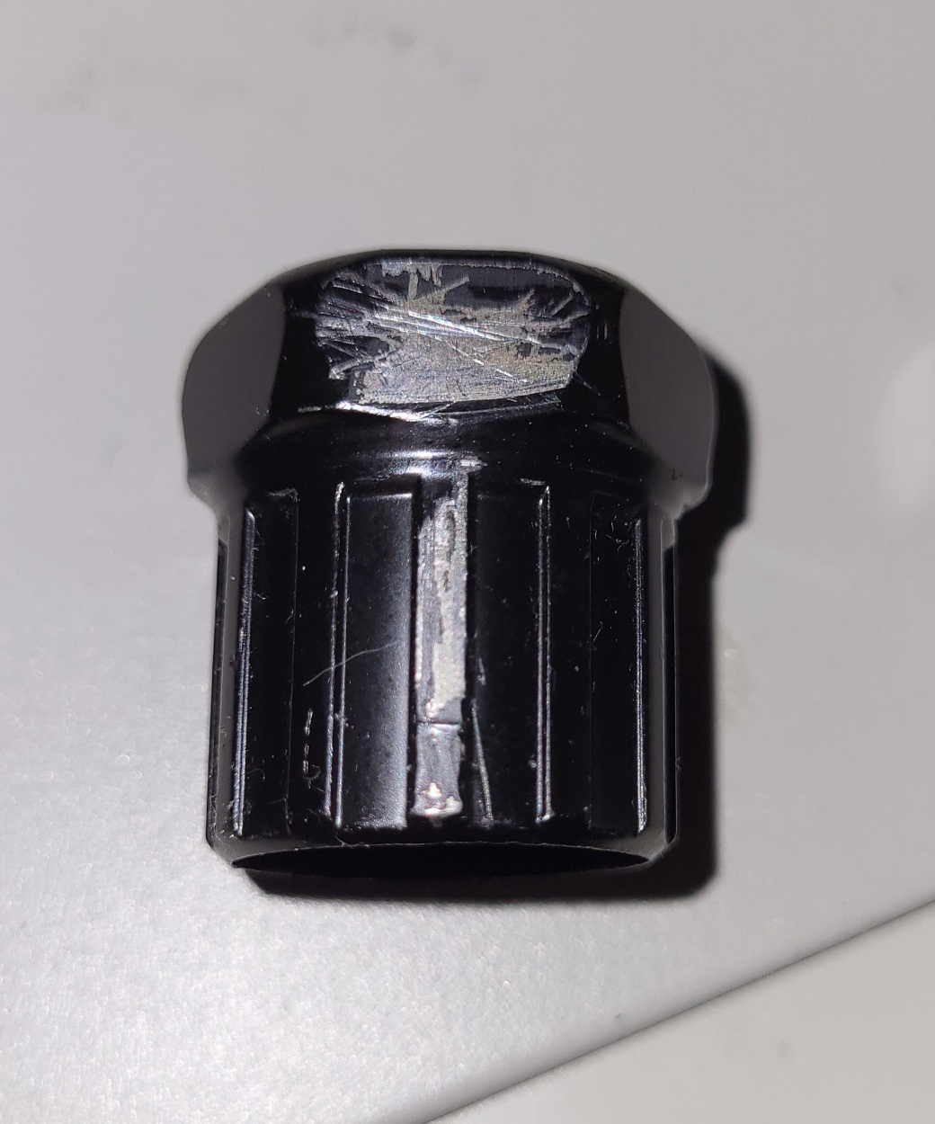

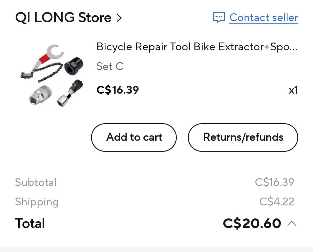

I bought a cheap set of bike tools for twenty bucks,..
It came with the freewheel removal tool, but its a cheap piece of crap.
They paint it black to made it look like hardened steel. 😁
I could easily scratch right into the metal with a dental pick,..
The rest of the tool set is junk too but I wouldn't hesitate to use them, but the freewheel removal tool is Really Thin Walled and the freewheel can be seized on with two tons of torque.
Not only would the tool break, but it's quite possible to twist the end off the tool and have the splined part broken off and jammed inside the freewheel with no way to get it out.
