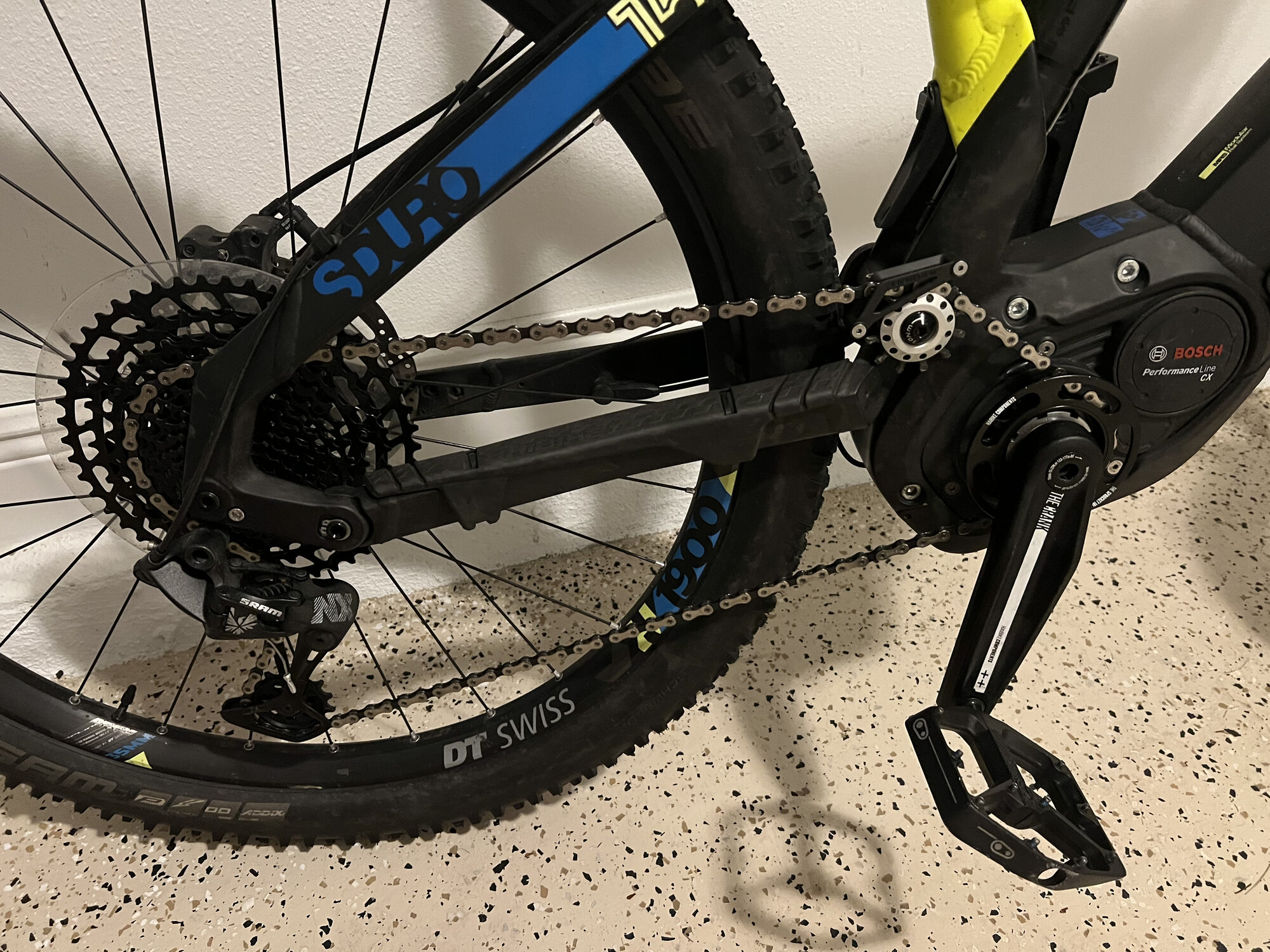

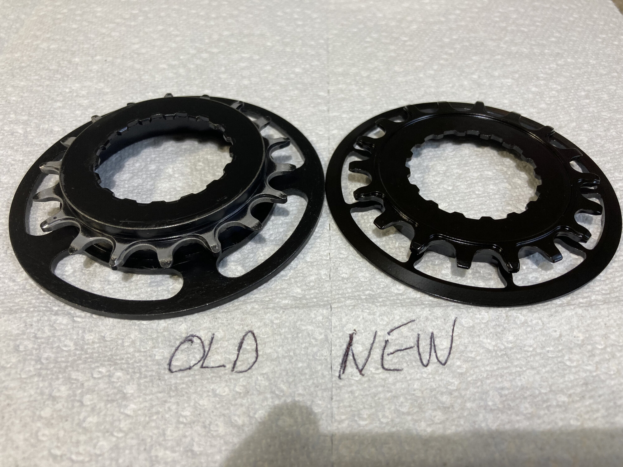

I have around 1100 miles on my 2019 FullSeven 9.0. I measured the chain with a digital caliper and it is time to replace. I ordered, sized and installed the new chain, and then found some pretty bad skipping. So, time to replace the cassette and chain ring also. Seems I was remiss in not replacing my chain much earlier, or I should just wait until it’s unrideable and then replace it all.
I found the sprocket for $82 delivered from France. NX Eagle cassette $102 on Amazon. Chain $40 (I bought the GX chain). I need the Bosch Gen 2 lockring removal tool for $28. And a chain whip a kit for removing the cassette for around $20.
So, looking at around $275 to get it done, doing it all myself. Not cheap.
Are you guys replacing your chains often to reduce wear on the rest of the drivetrain? Has anyone tried using a cheaper front sprocket? There is a 5mm offset so I’m not sure how that plays out.
I do ride in some nasty dirt, sometimes mud, lots of debris, so that isn’t helping…
