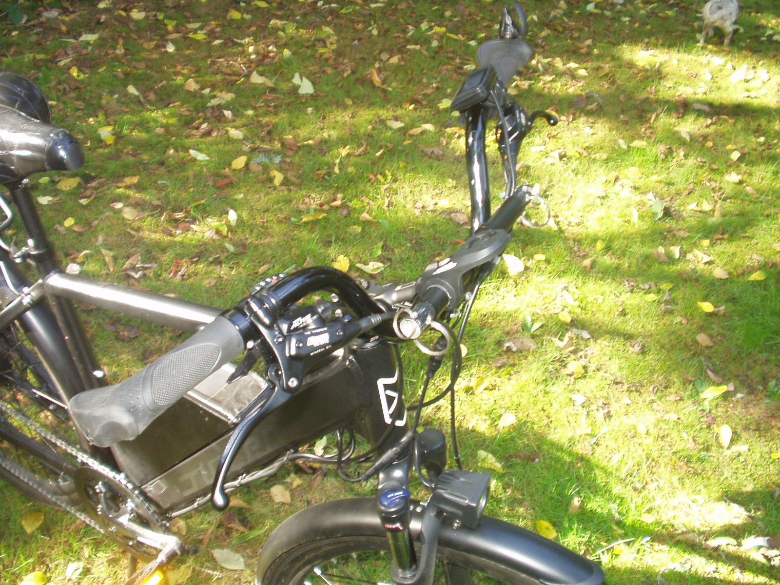

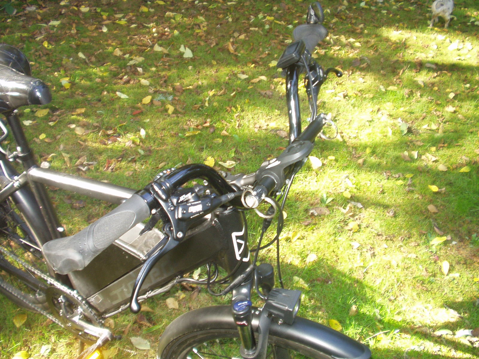

I just got my new handle bars installed. And they look and feel great. With neck issues this is a much more comfortable riding position. ( And the adjustable stem)
thoughts?
Andy

I've never seen that sort of bar before! It looks great. Me too: neck issues. I will look into it after I get my CCSwehopeinnovember
If it’s comfortable to you that’s all that matters. Which stem is that? I’ve been looking for a shorter adjustable stem to raise my bars.
You'll definitely need a shorter stem... Had just enough room with the brake cut off sensor after I clipped a zip tie up there. Clearance is good. Still a tiny bit if slack at 90 degrees

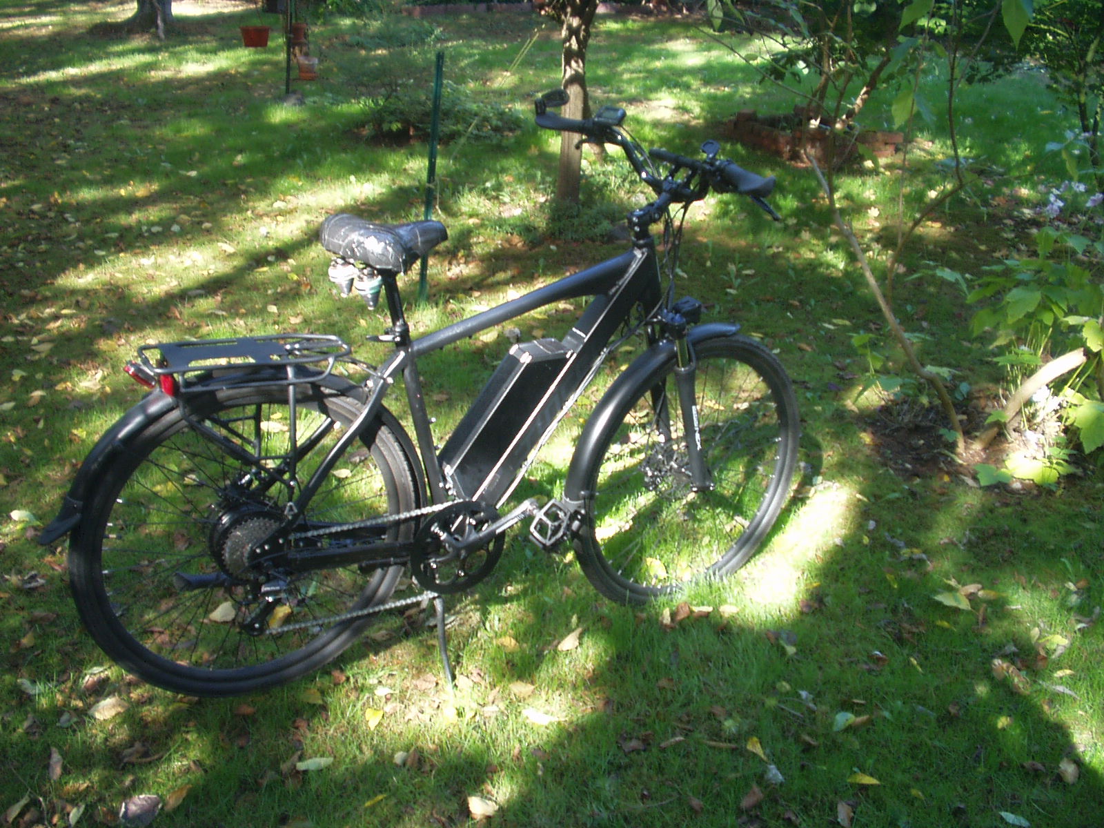

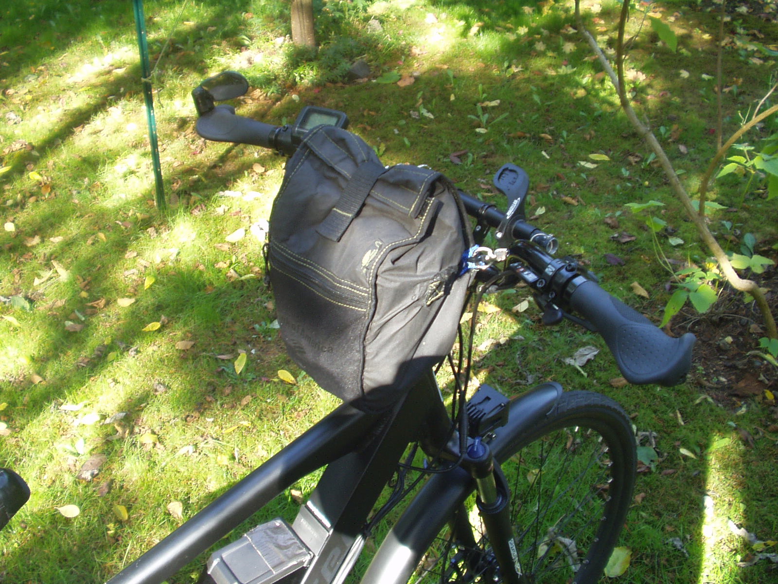

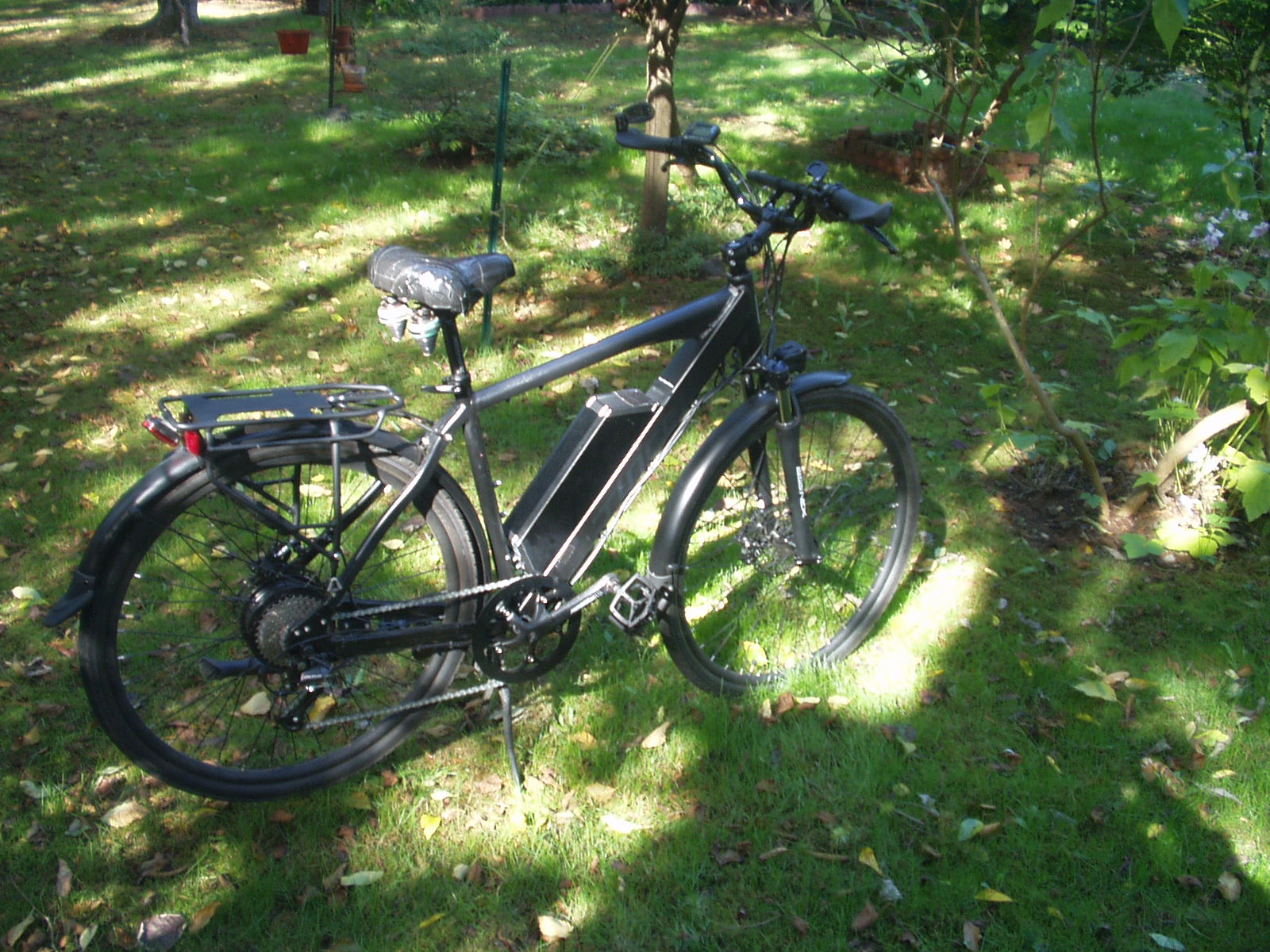

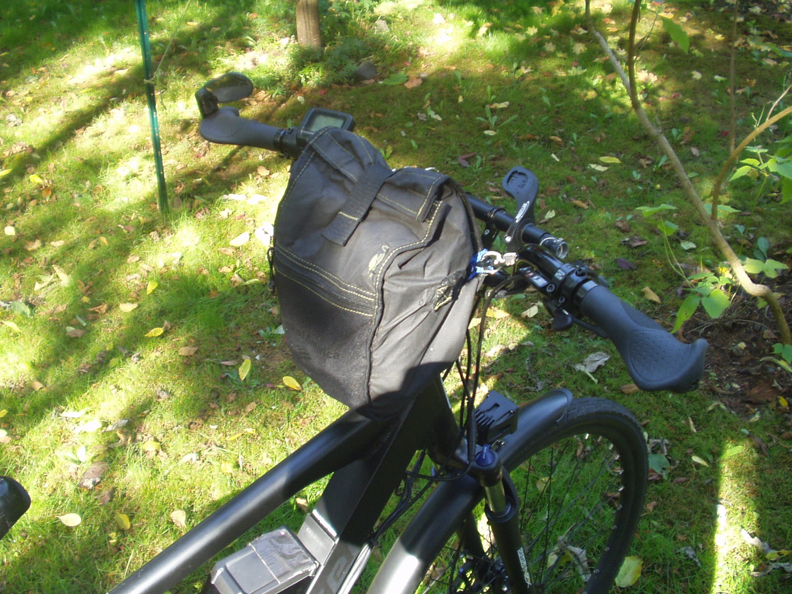

015.JPG Here are a few other things I've done toward making my CCS not just a commuter, but a travel bike as well: 1) after the golf club
mirror failed, I simply bored out the end of the ergo grip & installed a quality *Mirrycle bar end that can rotate inward out of the way.
The internal clamp still holds the grip in position. 2) i swapped out the black, clip-on bar bag for this one,(better fit, more functional).
Top part holds glasses, a hex set, lock,& needlenose. The bottom half, gloves, a ski mask, small first aid kit, tube, levers, & a space blanket.
3) My in-frame, made from a carry-on,($6,Goodwill), fit on the top tube like a saddle. My heavier tools go in the bottom. 4) I opted for a double-legged kickstand as well as the rear mount. it allows me to rock either wheel off the ground for service or tuning.
