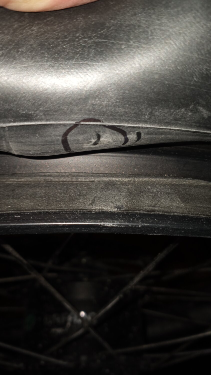

I have a set of 27.5 x 2.8 Schwable Super Moto X tires on my e-bike and I got a flat yesterday.
As the tire was going flat I could see the stretched/buldged couple of linear inches of abnormal shape of the sidewall as the tire rolled around almost flat. (I stopped 4 times to fill the tire to make it home without riding on the rim.)
I was surprised at how thin the sidewalls are, and that's on a "Moped" rated tire.

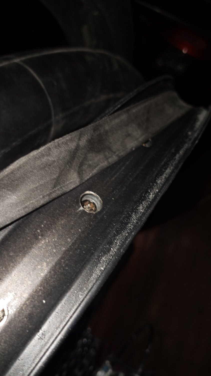

As it turned out, my rim tape had slipped and the edge of the spoke hole cut the tube.
So it wasn't a tube or tire failure.
I'm going to glue the rim tape in place or use Gorilla Tape to replace it.
I had flat-out with me when I got the flat, so I put about 10 ounces in the tube and couldn't figure out why it wasn't working and why I couldn't see the flat-out leaking out.
There wasn't a drop of flat-out anywhere. It all stayed in the tube.
It couldn't find it's way to that part of the tube.
