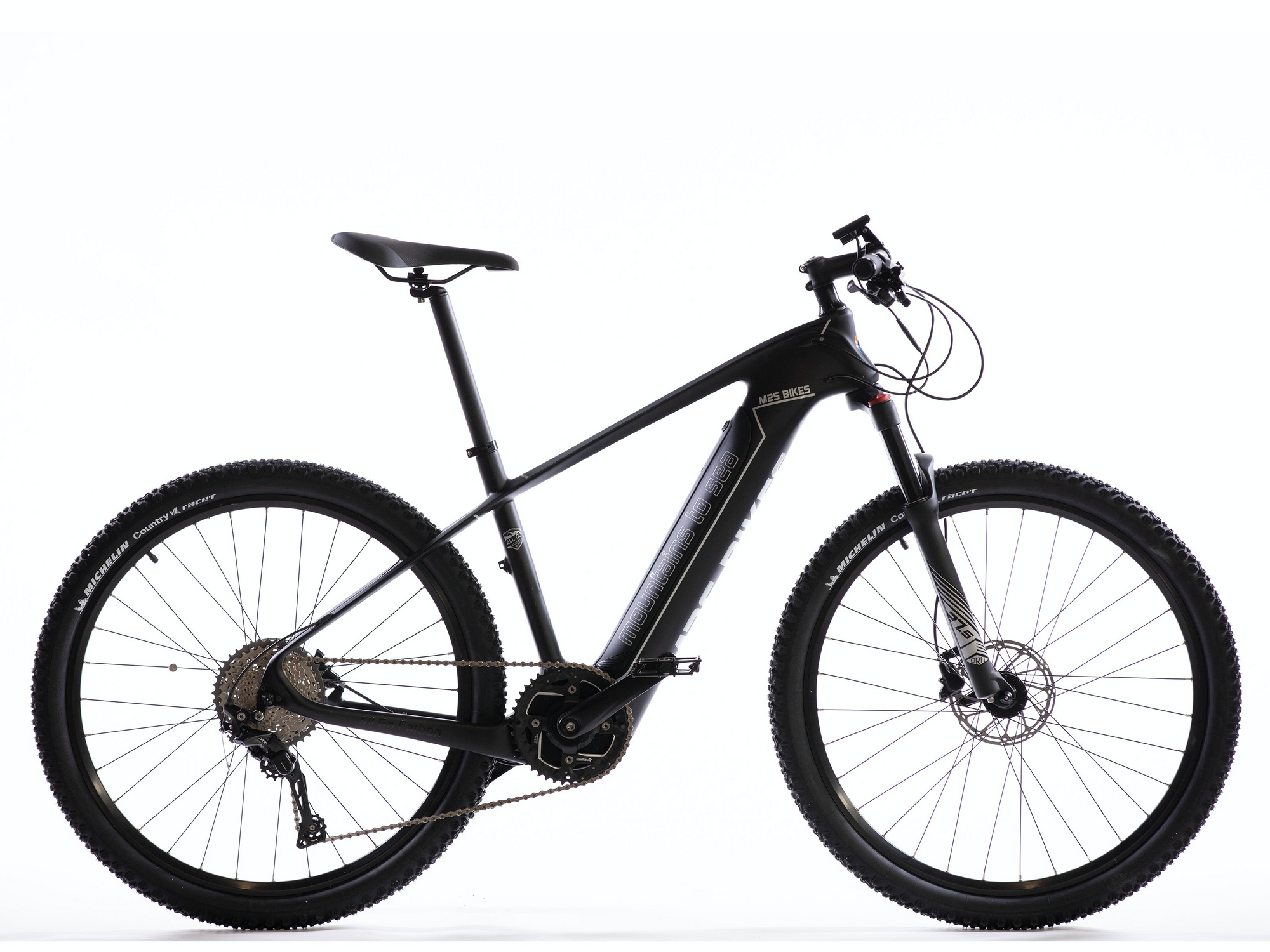

M2S All Go Carbon Fiber Electric Bike -38lbs. w/battery - $3299
If you are building a bike like that then counting weight could make a difference, but that same bike in metal would probably only be 2-3 pounds heavier. It also have a small motor and a 400 wh battery.
