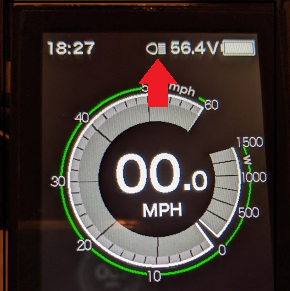

@Feliz are you using the stock Bafang display on your UC, or did you change it out for some other display like the Egg Rider?
@Feliz ...And even when this icon isn't present on your controller the front headlight is still on?
Gee, I never noticed, it's sunny here today and with my 80 year old vision I was having trouble seeing the display. I keep my bikes in a storage I rent and I'll take a look when I go back after lunch. Thanks

Feliz, Please note that your lights are the Light and motion 1800Lumen lights that are wired into the battery. They are not tied to the bafang controller. These lights have a DRL (daytime running lights) similar to Supernova lights and don't have an explicit off.
If you don't want them on, I would recommend unplugging the light from the battery (there is a connector if you trace the headlight wire).Let me know if this helps.
