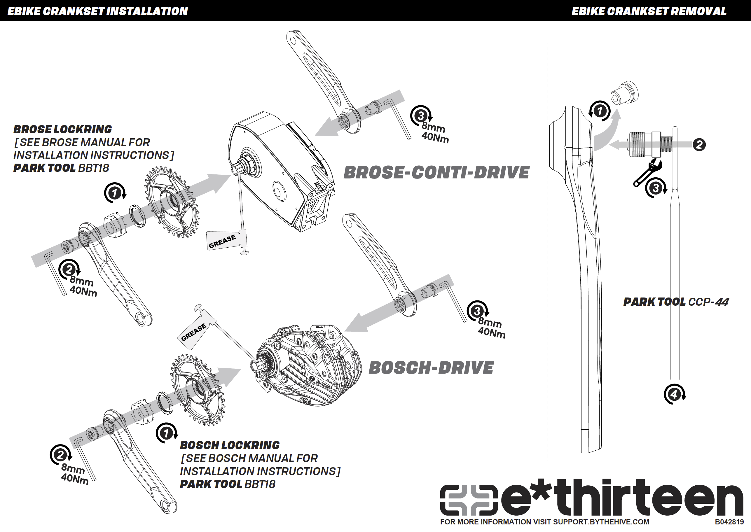

Besides that, the toque spec is mostly concerning the material your are screwing the bolt into. And yes, in the bikeshops where I worked I've seen to many bolts worn-out which took us time to get them out.
On most DU's the crankshould be tightend at 35Nm, in a JIS BB the crancks go on 40 Nm, only Sram crancks go on with 50Nm, Cassette and centerlock lockrings also 40Nm, postmount bolts in general at 7Nm (between 6,8 and 7,4 Nm for most brands) so not that many values to remember.
And indeed, I am in the bike bussiness for almost 30 years now.(Trained in a differrent branche where would tighten bolts at 400Nm+... So bike tech is easy)
Hanging bikes under a carport is obviusly a perfect solution.
Bosch BNI cranckbolts go between 40 and 60 Nm, just came upin my brain.

You posted torque specs for crank bolts that aren't M8 x 1. The spec for this bolt is 17nm. I put a plastic handle on an ISO 2936 8mm hex socket key so I could torque by feel and see how many Newtons it put on the pedal. Then I took the handle off to see how many Newtons the key would let me apply to the pedal. It was almost the same as when I torqued by feel. Then I did the math. Both were slightly over 17 Nm, the spec for that kind of bolt.
