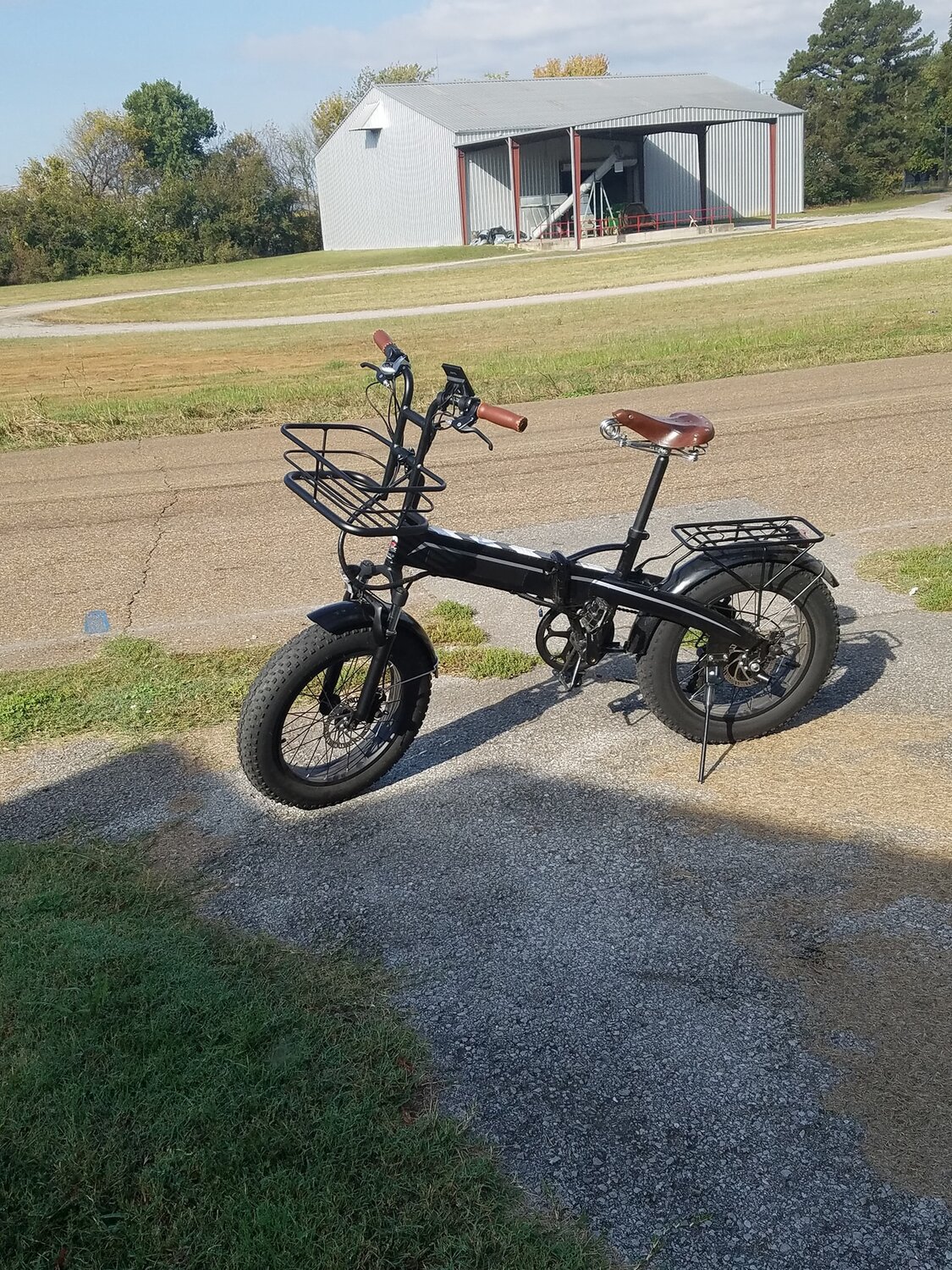

I added the suspension seatpost, son did the front suspension conversion, removed the long stem and put on motox bars, hydraulic brakes and it rides real nice. Much more stable once the long stem was removed-the downside is now it is a PITA to fold...
Pictures coming...
