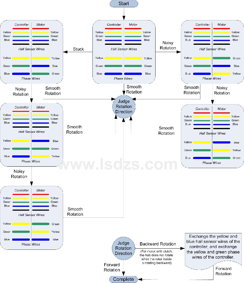

I think you are on the right track assuming that the "whir" but no motion is the motor running backwards. "Ratchety sound if I reverse 2 phase wires" leaves me clueless.....
Is this a sensorless controller, or are you using sensor wires? If using sensor wires, are you switching those to match your changes on the phase wires?
Motors can run backwards inside a geared hub. I've flipped the two phase and two sensor wire intentionally (bottom of diagram) to see what it's like. It's strange,
Or you could have worn out the clutches, but I would expect some movement if the wheel was lifted.

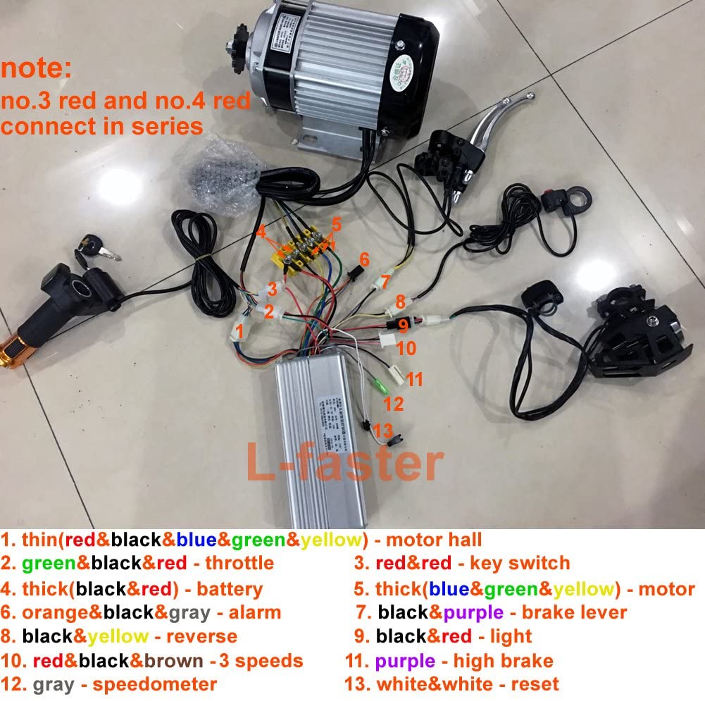

Next will try reversing 2 phase wires, also same color sensor wires. Or if I can figure out the chinese labels, activate the reverse input. Some of these scooter compatible controllers have a reverse input. The English documentation of connectors & wires is unavailable on the controller I bought.

Was no yellow+black 2 pin "reverse" connector. Is grey black 2 pin ????.
Okay, swapping 2 phase wires & two sense wires made wheel stick. Swapping 2 other phase wires made it rotate forwards. thanks for diagnosis chart.
One other question. This controller has a 3 pin rectangular block, female pins, blue brown black. Might be 3 speed input. Blue & brown are +4.9 v to black. How does this work? single pole double throw switch, black to middle, one pole makes slow, other pole makes fast?
This is not my controller, just something close. My operating system didn't have screen capture when I bought the 500 w controller that is working now.
