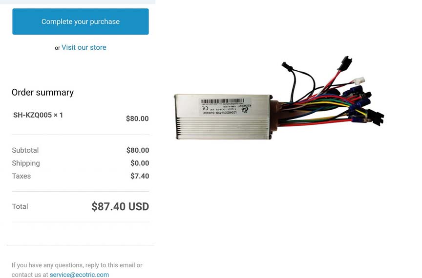

I'm looking at a post today on the Ecotric facebook group where a Rocket owner says he bought the Ecotric SH-KZQ005 48V controller. $87.40 shipped from Ecotric. . He already had the 48V pack, Ecotric uses a generic pack. Just make sure the battery contacts match.
