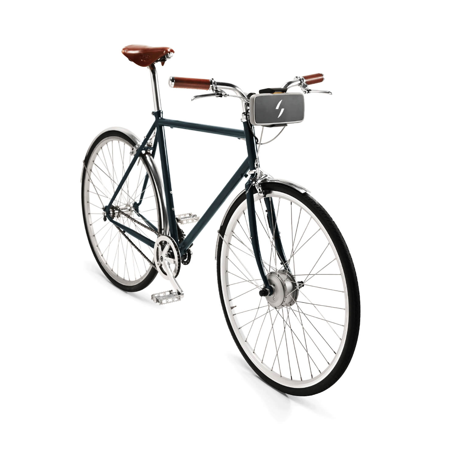

Is the conversion kit you looked at a Swytch?
I saw a few of those kits running around Crater Lake in Sept. The riders looked like they were doing well without straining, one passed me up on a long grade and he was only intermittently pedaling.
Here is the web site with an elevation graph from that ride to give you an idea of the hills they rode.
It should be an easy installation for anyone who can swap out a front wheel but bike shops in Europe might sell this kit and install it for you, maybe even have a bike to test ride(?).

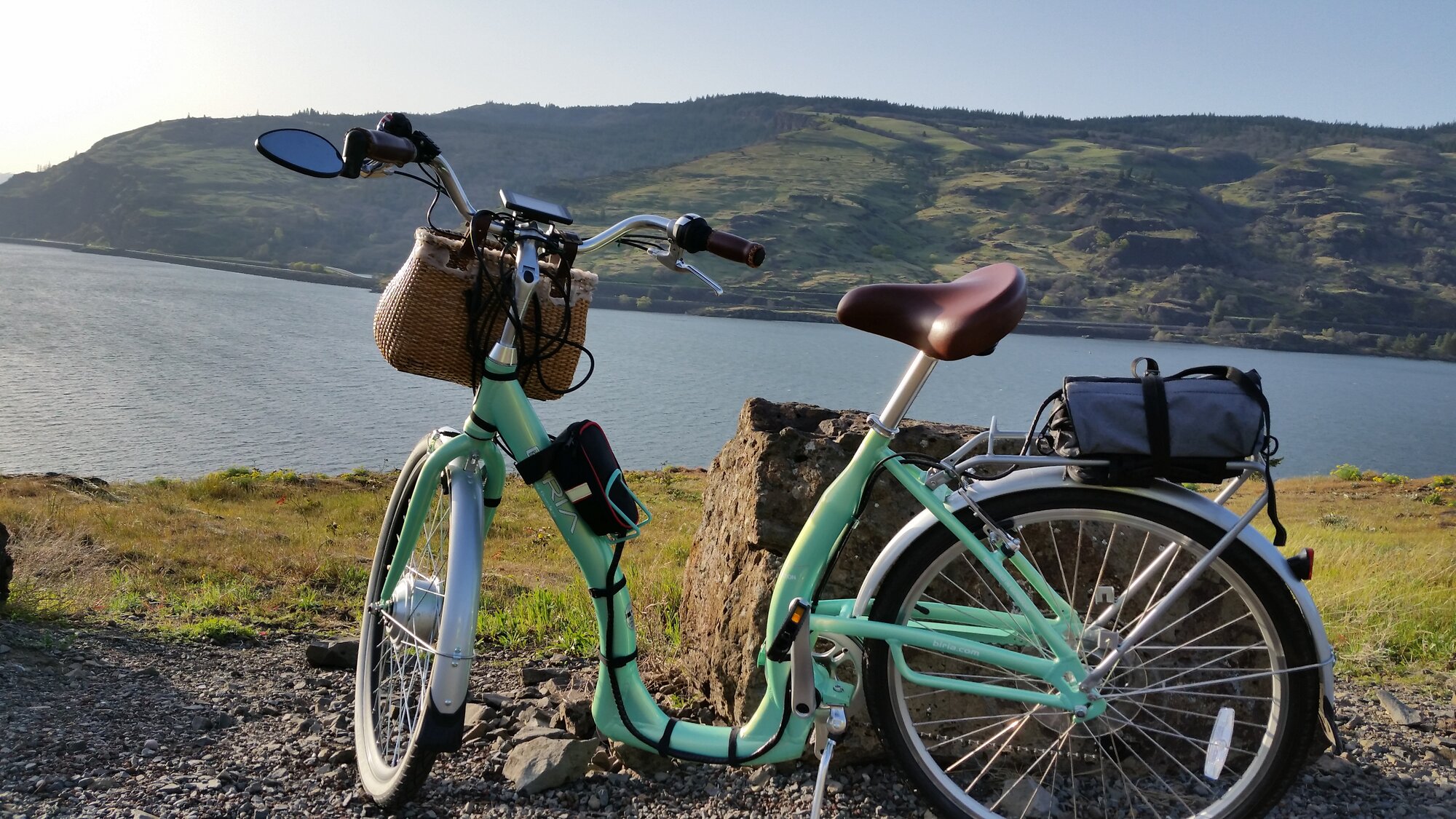

I put a generic front hub motor on my wife's bike, it provides excellent assist in hilly terrain, the motor has never been noticed to be hot even pulling long grades.
