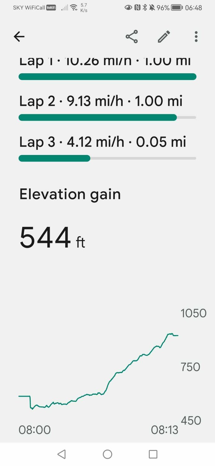

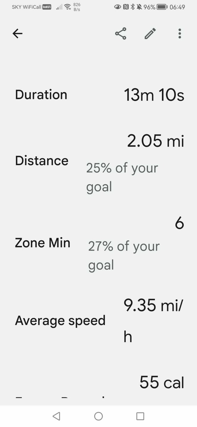

My first trip out on it was Thursday / Friday, the trip to work was nice and stable, I didn't turn the motor on and the bike felt nice and easy to pedal on the few flat non down hill parts. While the brakes are at the bottom end of quality as per the review that Catalyzt found, they are the best brakes I've ever had on a bike, there must be something in this hydraulic setup combined with discs, I bet it catches on 🤣.
On the way home Friday morning I the motor had the motor turned on from the start and you could feel the motor helping, the bike felt OK on the flatter parts, with it set to minimal assistance. Once I got to the second part I didn't mess about, I just turned it up to max setting.
There are 3 different gradients on the way home, starts off slight, then gets a bit worse, finishing with the nasty part.
First 1.5 miles were very easy, I had the gearing set up on the smallest gear all the way. Then I hit the hill properly for the last half a mile, while the motor was helping I still had to nock it down 2 gears in order to get the full benefit. It was by no means easy and left me "out of puff" at the top of the hill, but at no point did I think I'd have to get off and push!
Time wise the last half a mile took me the same amount of time as the first mile and a half.
13 minutes 10 seconds in total. When I take the car I average 9 minutes on the trip back home, so as far as time goes I'm rather pleased with that, my average speed home was 9 mph, again I can live with that for the first time out on a bike in years.
I've added a couple of pics of the info from my Fitbit, it handily split the average speeds between the slight, harder and OMG sections of the hill and the elevation from start to finish. While the graph shows the time it all took.
