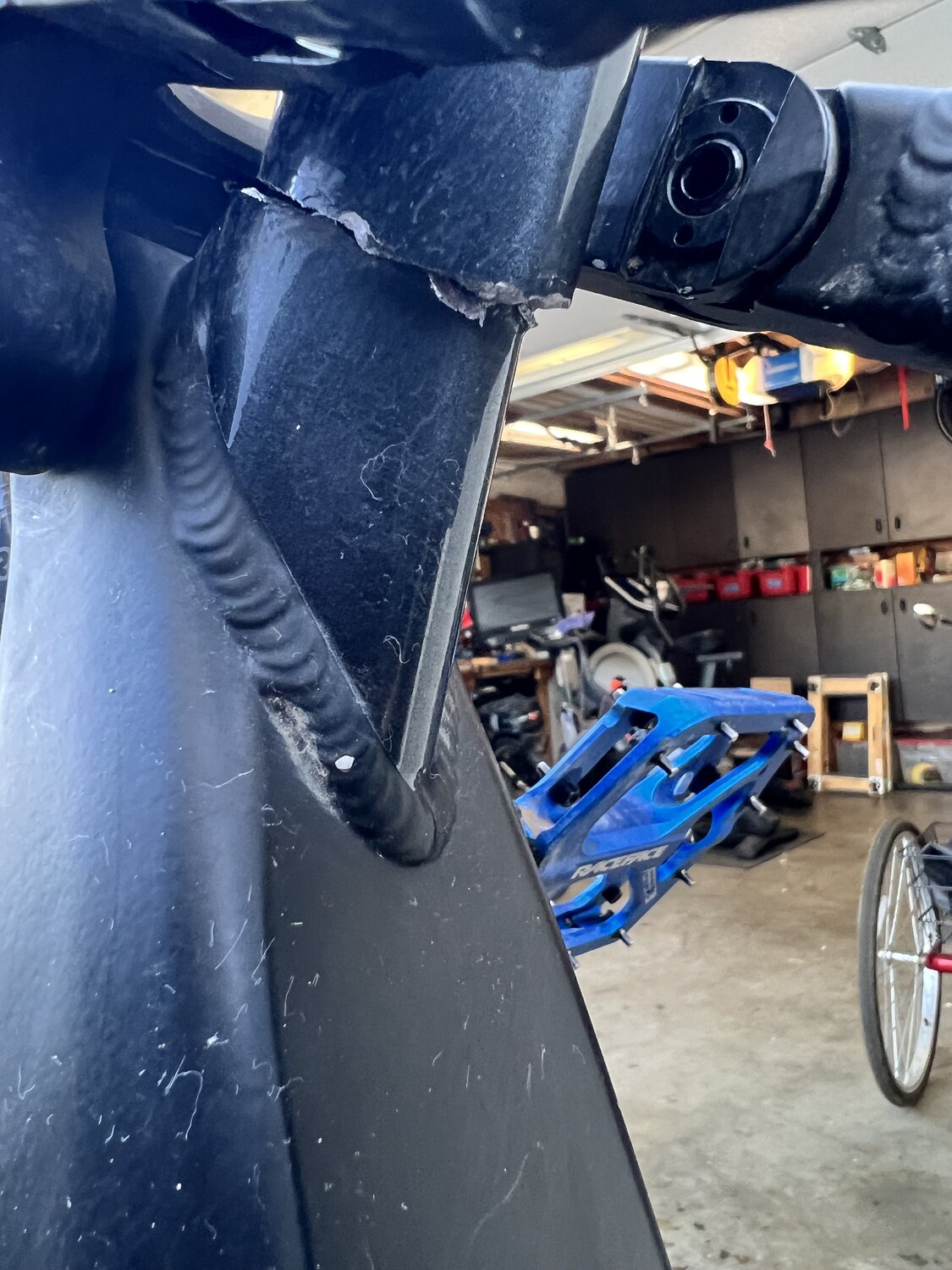

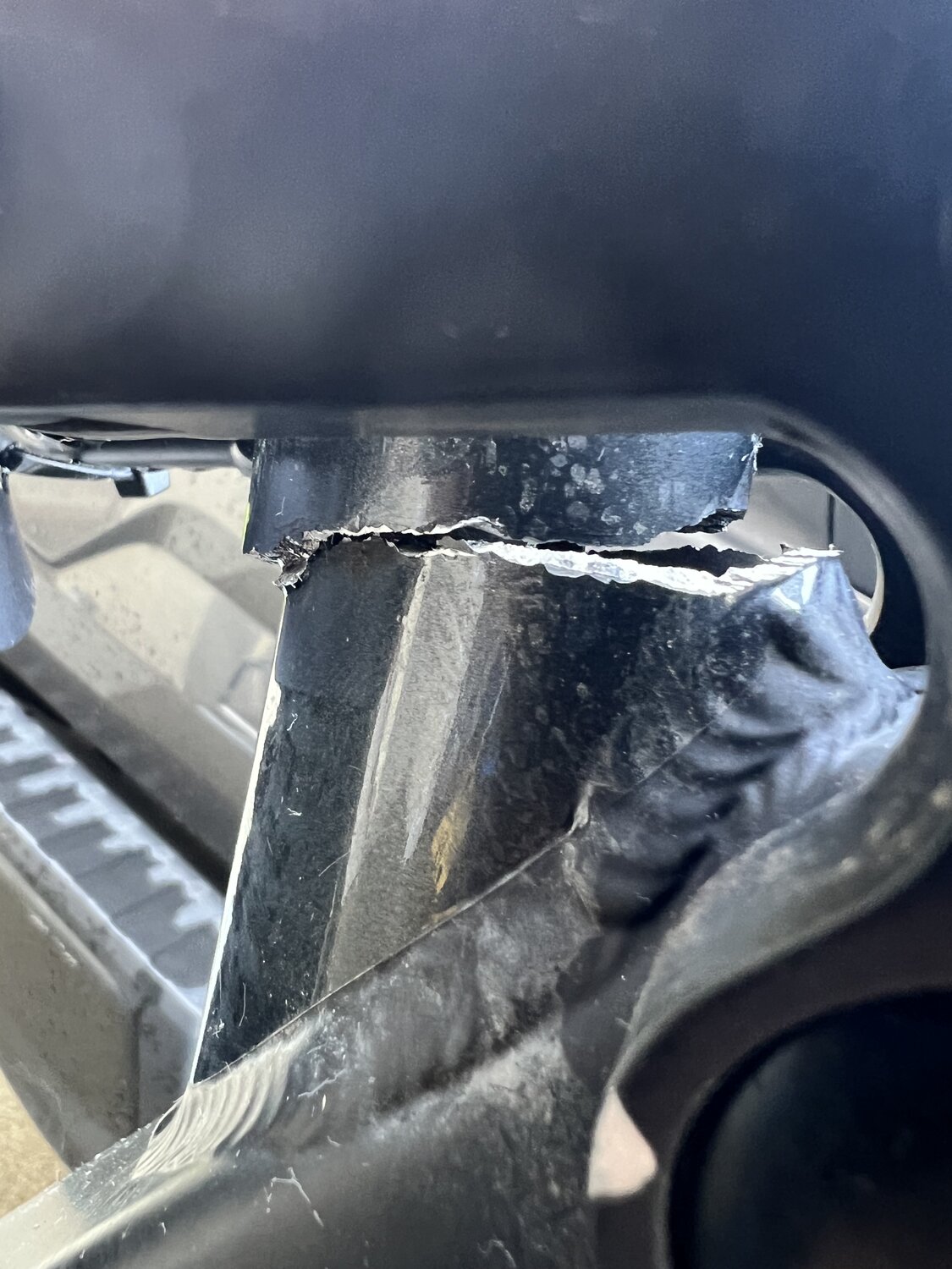

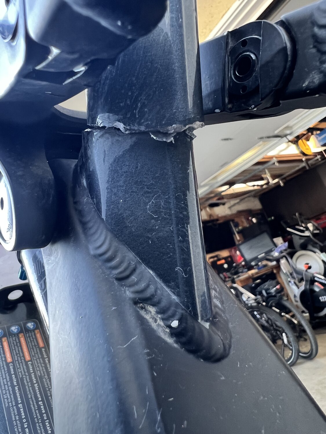

I am older and ride 90% on the street and about 10% on easy dirt, mostly fire roads. I was just returning home, having literally just turned 3,500 miles on the ODO when I heard a snapping sound and felt a grind as I pulled into my driveway. The frame snaped in two at the base of the seat post where it joins the pivot point of the rear swing arm. I have never ridden the bike hard, never went off a jump and never had a bad crash.
I have alerted the dealer and provided them with lots of detailed images of the bike and the spot where the tube broke. The dealer has told me that he has presented the problem to Bulls USA and that they had in turn passed the info off to Bulls in Germany as it seems as if warranty issues are handled overseas. I have several biking trips fast approaching and have requested that they expedite the solution to this problem. The bike retail dealer informed me that it would likely be a number of days before they reply with a resolution.

Base of the seat post? Insert pictures in your post of said snap frame.

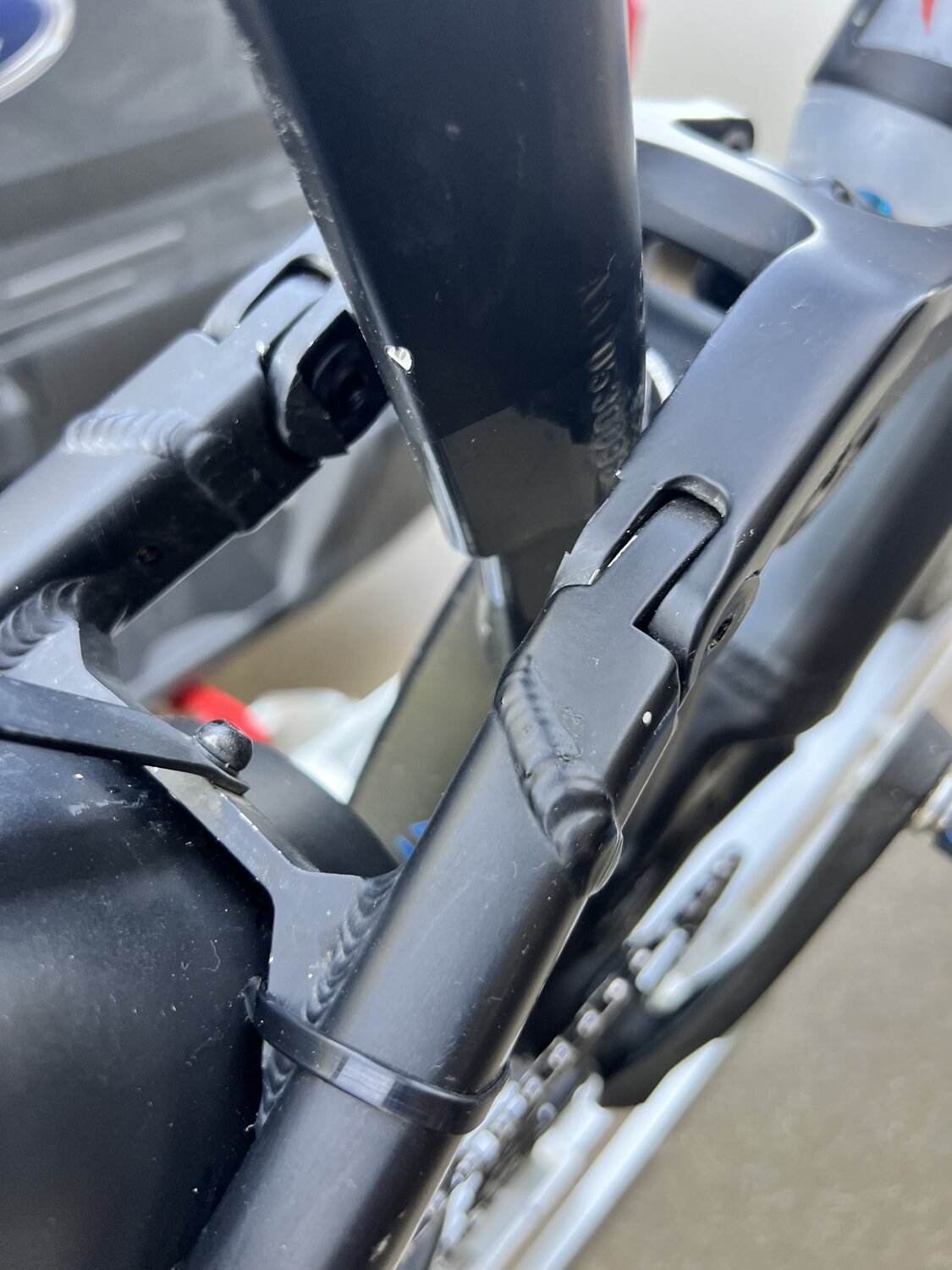

I own a Bulls Evo 45 AM. Frame is made in Vietnam.

Paid roughly $5,600.00 the bike 15 months ago. Can get a new one, same year and model now for $4,700.00. The latest updated model, the one I just bought for my wife, the TR2 Speed is about $6,400.00. An interesting detail is that in the same location on her new bike Bulls had added two welded parallel brackets right at the location that my frame broke. Seems as if they may have made thia change due to other reported failures.

I have the exact same frame crack on my Bulls Iconic EVO TR1 Speed bike, and presently awaiting the resolution
which I'm told by Bulls is a replacement frame. Your pictures of the crack could have been mine they are so exactly same. They quote a 2-3 month frame build process for a replacement warranty frame. Then I assume I have to move all the parts from the old bike to the new frame - not a very confidence inspiring solution. Sounds like this is a common issue - I hope they have taken action to improve the strength of the new frame. Very disappointing for a $5600 bike.

FINAL RESOLUTION/Update on Cracked Frame - After waiting 5 months for Bulls resolution of the cracked Iconic EVO TR1 Speed frame, I believe that BULLS finally did the right thing, which is to completely replace the bike with a brand new EVO TR2 Speed bike. Let me say the bottom line is that the TR2 Speed bike completely improved on all the weaknesses of the TR1 Speed:
1) Redesigned the swingarm, so that a 40T front chainring now fits and is provided vs the old 38T which ran out of gas at top speed.
2) The seat tube location that eventually cracks as mentioned in my post and pictured in another post above, is redesigned and appears much stonger to eliminate the frame cracking problem.
3) The luggage rack now is flat on top, and also has a clamshell spring to hold down your luggage.
I always thought my BULLS TR1 Speed was close to perfect, until it cracked... it was simply not a robustly designed and executed frame build. However, now with the TR2 Speed, Bulls has executed a perfect bike. The only flaw is the wait time to rix the problem, so if Bulls takes their customer service up a notch and speeds up their resolutions and proactivity to solve problems for the customer, that's all that is remaining.

See my post below - same problem here, now resolved. I'm curious what do you think caused
the TR1 Speed frame to crack? My sense is its a side load issue, meaning for example, when you go to mount or dismount
this TR1 Speed bike, you are on your left pedal only, swinging your leg over the bike. During that time, you are side loading all of your weight on one foot, and this side motion simply snaps it right off because the frame (which is now redesigned on the TR2 Speed bike), simply does not have the strength or geometry at that location to counteract that normal use of the bike.
