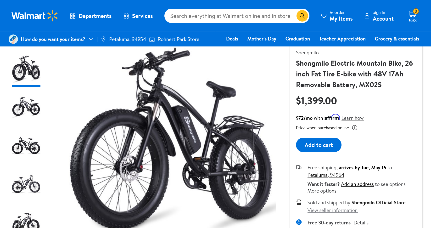

" It can adapt to a variety of riding sections, including urban roads, off-road mountain roads, jungle trails, beaches, and snow."
Would anyone want this on a mountain trail?

And sure a name brand Hydraulic brake would be great... But on a $1400 bike I don’t think so as it hasn't happened yet.

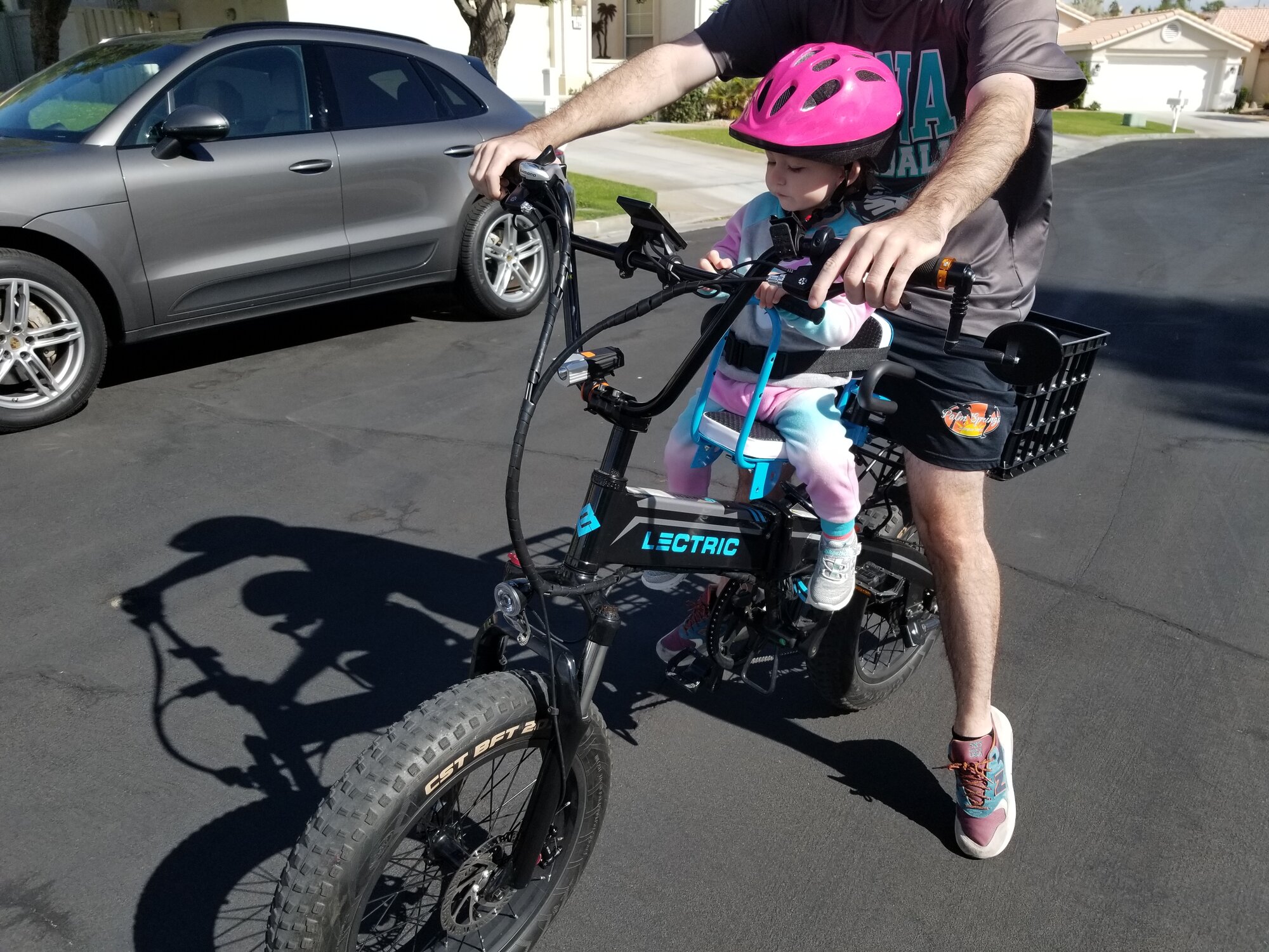

I cant believe Walmart is getting 1400 bucks for that bike. My goodness. My 899 I paid Lectric years ago is looking like a steal!
