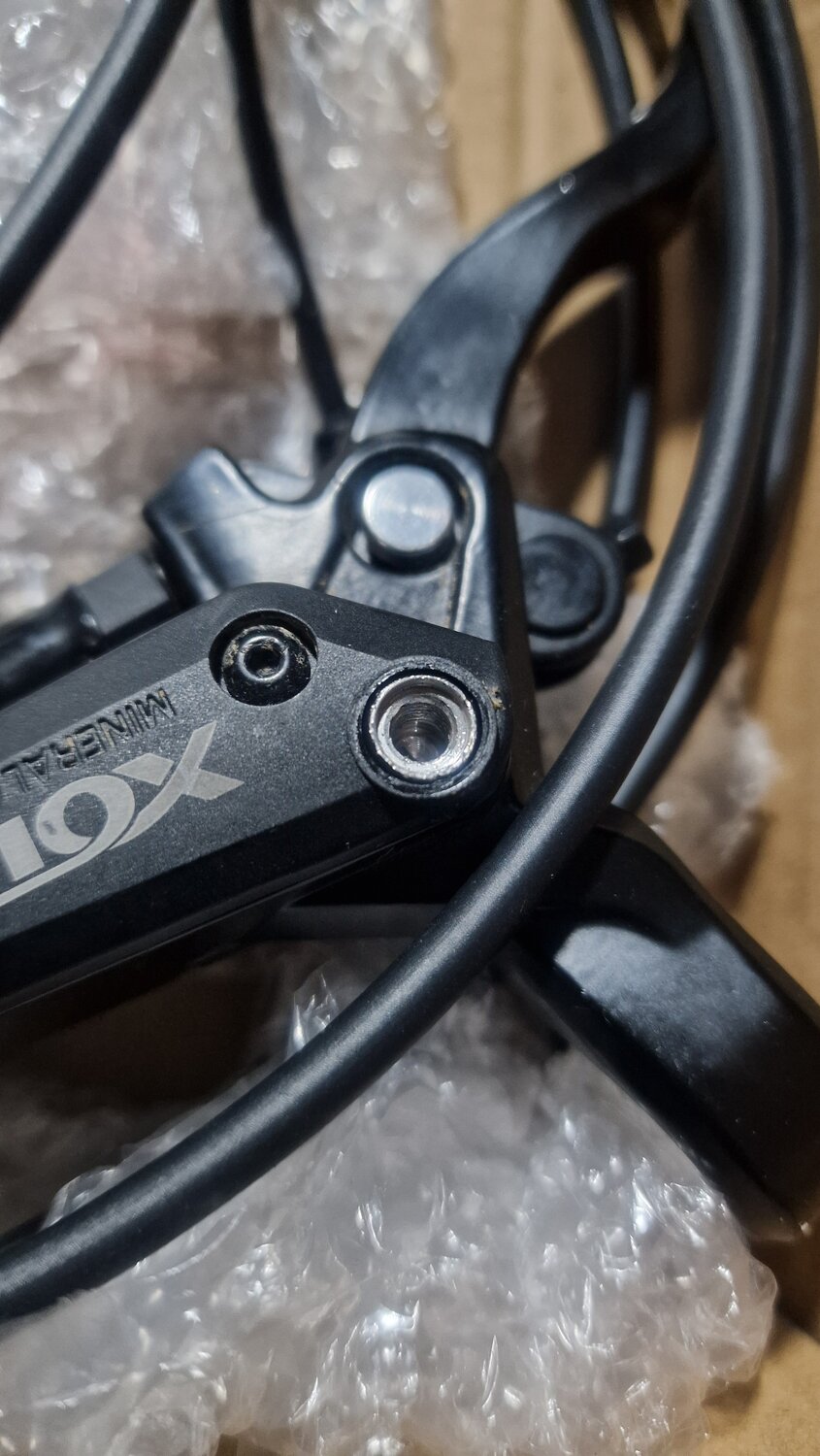

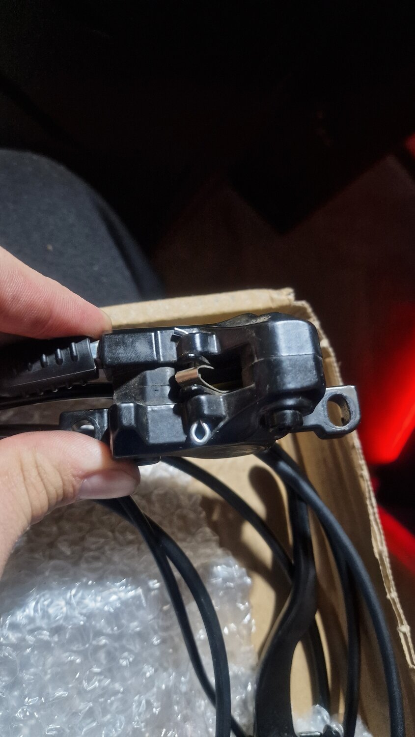

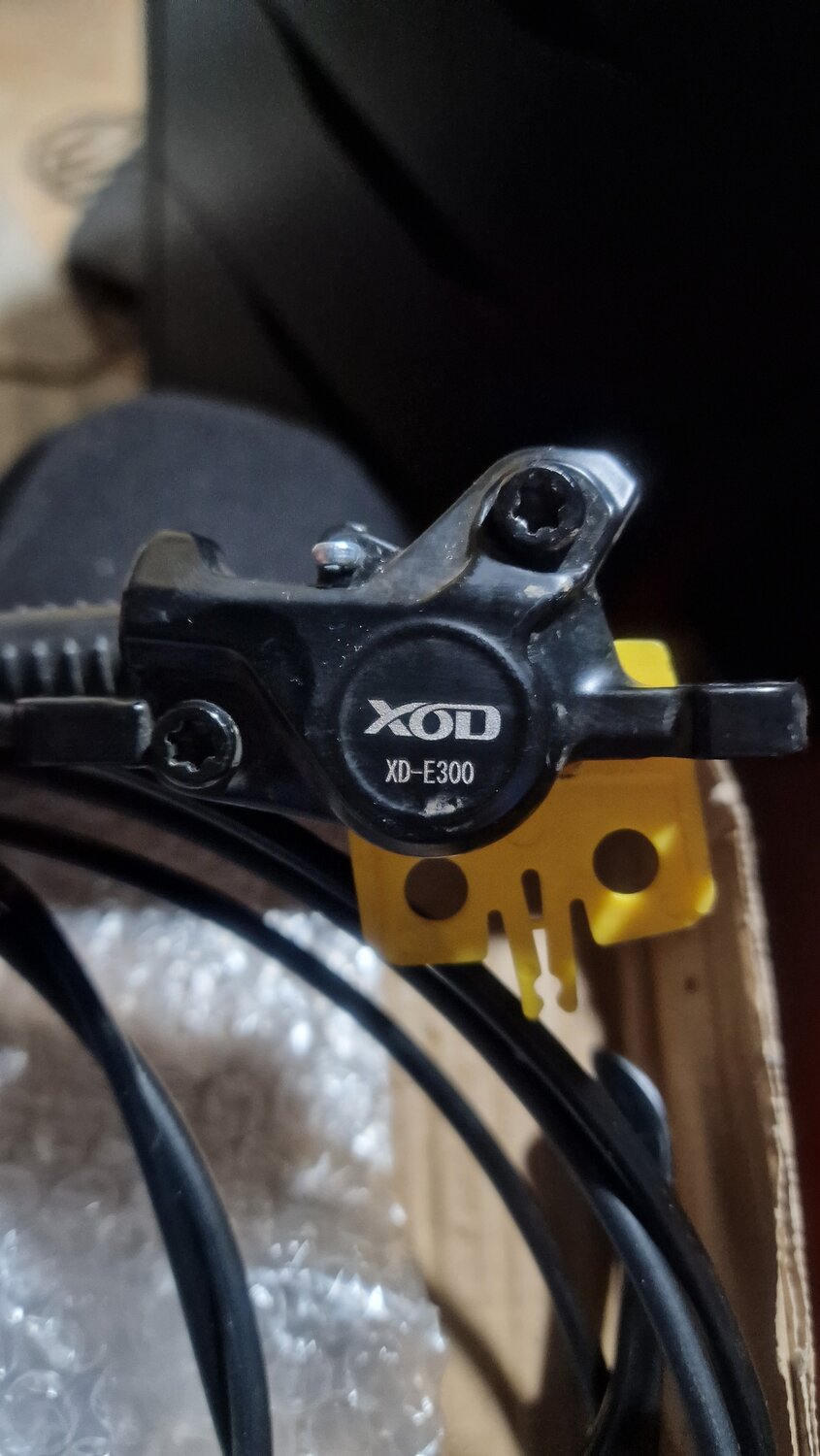

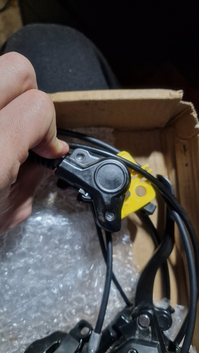

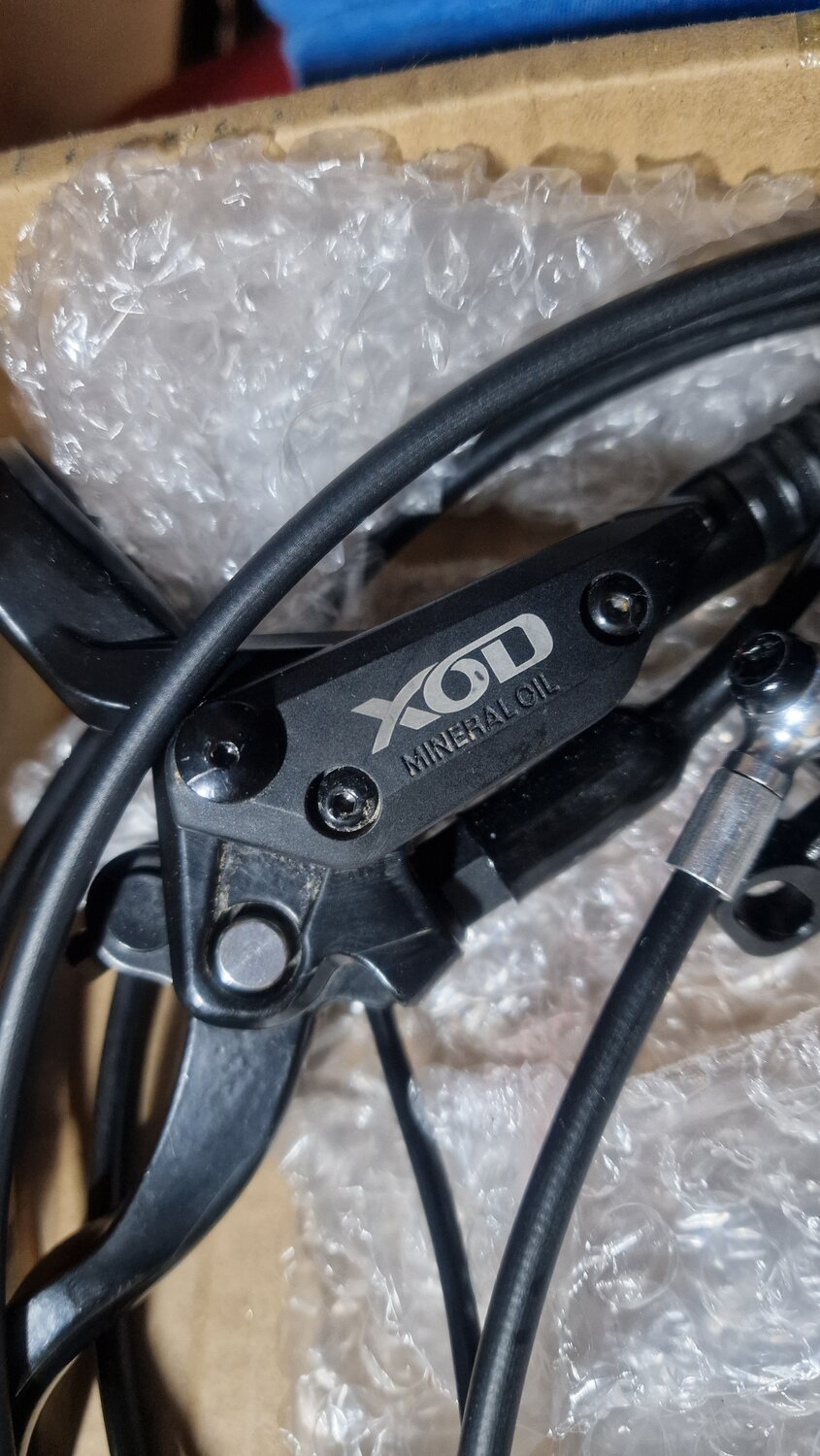

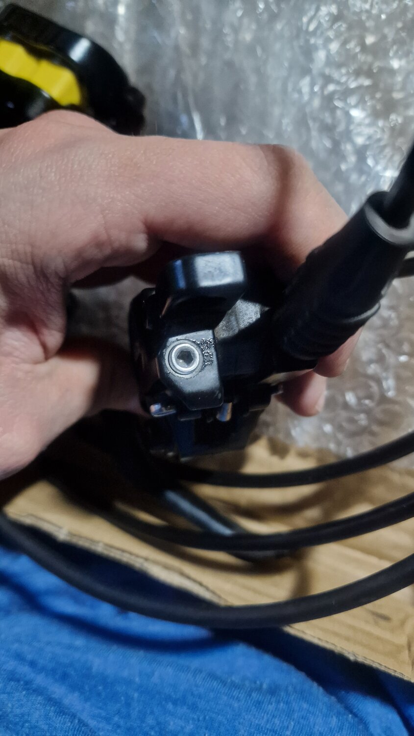

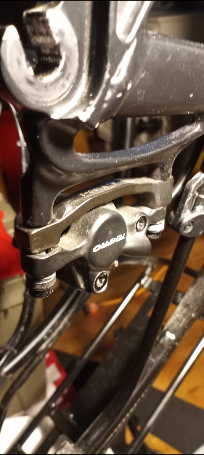

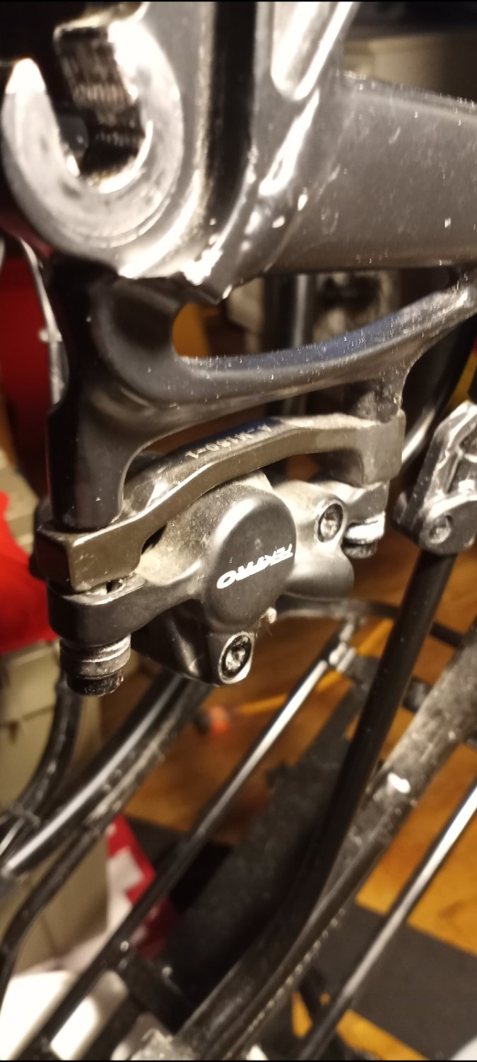

Hi, do anyone know if is possible to bleed this brakes? I don't see any bleeding ports. It's Xod XD E-300 brakes.
I neeeded to take off hose from lever and now when I put it back it is sponge and don't brake at all. I don't see any bleeding port on lever or caliper. Can I do something with it? Is it possible somehow bleed it or it is trash now?

Yes you were right, that was it. I wasn't sure because it has very small thread head.
Also I'm blind...I found port on caliper as well.
Thank you very much.

I couldn't find mine, but I was able to locate it after seeing the OP's picture. It may be hidden by the screw that holds the brake to the frame.
