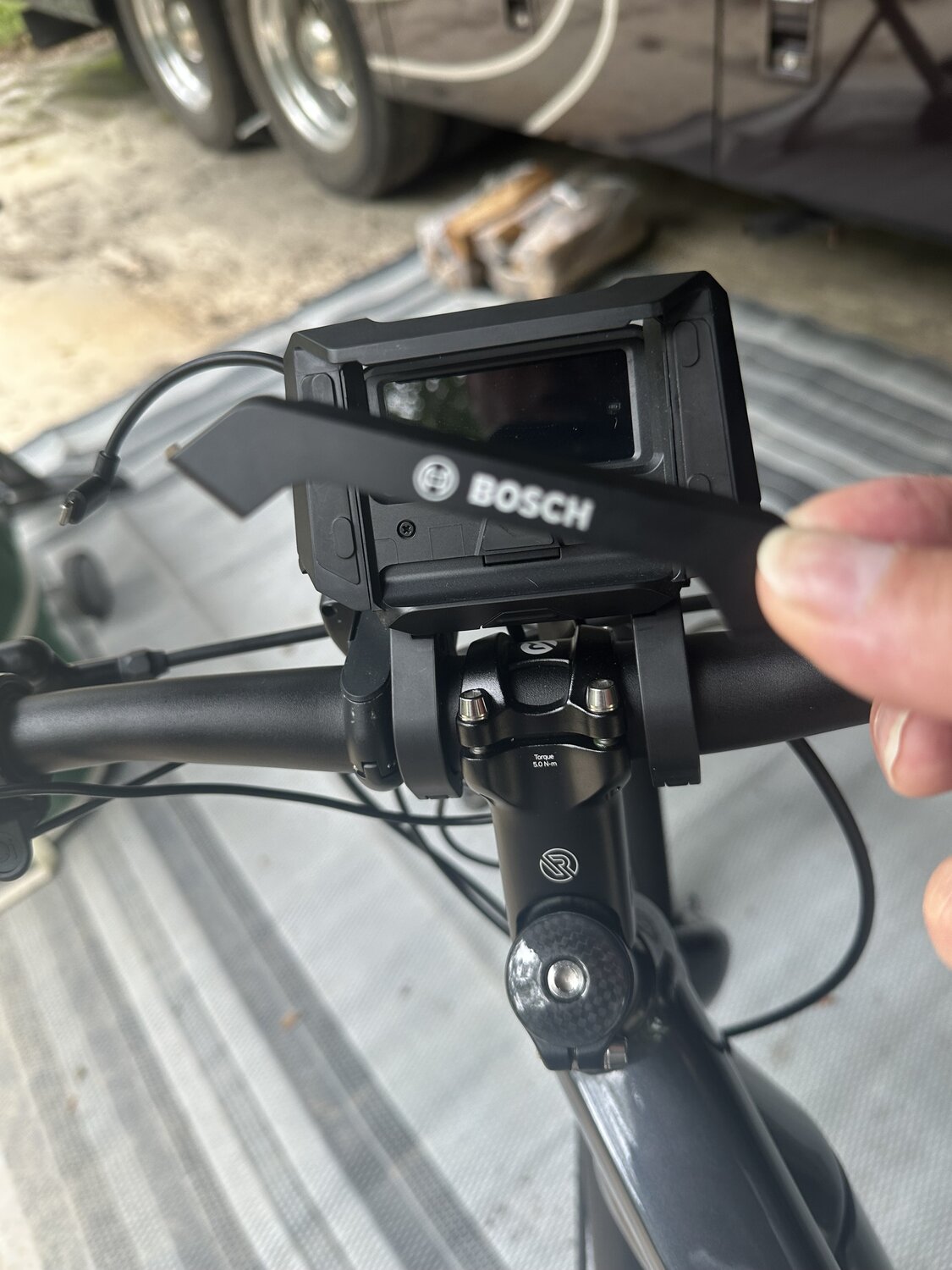

Since I bought my Trek Allant+ 8S, I have been reading about how fragile the phone holder is. Because of that I have been VERY careful and gentle putting my phone in and out of the holder. Well after a few weeks and about 300 miles, it completely broke apart. What an embarrassingly defective design this is! It is shocking that it even lasts a single use. I’m on vacation so I can’t go to the dealer. I ordered a new one on line for $30 but I have zero hope of it lasting for the rest of my vacation.
Contrary to other reports, I find everything else (the app and its integration with Apple’s fitness app, etc) about the Smartphone hub system to be excellent. I am now in search of an alternate mounting method for my phone, which will ever look as clean as the original. :(

you can have mine it was remvoed from the bike before I got it home just postage.
Smartphone Hub is for the Active family of drive units and battery, Smartphone Grip is for the Smartsystem family. Not cross compatible.
As previously mentioned you can trade out the Hub for a Kiox or Nyon and still charge your device and use the app.
R&M is the only brand we sell that equips the Hub as an option, I've only had one mount break (covered under warranty) but we don't sell too many of them compared to Nyon or Kiox options.

Thanks, I ’think’ I got it now after google surfing for an hour. :) Looks like a Nyon upgrade is in my future. This SmartphoneHub physical design is a loser,
Just trying this out in the Trek store I almost broke it. The piece came completely out. This was last week so it may have been the new one.

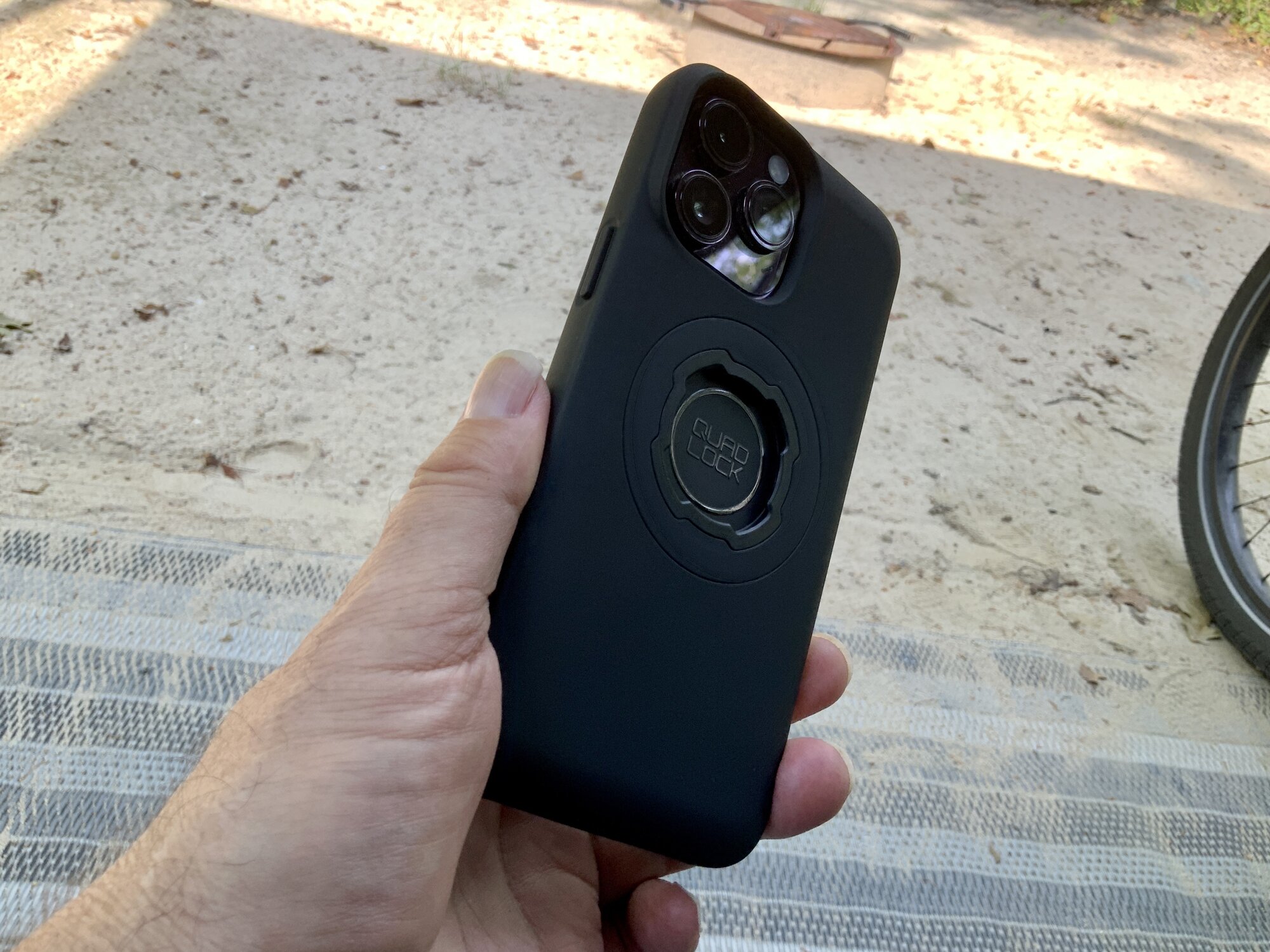

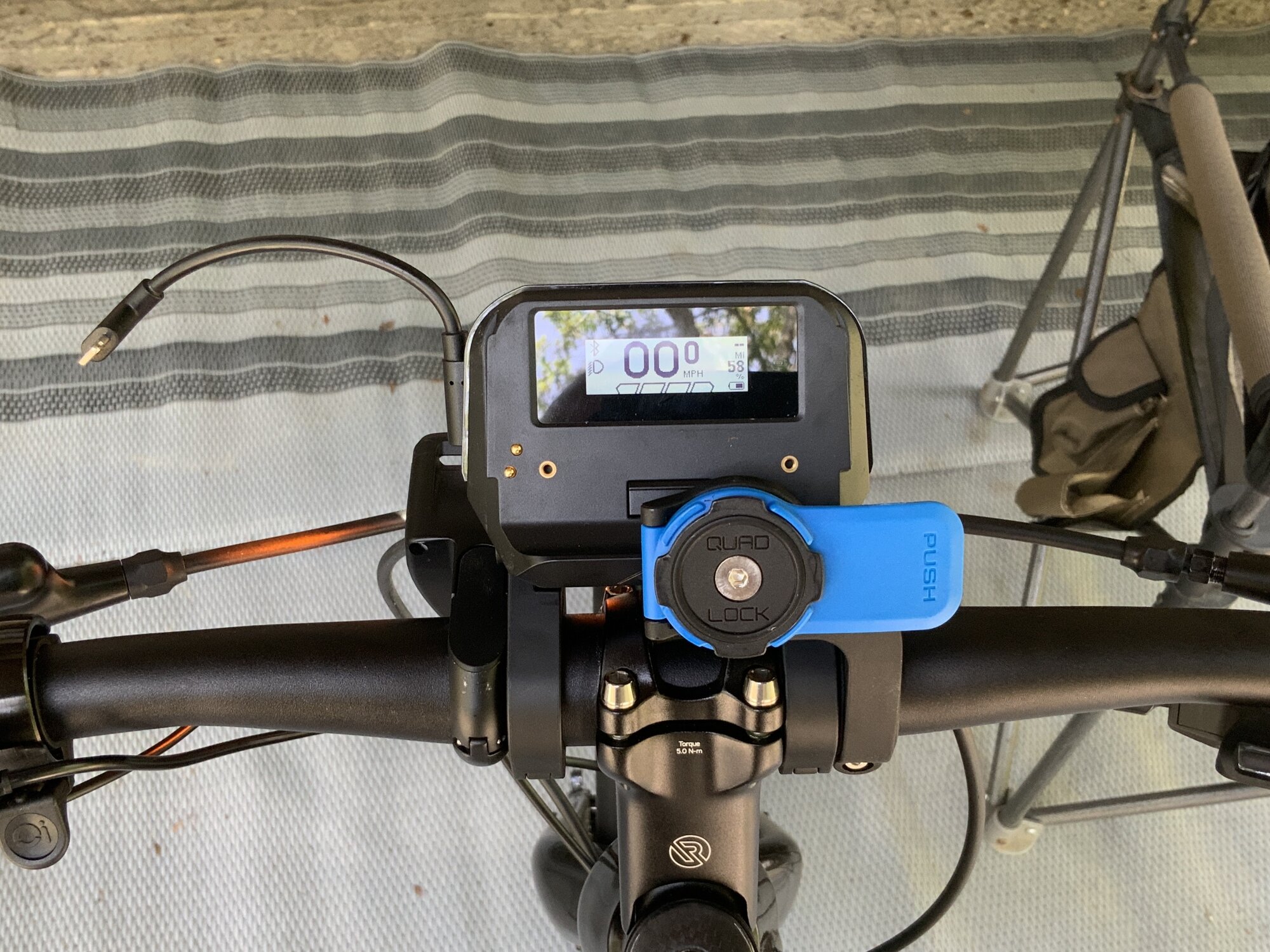

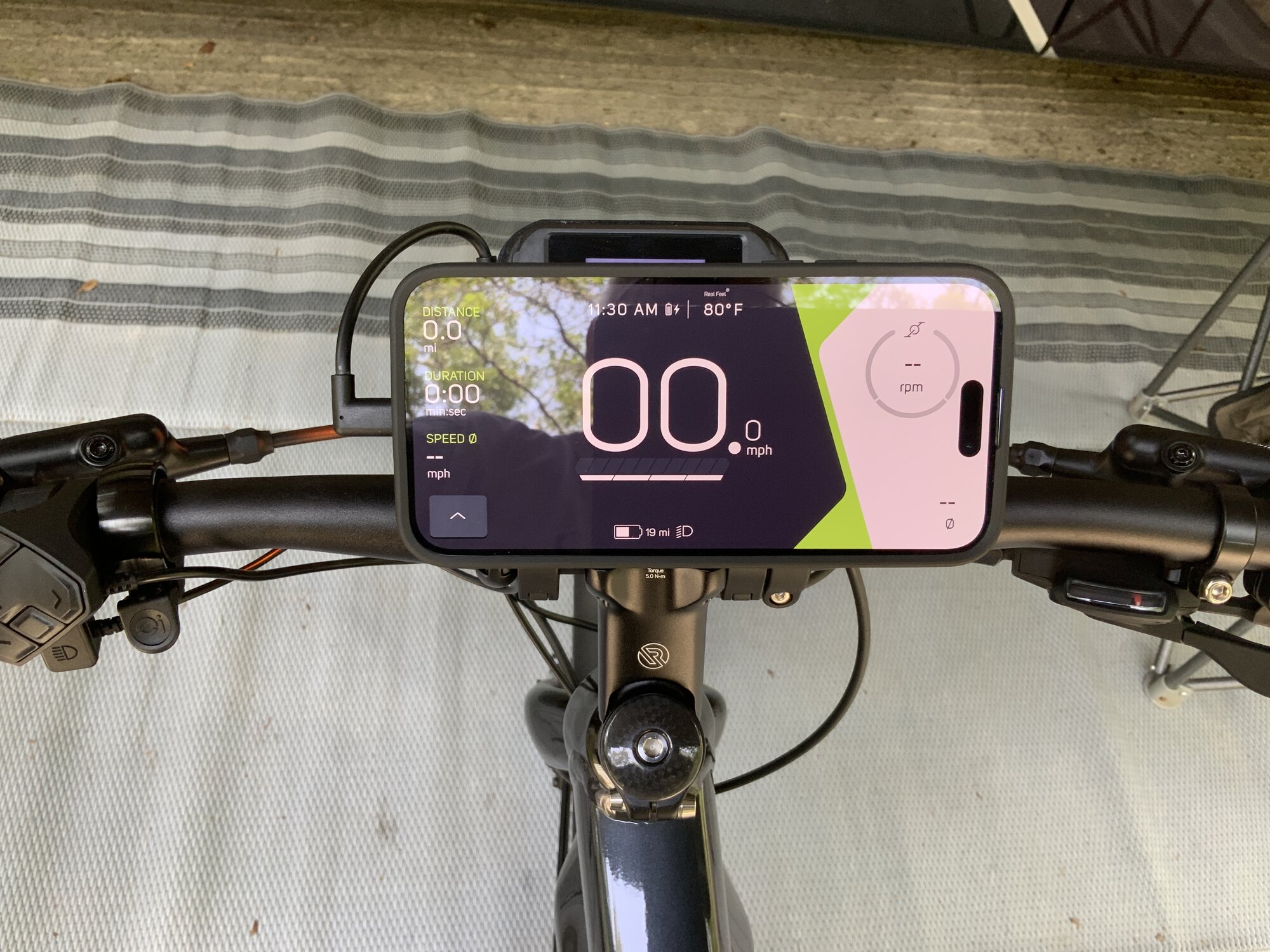

I went with the QuadLock w/dedicated iPhone 14Max case. Removed the cheesy Bosch mount. Works out great. You can still jump on the bike with just the built in display, or simply twist on the iPhone and use the app. The hardest part was getting everything squeezed on the the 31.6mm section of the bars.

That’s a very neat solution.
