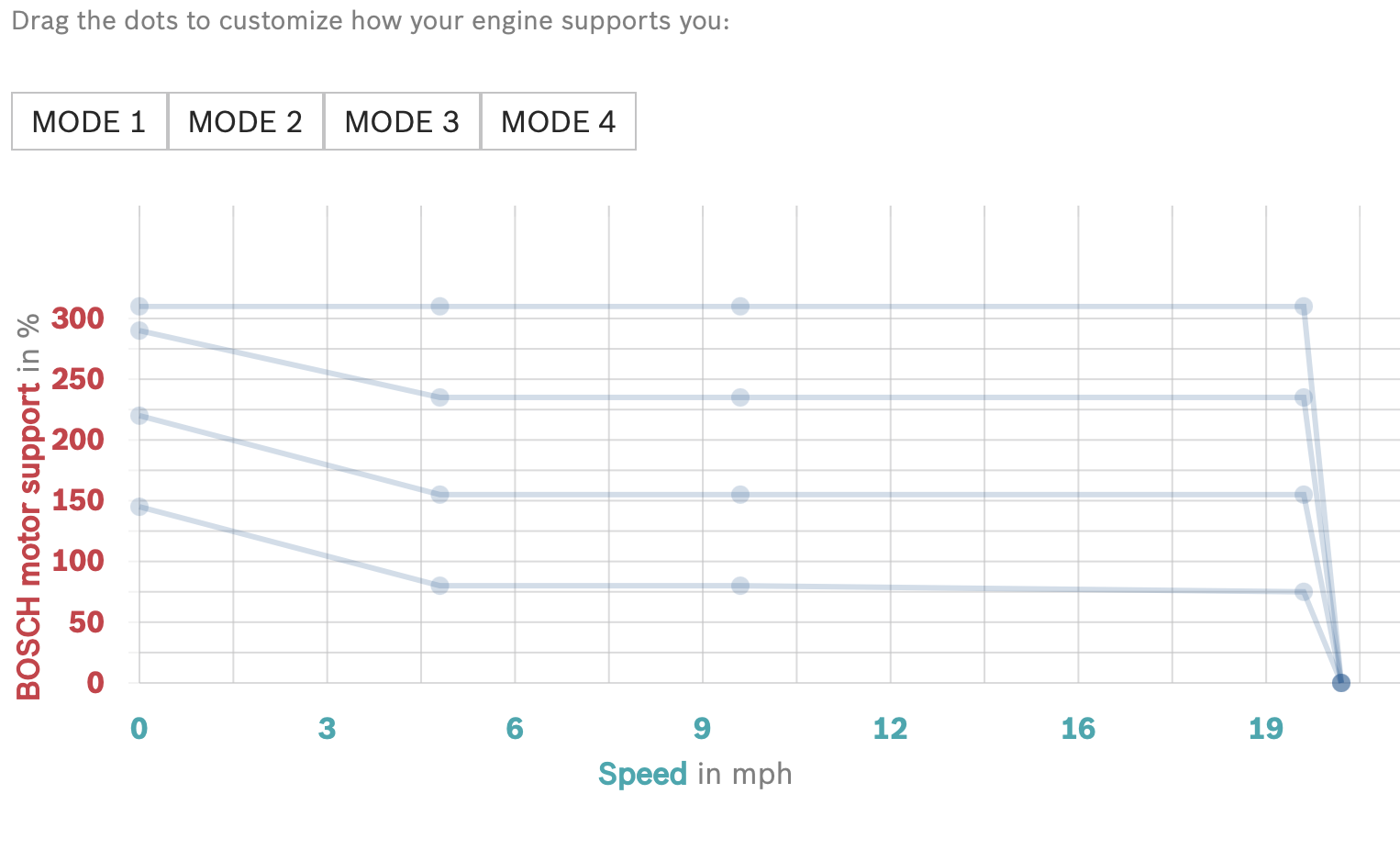

some shops will adjust it some wont. yes its been that way a long time thats why its a bosch thing not a bike brand thing. but some shops will adjust it. there is not a huge amount of range you to work with. Or get any of the other systems and you can adjust it yourself.

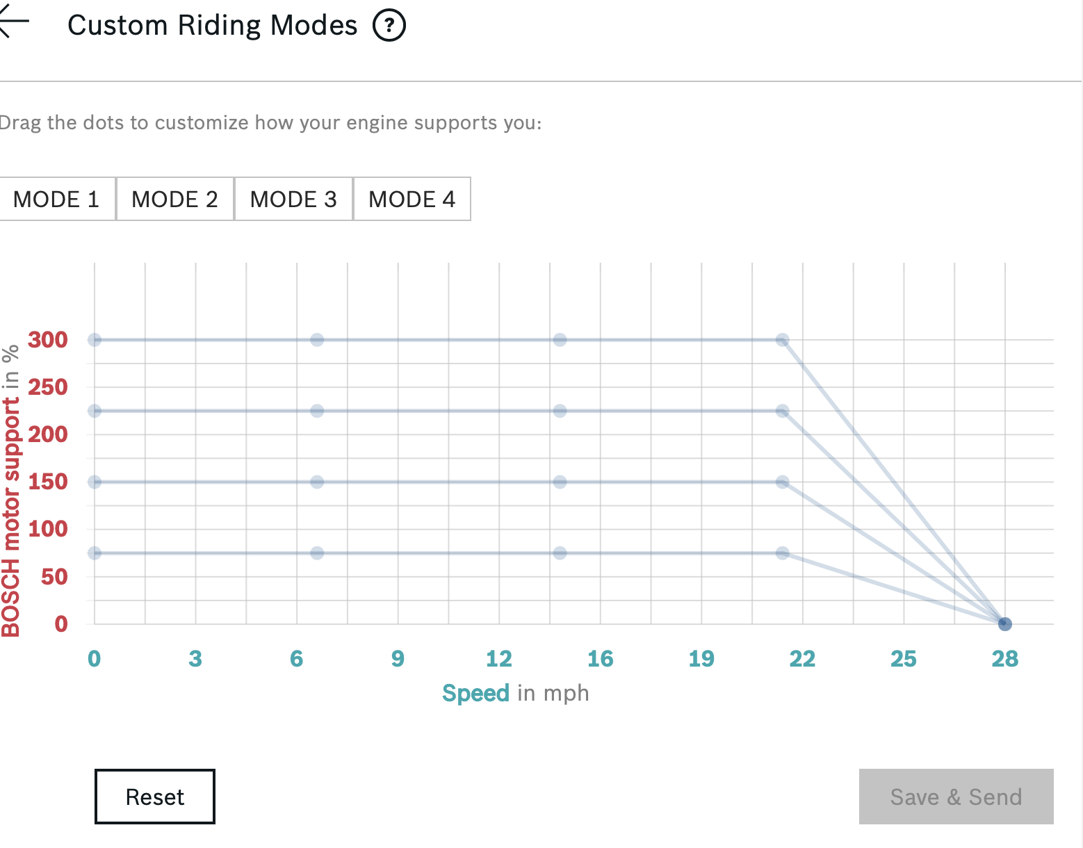

here you can see the curve. the second one is steep because I adjusted it as we ride around 18.7 to 19mph on the flats. but the default and what the prion uses are like the top. the power levels are not default either.
