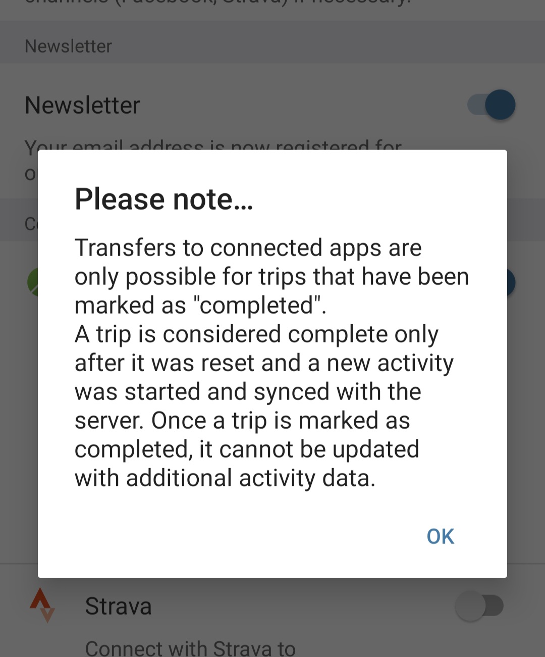

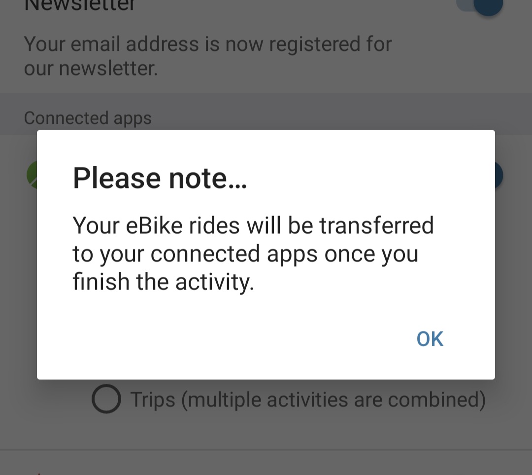

What is the difference between a "trip" and a "ride"? How do you "complete a trip"?

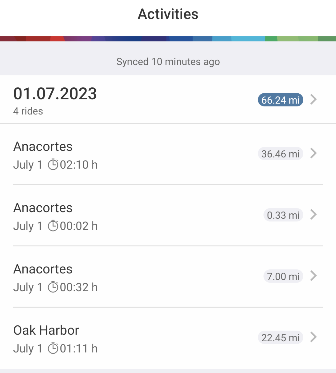

So the last trip I posted riding around Whidbey Island consisted of 4 'rides' because there were 3 times when my bike was stopped for more than 10 minutes but less than 4 hours.
If I had my Nyon set to sync after every ride that would have shown up as 4 activities in Strava.
It works reasonably well. I prefer the automatic and near instant syncing of 'rides', but usually leave it set to sync 'trips' to avoid the above scenario.
