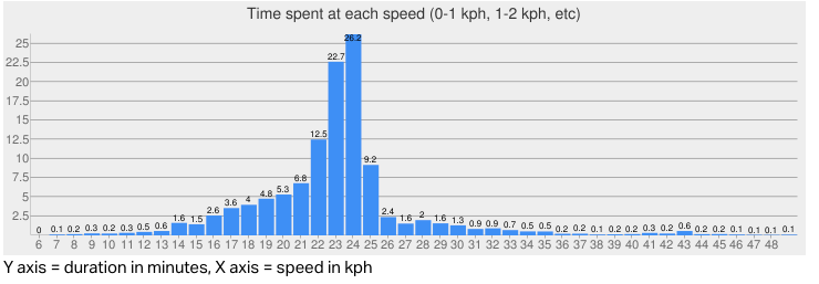

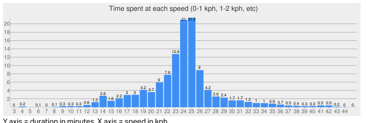

This is interesting and what you write about "being encouraged to ride faster than 25" is one of the reasons I am still so interested in the BMC.
Your statistics on the other side do show a shift of 1 kph to the right side with the BMC, also with the B;C you seem to ride mainly in the range where one gets support from the motor. I testrode a BMC for a short trip, it felt very responsive and nice acceleration.

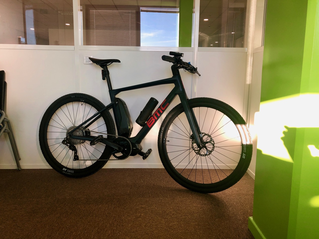

A picture of the bike in my office, after morning commute :
@octanou what a great and lovely story :-D I'm happy to hear you like your bike and that my input about the bike was helpful. I still like my one very much; its just the perfect bike for my use case, which is similar to yours. I wish you many more kilometers with your bike. Safe ride!
