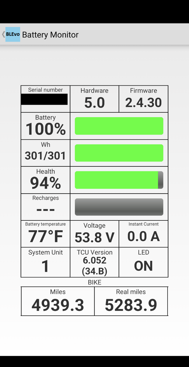

In any event, something finally clicked (and, yes, Mission Control was NOT loaded even before this)
Sniff, my Battery Health has slipped. It may be worse than my own health 🤪
So, thanks, Horse, for sticking with me!

What is the difference between 'miles' and 'real miles'??
Kahn should have a look at the Bike Setup page and make sure the Wheel Circumference is set properly there. If the value of WhC is set to be as it is in the e-bike, the Miles and Real Miles should be the same number.
BLEvo can work in conjunction with Velociraptor, a speed derestriction device. Velociraptor cheats the e-bike as to the actual cruising speed (and the distance ridden). To make the speed and distance reported be true in BLEvo, there are settings for that. The Miles is the distance e-bike believes it was ridden for. Real Miles is the corrected value. To give the short answer: Just set the WhC in BLEvo correctly and the two numbers will match.
@kahn: if you waited more, the number of recharges would pop up, too!
@Stefan Mikes
I recalled the Blevo had wheel circumference settings. I did look at the docs but they did not mention REAL kilo/miles on Real Wheel.... I had a feeling it had something to do with that.
Thanks for clarifying.
