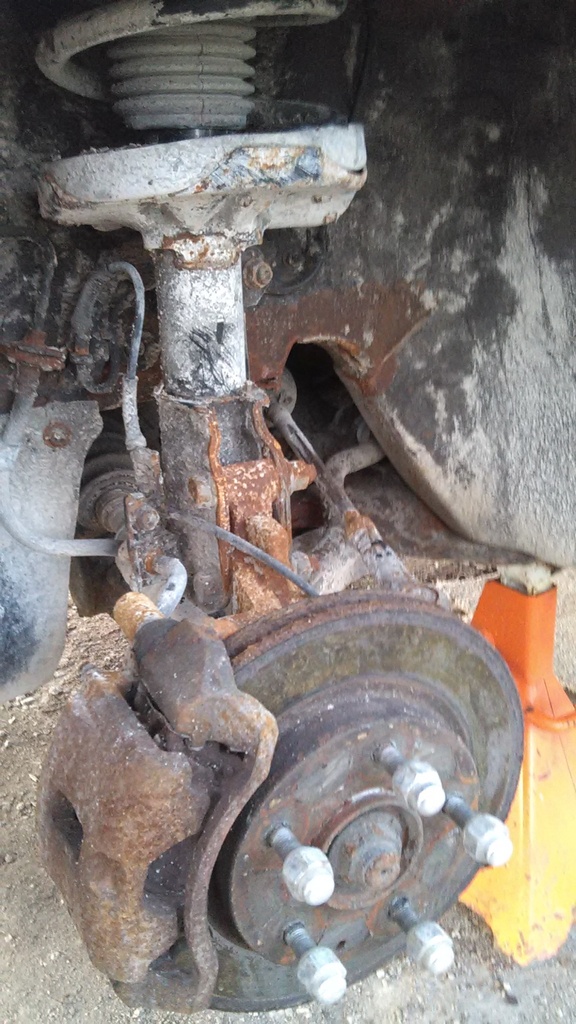

I've got HAL sensors all over my car and they just keep working regardless of salt and water.
They're just build better. Properly sealed anyway,..
When my wheel hub rusts out and falls off the car, it'll be the HAL sensor wire that keeps it connected to the rest of the car.
