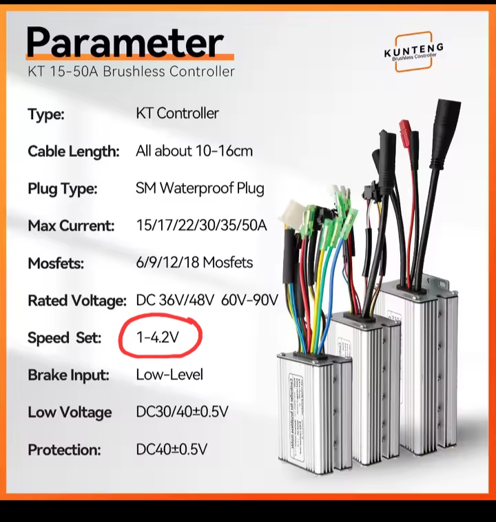

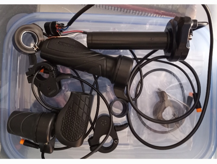

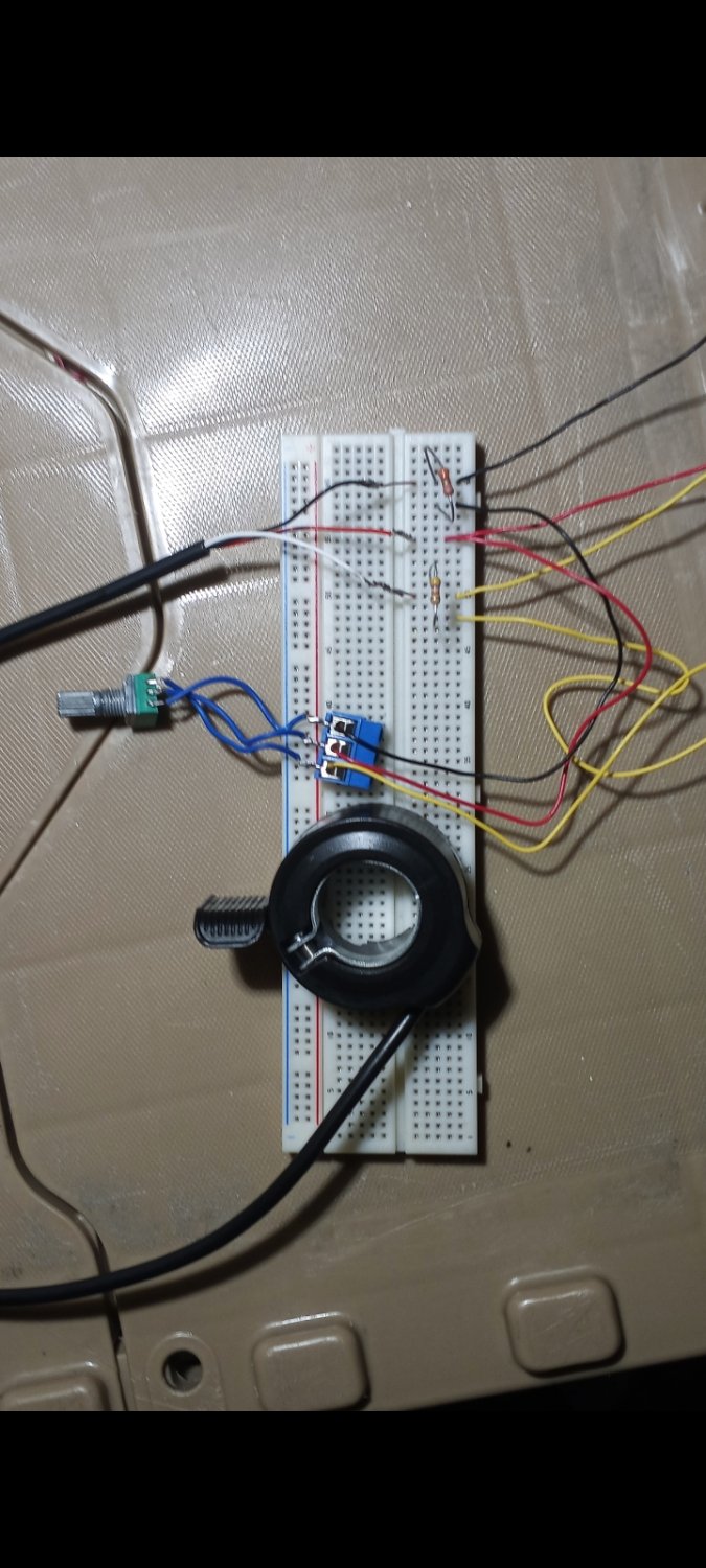

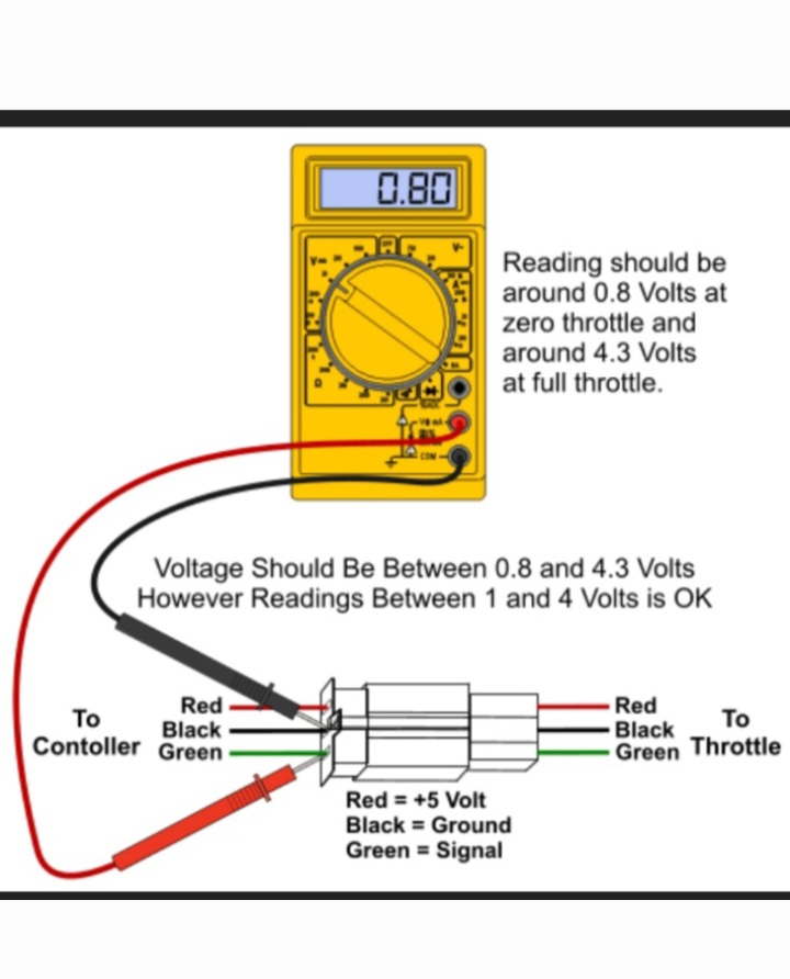

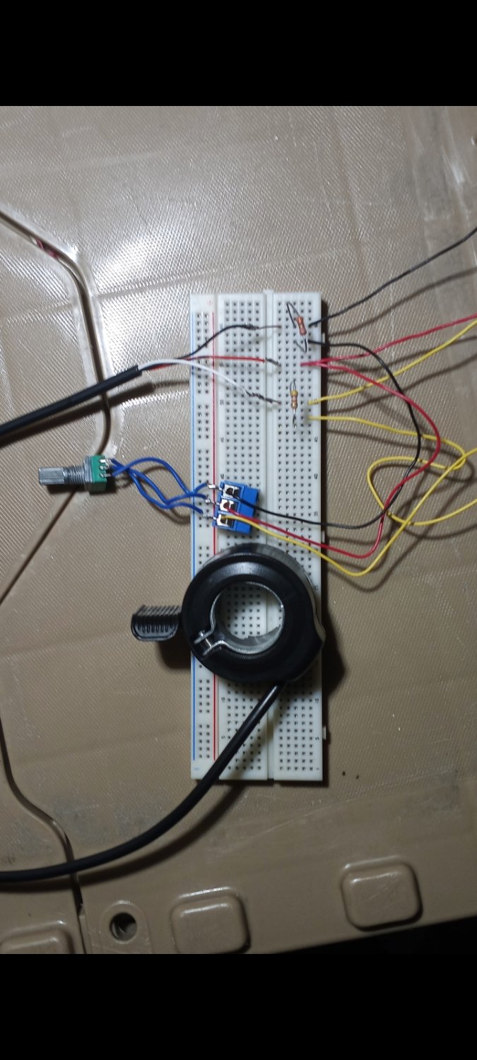

I did a bunch of research and testing on e-bike throttles and found that All my Hal sensor throttles behaved the same way, but a proper motor speed controller using the right resistors and potentiometer doesn't do it.
I followed @6zfshdb 's throttle schematics,..

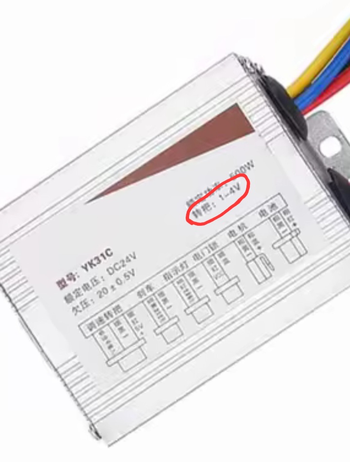

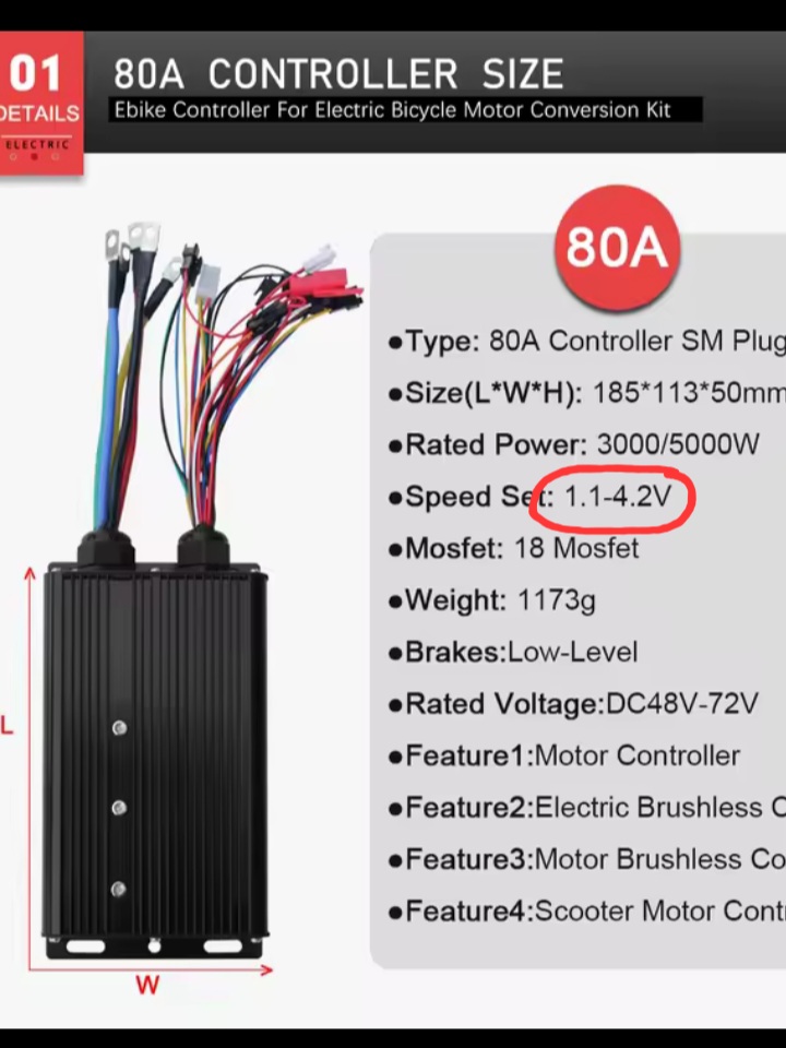

,.. and the basic throttle information and the "Speed Set" or "Throttle" parameters found on Every type of controller stating that throttle voltage ranges from ~1v to ~4v ,..
My first hub motor e-bike has a proprietary throttle with the connector plugs reversed.
It turned out that the voltage was also reversed, in that the throttle output is ~1V at full throttle and ~4V at zero throttle.
When the ground wire is disconnected on my Das-Kit throttle, the throttle goes to zero instead of full throttle.
And I found out that the reversed throttle is for a mid-drive motor and Das-Kit just adjusted their software to work with it.
It's a much safer design to go to zero throttle when the ground is disconnected.
With a proper Speed Controller, the voltage goes to 5V when the ground is disconnected, and that triggers a fault in the controller to shut off the power.
Or with a mid-drive throttle, the voltage goes to 0V which also triggers a fault in the controller
The voltage SHOULD go to zero or 5 volts when the ground is disconnected, not 1 volt or 4 volts.
The Entire built-in safety of a 1-4 volt throttle input is negated with a Hal sensor throttle.
And there's No Damn reason why they can't redesign the Hal sensor circuit so it goes to 5 volts with no ground.
The throttle is being fed 5 volts.
It should put out 5 volts with no ground.

Water could still affect the throttle and make it go, but if they used a mid-drive type throttle on a hub motor (like my hub drive Et.Cycle with a Das-Kit throttle), then the ebike would probably slow down when it got wet not power up ?

I've found that different controllers (and throttles) react differently to erroneous HAL signals. Most resistors aren't affected substantially by water, that's why you don't get the same behavior.
I'm not really sure why bike makers don't use variable resistance in throttles instead of the HAL effect. You get the same result but with a lower risk of failure. Cost maybe?
