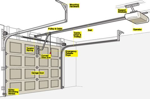

I've never owned a bike stand. Always hung my bikes from the garage door tracks using tie down straps. One hook in the track and wrap the other around the frame. Works great.

Interesting idea... ;)

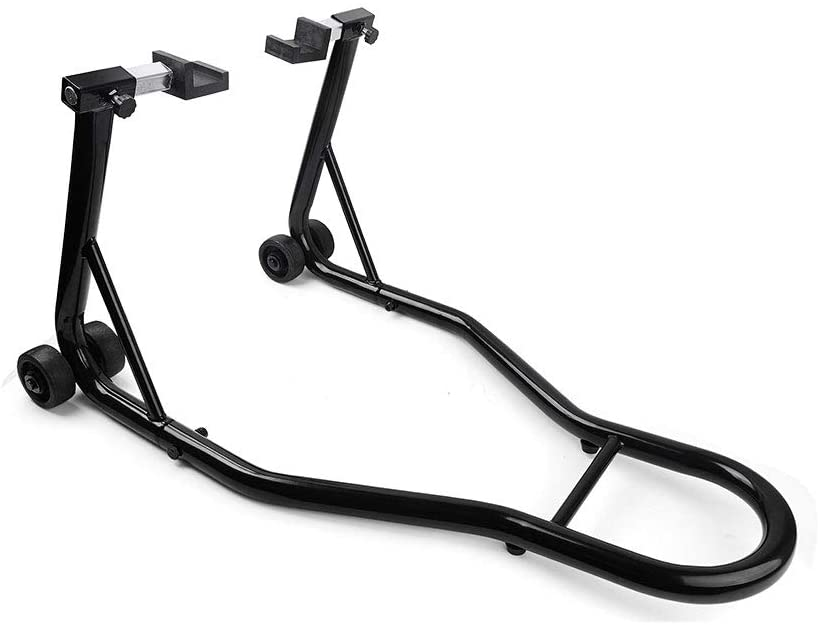

If you are worried about weight there are pretty hefty Heavy Duty Rear Wheel Motorcycle Stands that are adjustable and will be more than enough to support our ebikes with weight to spare.
I have the Handlebar Jacks for road/trailside repairs and just ordered the heavy-duty stand for my Yamaha mid-drive... if it's good enough for Motos, it's good enough for my EMTB. ;)
Oh yeah, another nice solid option. Like the mobility of this unit as well. Good call!
