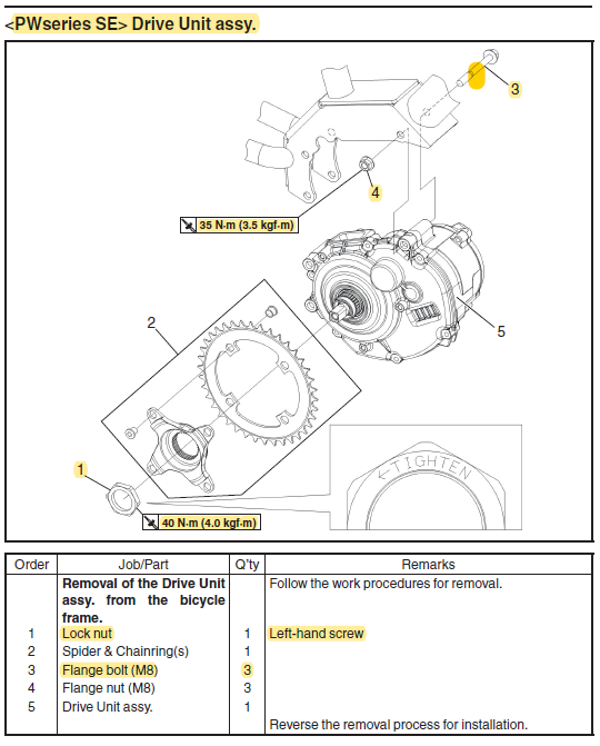

been there done it all. All the bolts have the torque spec on them.
Two of the three bolts also have lock washers and nylock nuts on them.
Two additional suggestions... hope this helps ;)
  • Torque the crank arm bolts and chainring bolts.
  • Remove plastic motor covers and Loctite the bolts.

My motor mount bolts keep coming loose and making a terrible noise in the bottom bracket.
I've tried everything and I have to tighten them about every other ride.

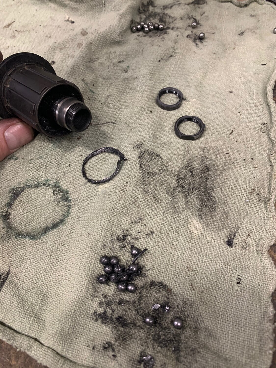

I had freehub play last year. Since the hub was xlc (an inhouse brand of haibike) I couldn't find even a diagram showing the order of the parts during installation. Still I serviced it myself fairly easily relubed and put it back together with a bit of guesswork and it has been running great for almost a year now.
From the picture it seems like you could have cleaned and re-assambled with new ball bearings or the worst case you could have changed it with a new hub for around $25.
The LBS should have offered to open the hub and do that. They make more $ bu selling a hub+rim/lace it .
I would not use that LBS i the future. The ball bearings are 8-15$, grease another 5$, 25$ like you said...
Sorry I didn't mention it and what the photo doesn't show is a deep groove worn into the shaft. It was toast.
Greasing the first two inches near the heads of the motor mount bolts helps eliminate the noises. This is in addition to using a thread locker on the nuts.
I had the same problem with my bike recently. I was getting two noises, one from the hub and the other closer to the motor. I started looking at the hub and found that one of the races on the rear hub axle had been poorly made and some of the race had actually broken off, making the bearings very rough. I took it to a local shop and they ordered a hub and re-laced the wheel. It took almost three weeks to get the bike back. In the meantime, not holding out much hope, I contacted BH. I got a prompt response (within 24 hours) with the part number and an invitation to order it through one of their dealers. I called Crazy Lenny's and spoke to a service manager (Conner). He ordered the part then shipped it to me at no cost to me. It arrived two days after the wheel had been rebuilt. I could have saved $240 if I'd known all this in advance.
To sum it up, BH seemed to have this oddball axle issue, Crazy Lenny stepped up and handled the problem at no cost to me, about as quickly as the local bike store could fix it.
The noise closer to the motor turned out to be a very worn out chainring. I had replaced the chain and cassette when I first investigated the problem, but the chainring necessitated a new tool so I had not replaced it yet. As soon as I put the chainring on the noise completely disappeared. With the new chain and cassette it also shifts better. It also allowed me to move to a 34 tooth chainring, which suits my local riding in North Carolina much better. I downgraded to a Deore cassette hoping it has more steel in it. If I could find a steel chainring for a cheap price I'd use it instead of the aluminum one I got. But the only steel rings I found were near $100 and the aluminum one was less than $20. In the future I will just know to change the drivetrain before I get 900 miles on it (that's about how many miles were on it when I started noticing a bit of noise). BTW, I'd bought the chainring, chain and cassette late last year - all for about $105 total.
