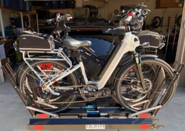

Dual QuikRstuff rack with my 4" fat tire Radrover and wife's 2.3" tire Radcity Step Thru with fenders with optional ramp installed on the end:
Optional ramp available:

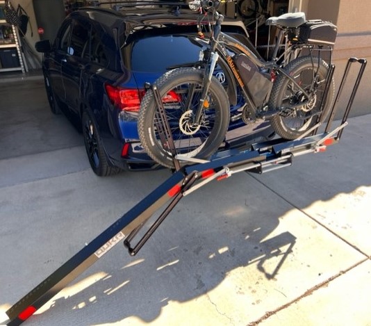

Here is what I use,
Motorcycle Carrier, 1 or 2 place, rated to 500#+.
Get the type that has 1/2" bolts that you remove to make wheel pockets, for your bike, see below photo.
Ramp
I secure my bike 100#'s, with 2-4' NO hook ratchet straps thru the spokes and around the carrier, I removed the 1/2" bolt to make wheel pockets front and back to fit the bike.
I also use 2- 5' ratchet straps along with 2 soft straps that go around the seat stem, to pull/hold the bike into the wheel pockets,
over 600+ miles of rough 4x4 off rode traveling and it works perfectly.
The Black OEM ramp didn't work very well, so I got a 6'+ long, folding ramp, (works much better), I use the OEM short ramp to place over which ever hole (Wheel pocket) is open, during loading,
off loading, then slide it over the wheel pocket when off loading.
The above ramp also fits in place with the short OEM ramp.
Enlarge the photo to see the ratchet straps in place.

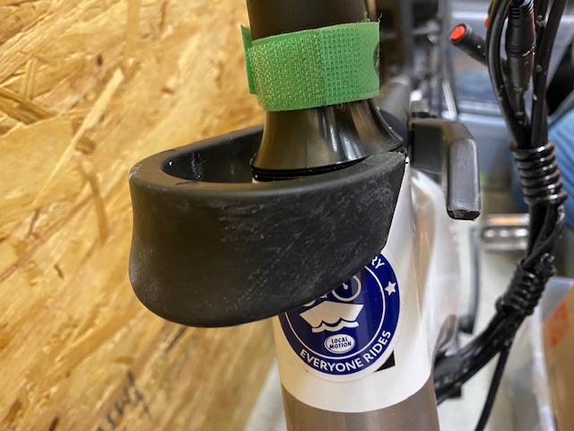

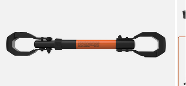

My only other thought is to keep the Hollywood Sport rack and find a much sturdier crossbar adapter than the Hollywood branded unit which doesn't inspire a lot of confidence. The clamp separated as you can see, but the only other bar on the market that looks like it might be more robust is a Hyperax. On the other hand, it might be a rebranded version of the same mousetrap. Anyone have experience with one of those? (smaller photo on bottom right).
I have the Hyperax adapter. It is definitely more robust than others I've tried, but much more expensive as well. It works quite well compared to others, but the collars are a bit loose on the seat post and stem. This loose fit is common among these adapters and usually leads to cosmetic damage.
To minimize this damage, I cut a foam swim noodle into 6" lengths and split them halfway through. I put the split foam around the seat post & stem before installing the adapter. This eliminates the paint damage and reduces the looseness. Might be worth a try before spending big $$ on a new rack.
