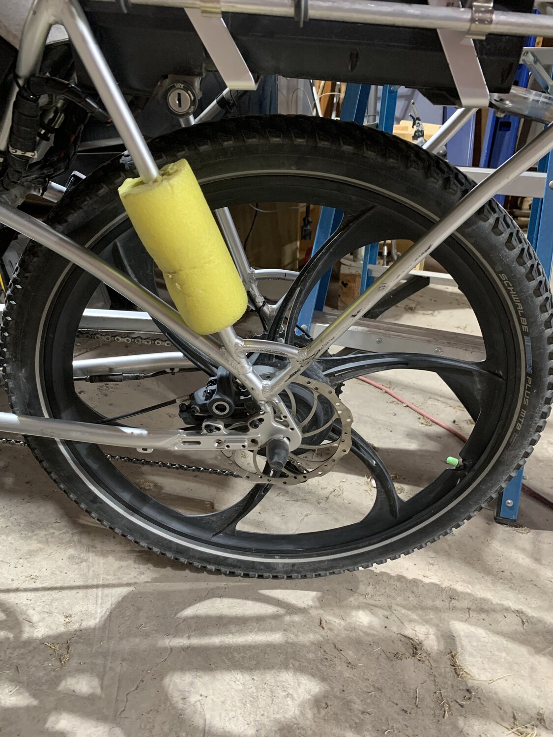

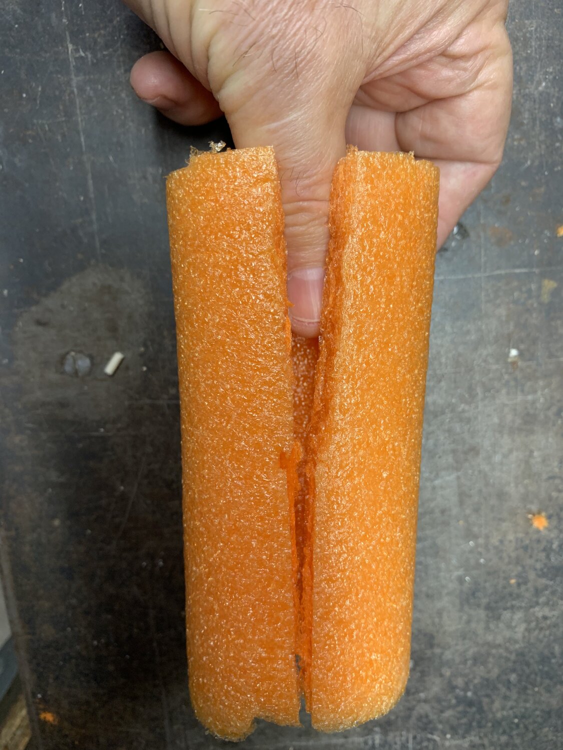

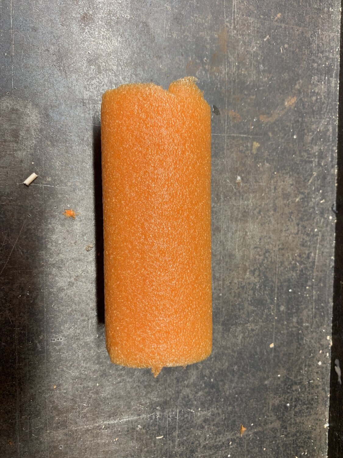

I have the same issue with my Thule 2 bike rack. To keep them from rubbing together, I bought a cheap swim "noodle":
I cut it into 6 to 8" pieces and split them down the middle
They can then be placed around the bike tubes at the rub points to maintain separation:
That is a great idea! I have been using a piece of PVC with straps at each ebd to keep them apart.
View attachment 180648 View attachment 180649
