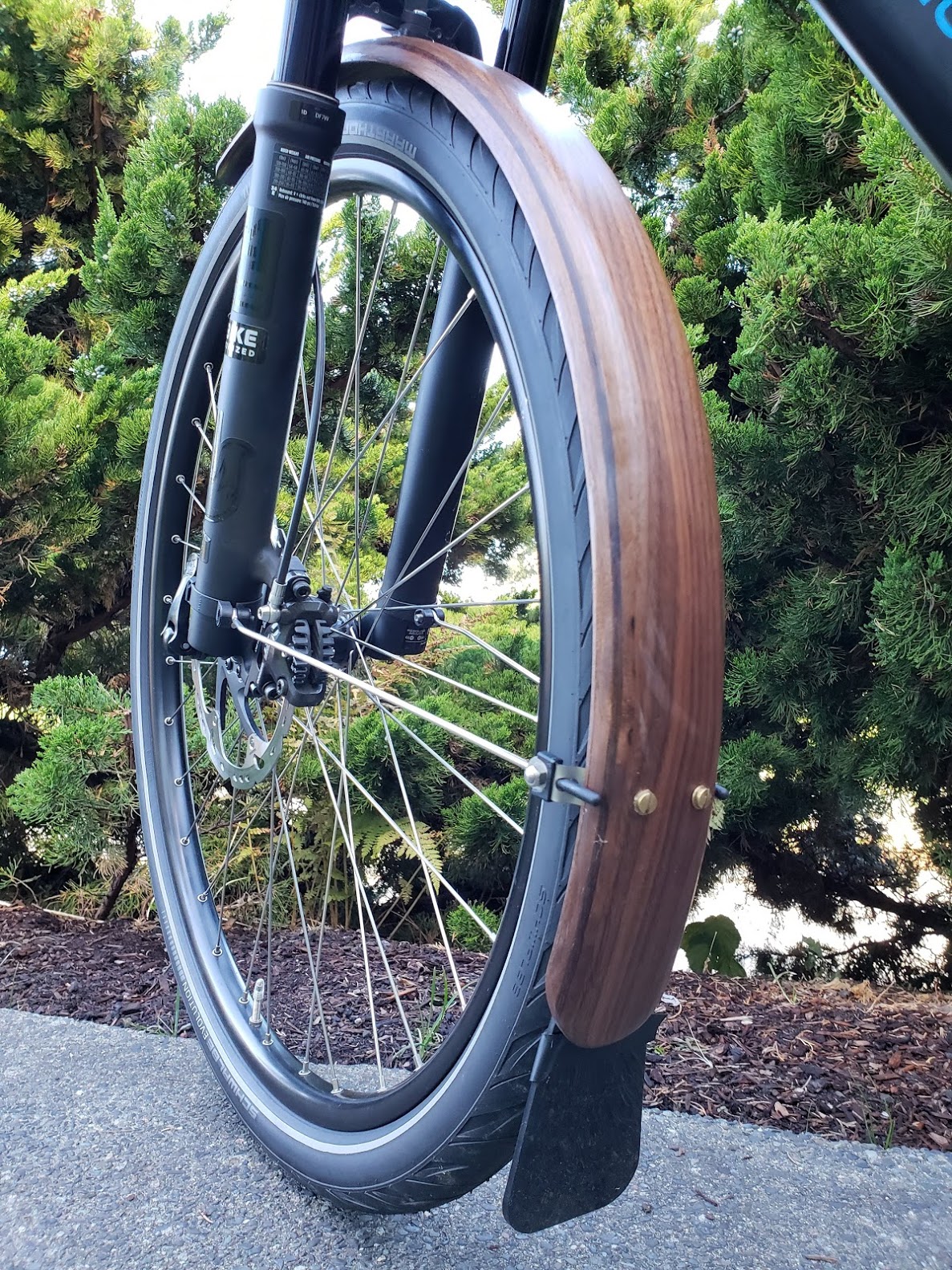

Brembo make some of the best brakes for motorcycles and cars so its no surprise theyre making bicycle versions, expect to pay for it though.
Also braided stainless steel lines like you see in the pics above, make a huge difference on a motortcycle (i no longer ride motorcycles due to disability), the lines wont swell like other materials so more effort from the hydraulics goes into the braking rather than being wasted energy.
