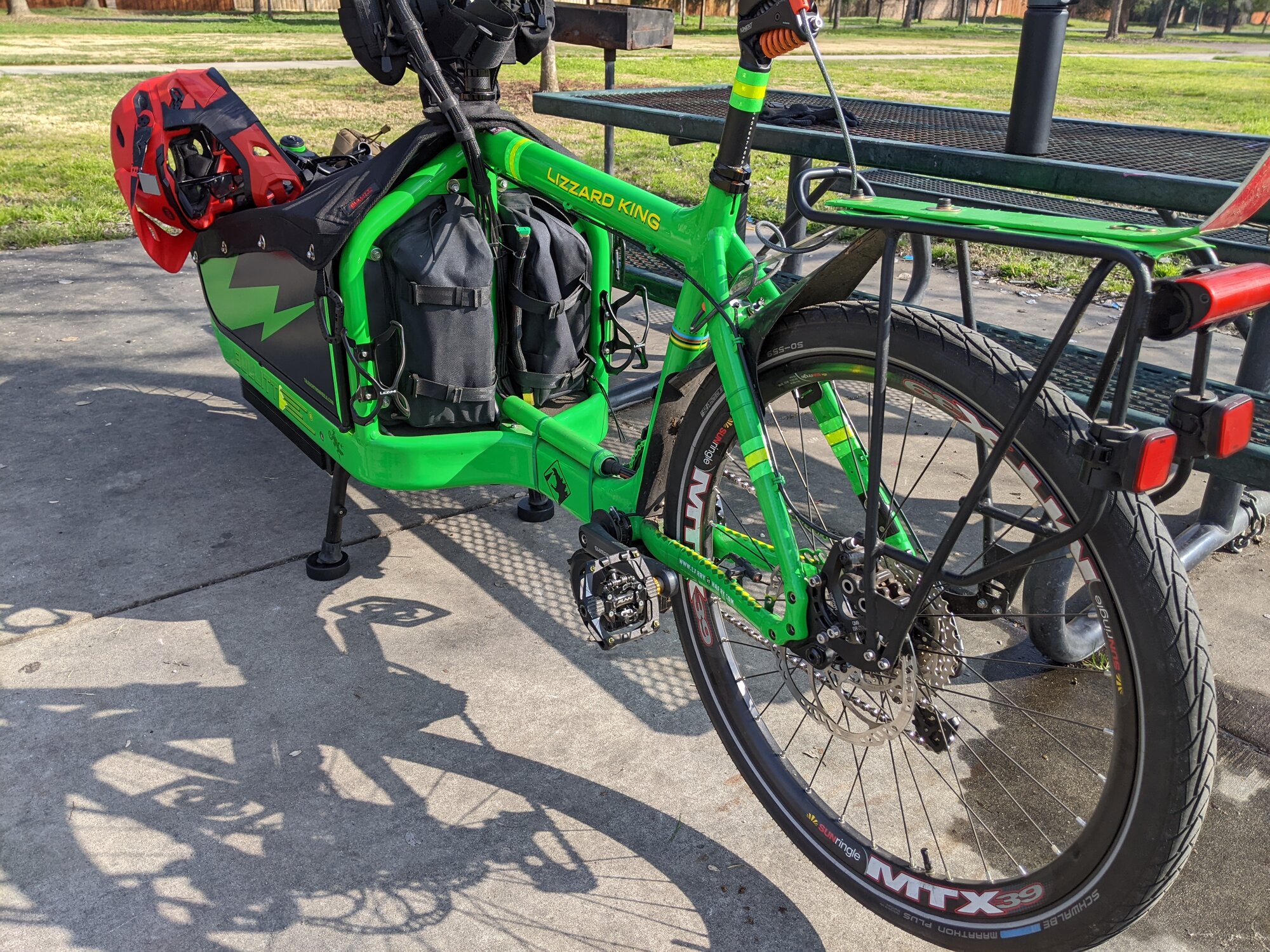

huh I just checked and sure enough you can go 70 psi on those tires. 60 is good enough for my 250 lb carcass sitting on one great big cargo bike. 70 for sure is unnecessary. With the Marathon, I have never had a flat for FlatOut to seal in the first place. They seem to be invulnerable to all intents and purposes.
I will try and get a pic of the Marathon Plus Tour from the same angle as below for a comparison. I put it on maybe a week or so ago. I think that tread will be exactly what you are looking for insofar as paths/hardpack is concerned.
