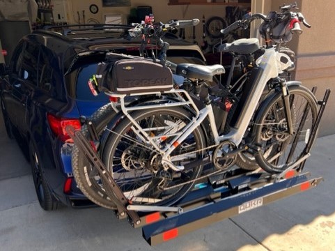

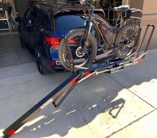

There are some factors for me like depending on what type of budget I have, how long will I keep, ease of use, security, storage concerns in the vehicle or at home, % of time I need to carry 1 versus 2 bikes. I went with the dual QuikRStuff rack+ramp; which, is very similar to 1Up rack with improvements I liked. Not a cheap rack and the wait time is around 2 months. QuikRStuff works with small kid bikes and up to 56" long wheel base 5" Fat tire bikes with no extra parts/tools to adjust the rack system like some others. You can fold up both racks and place in a corner in the garage, toss in the hatch, or back in a closet at home.
2016 Radrover at +75lbs
2023 Radcity Step-Thru at +72lbs
One rack come in at 28lbs and holds 120lbs total
Second rack comes in at 22lbs and hold 240lbs total for both
Second pic of both racks installed with ebike ramp attached to 2nd rack

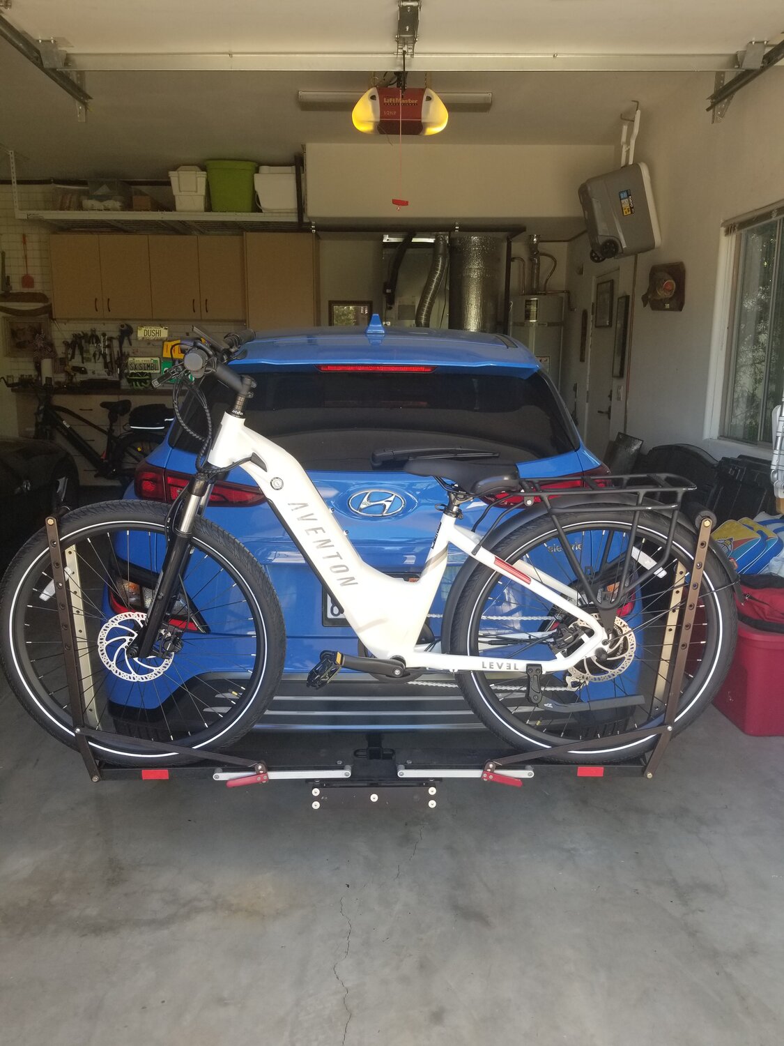

Level 2 on the 1UP 1.25 single. Solid as a rock. I even broke down and ordered the fender cushion!
