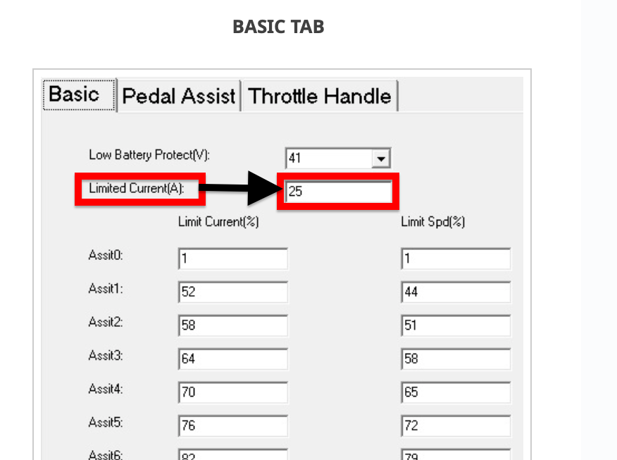

Yep. That's what he told me. He did set the motor to a 20 amp limit, I guess he doesn't want newbies (me!) frying their motors or breaking things right off the bat ...
25A? 25A was his typical setting. That's NOT in firmware. Basic programming!
