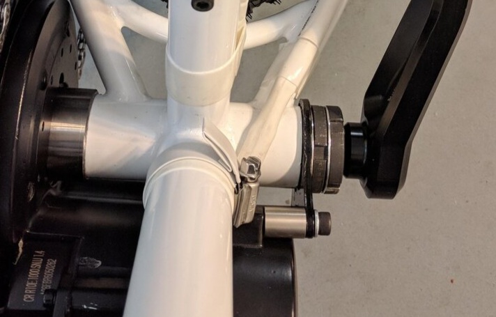

The locking plate has 9 teeth that press into the left side of the frame's BB shell. Ti is very hard. I use a shortened hack saw to file in notches 40 degrees apart. I first mount tightly and in the most forward position, then and mark around the shell with a paint pen. This will secure the motor. The beer can idea came from Zen and the Art of Motorcycle Maintenance. One guy did not want to have a beer can shim to secure his BMW's handlebar. So it continued to move around.
ty !! if i tighten it up do you think it will at least mark the Ti ? to be sure i'm in the right spot ?
It should!

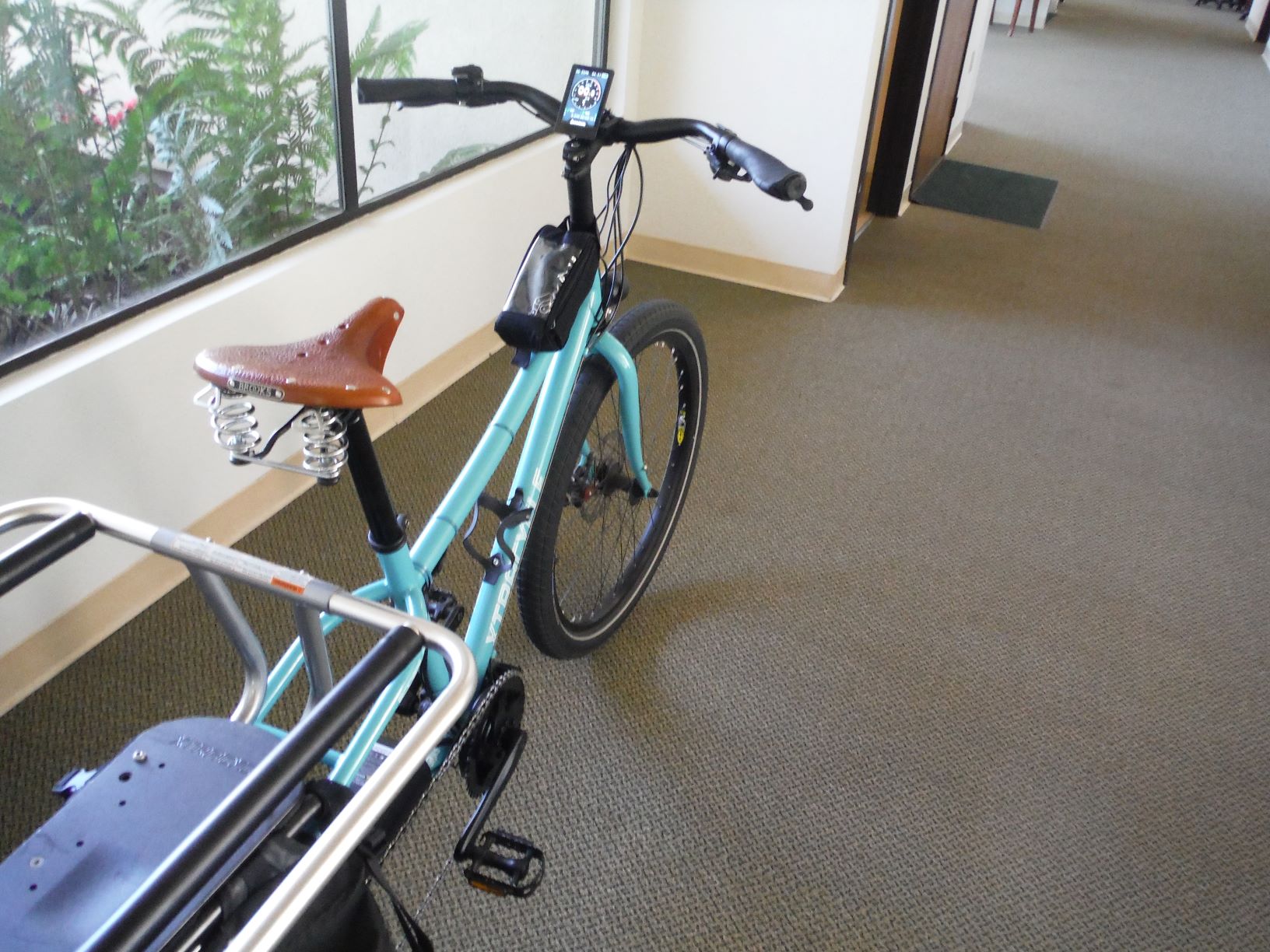

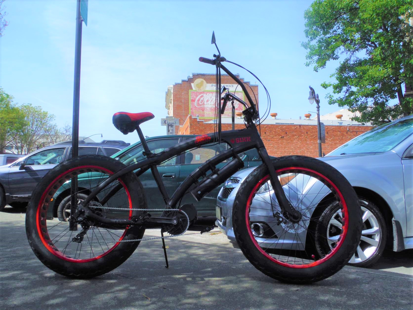

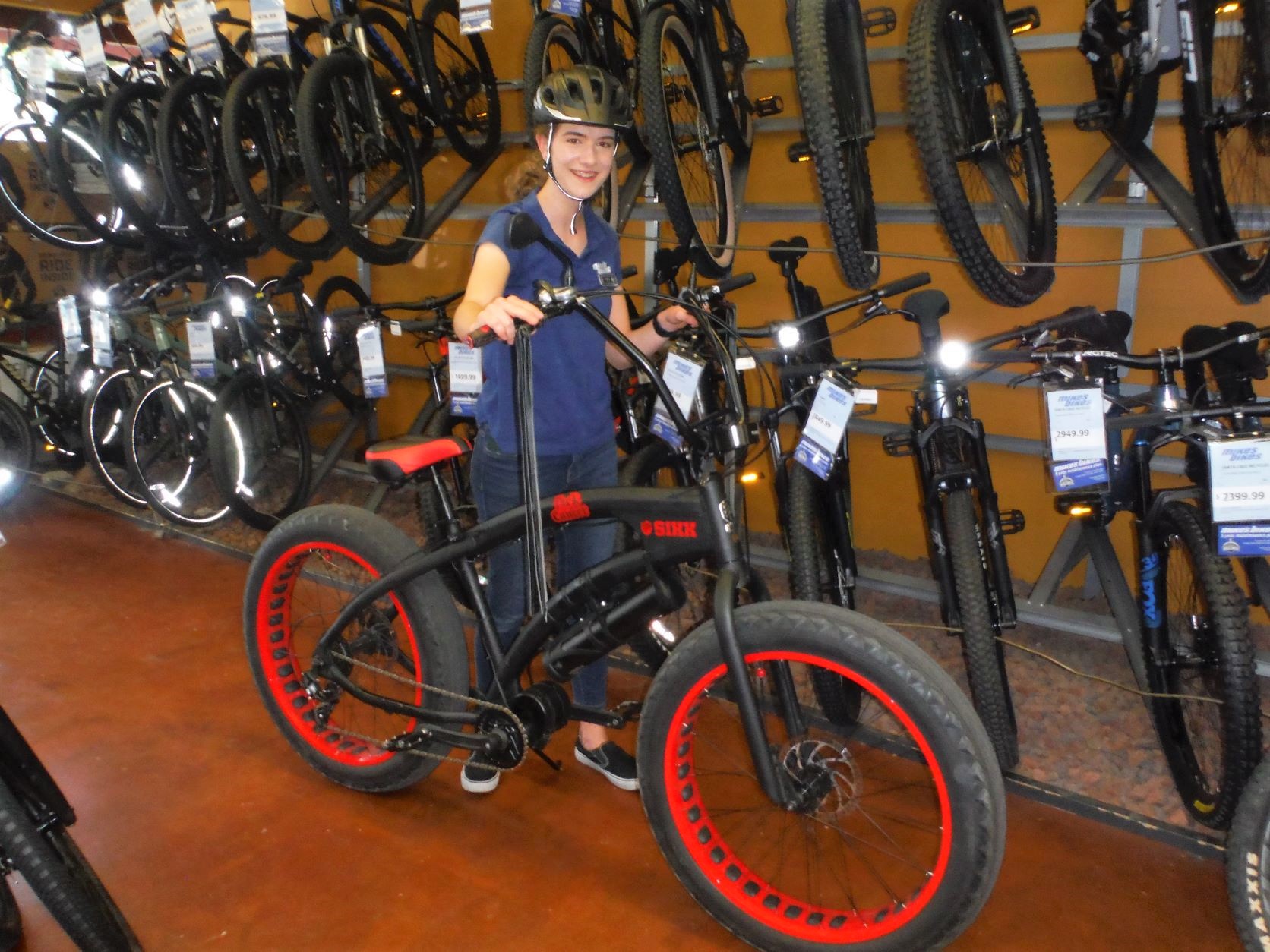

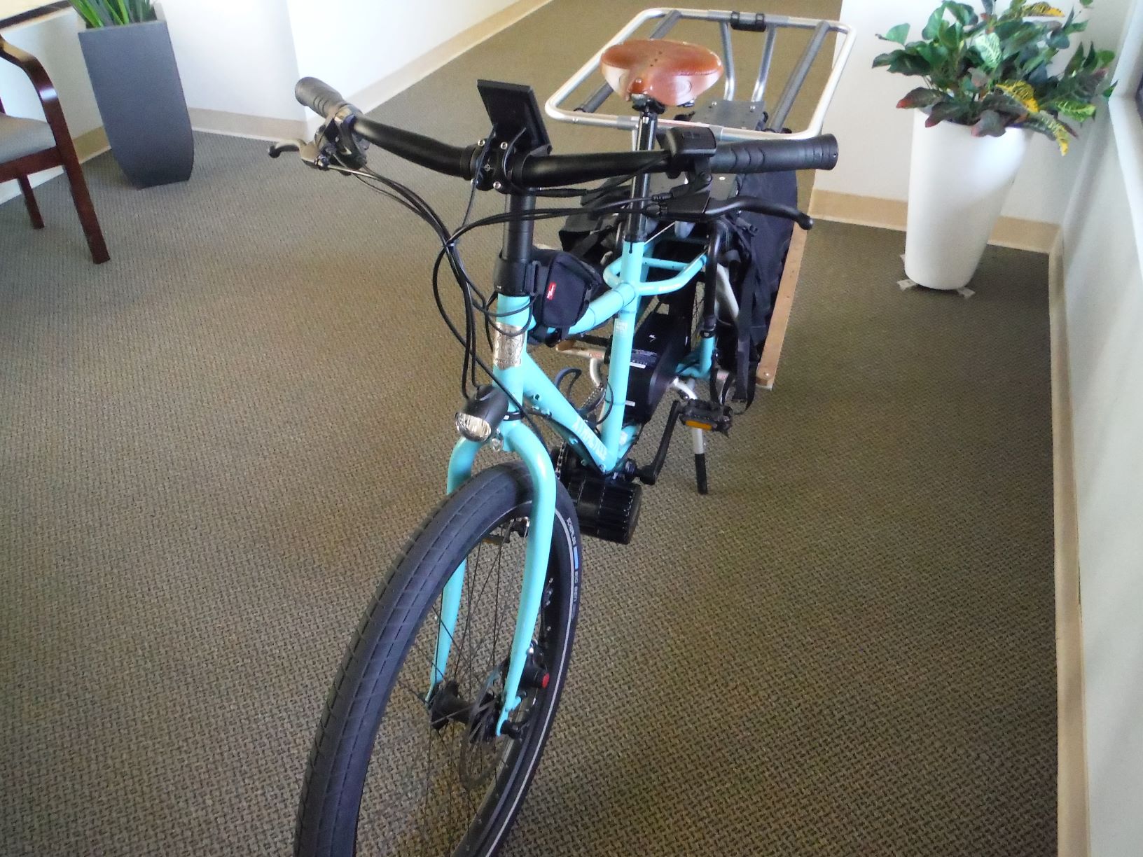

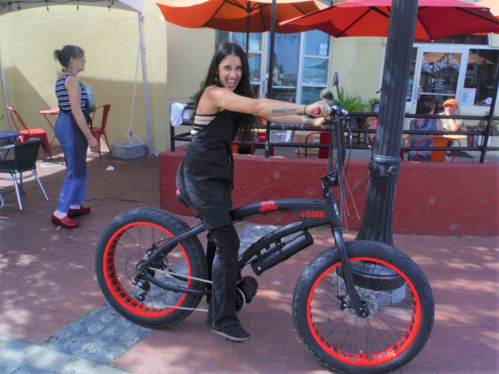

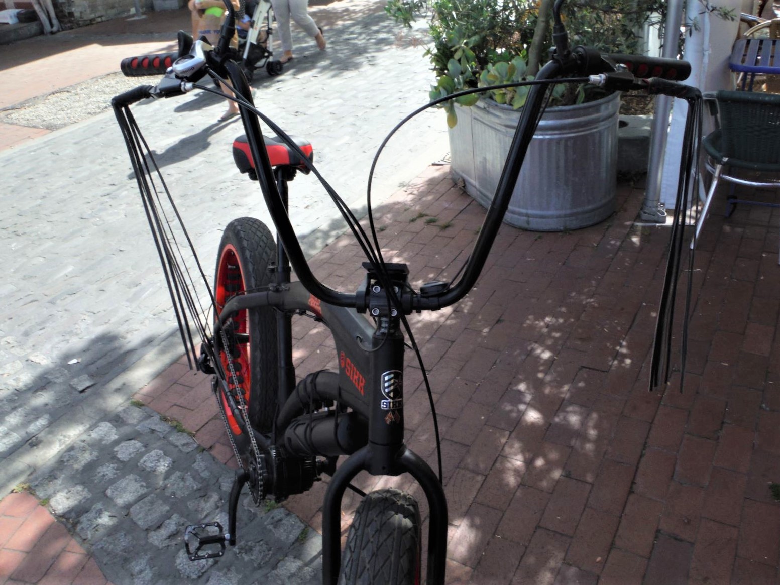

That is right about getting what you want. @tomjasz does not shim, I do. I use a thin material. It might take three attempts to get the thickness exactly right. And I use Park Tool poly lube. All threads get lock-tight. Crank arms or pedals are often the source of a creak but I want the BB rock solid. Here are a couple of HD builds. Check the connections and housings for hygiene.
With Al it will mark, but not Ti. Put it on at the correct spot semi-tight. Then use some dots of paint where it corresponds. I think you will need to make a template from 3x5 type card stock so you get it right every 40 degrees. Then file in the nine equally spaced notches at 2mm like a clock face around the left edge of the BB shell. That is the thickness of the edge of a nickel. These are secret weapons you are learning.

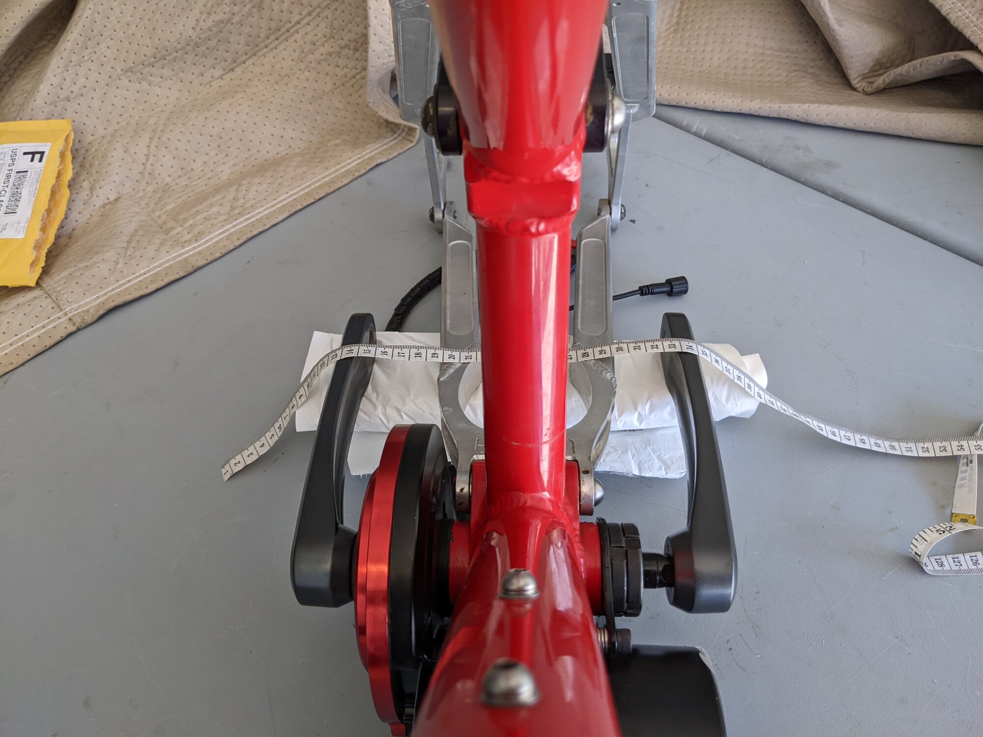

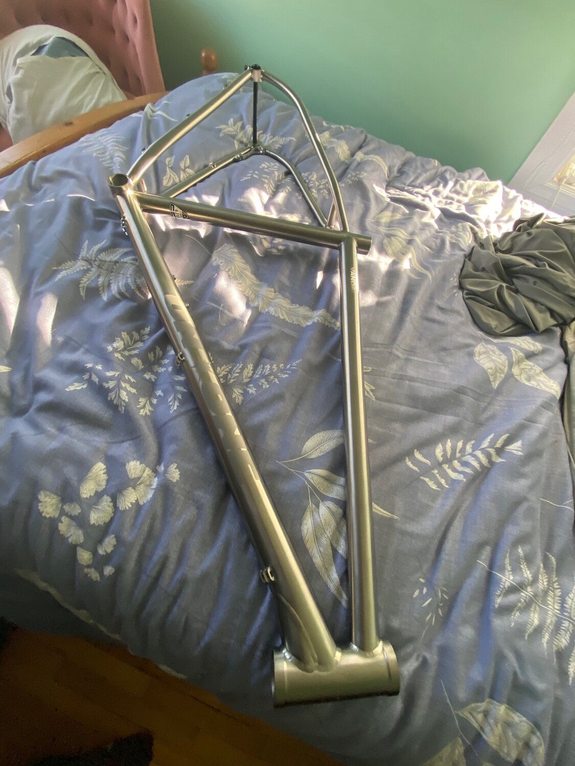

...i need about 8mm of spacers on the drive side to clear the stay , made a template based on caliper measurements.... this leaves me 10mm on the other side for the lockring... might be hard pressed to fit a second on there but i'll try.
Oh something I forgot that might be a godsend for you. You're talking about a limit on your space for the 73mm bracket. Lekkie has developed a solution specific to your situation:
It just came out. I'm not going there as the double-nut solution works for $4. But if I had the space constraints you do, and they prevented me from double-nutting... this is what I'd do to solve it.
10mm is all you need on the threads. Also there is the crank arm geo to consider. On one recent build I used 55mm fat bike arms to provide clearance of the wide chainstay. I do not know in your case. Just a thought. It also prevents a pedal strike on the rough stuff.

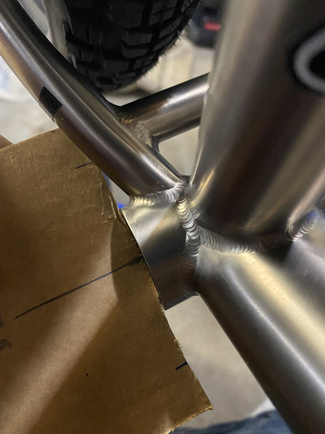

another question... the casing by the chainstay is pretty thick , thoughts on some mild resurfacing of the backside of it to reduce the amount of spacer needed ? (#weightsavings lol) semi serious question , but i'm by no means married to this idea.
I am having trouble visualizing this. Can you show us a photo of the 'casing by the chainstay'? Thanks.

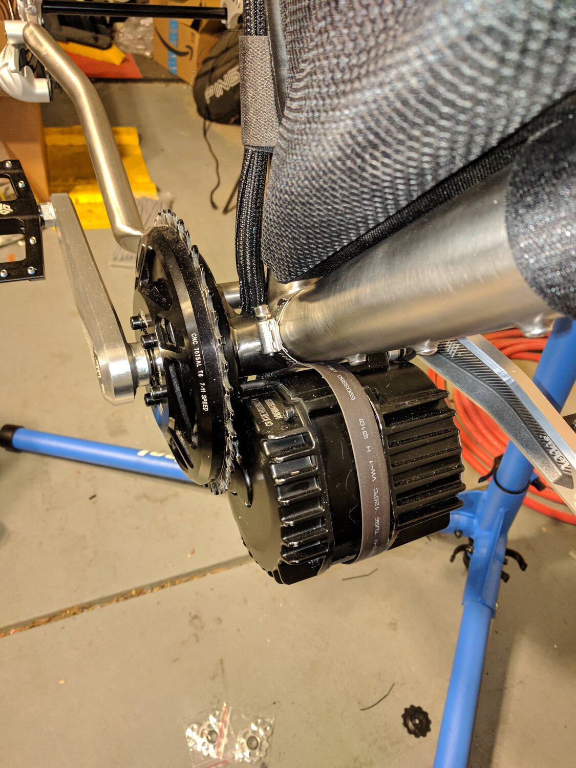

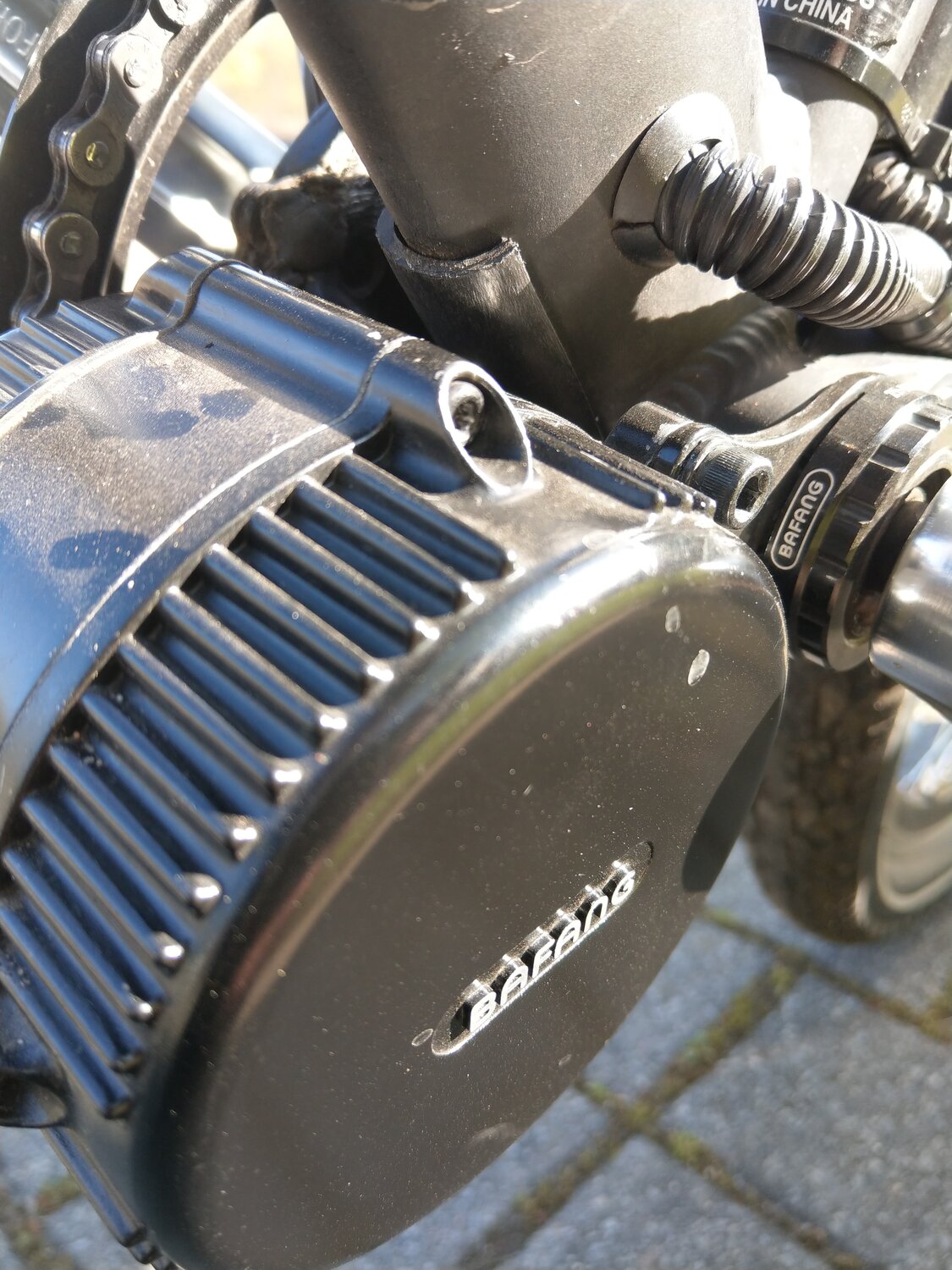

Here where the back of the gear housing would hit the chainstay if not spaced out ... if i wanted to use a smaller spacer and grind a small amount of the housing off where it lines up with the chainstay.
Got it. Removing a small amount of the motor housing casing sounds great, at the point of contact. Just make sure it is sealed. There is also a tool that I do not have, which will crank in a concave dent on the outside of the chainstay. I do not know what it is called. Others might. What a beautiful frame!
I would prefer not to compromise the frame , my goal by using a combo of a spacer and creating a recess in the back of the gear casing would be to minimize the impact to the Q value. Lekkie Buzz bars are on their way so that will help a bit too.
