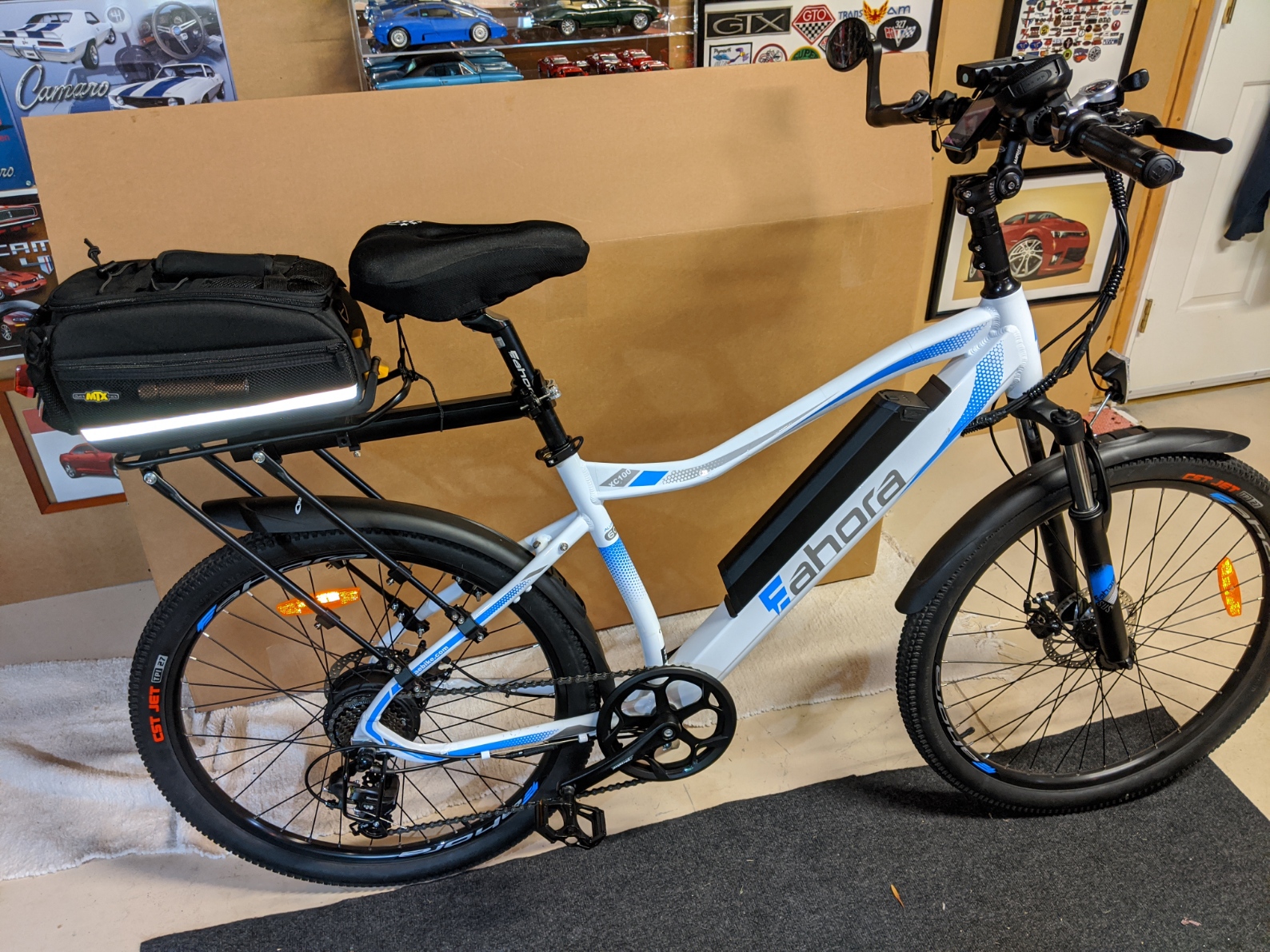

Thanks for the info. Only 25 miles so far, seems to be operating OK. I have attached a photo of what my bike presently looks like. I have added a rack, new stronger kickstand, blue tooth speaker, mirror, headlight, electric horn, fenders, and raised the handlebars.
Thanks for the info. Only 25 miles so far, seems to be operating OK. I have attached a photo of what my bike presently looks like. I have added a rack, new stronger kickstand, blue tooth speaker, mirror, headlight, electric horn, fenders, and raised the handlebars.View attachment 59075
The XC looks great! Kinda wish I'd ordered mine in white (it's coming in blue). What parts did you get to raise the handlebar? I might want to do the same.

Here are the items, both on Amazon. You may not need both.
FOMTOR Bike Stem Riser MTB Handlebar Riser Stem Extender for Mountain Bike, Road Bike, MTB
Wake MTB Stem 31.8 90mm 110mm 0-60 Degree Adjustable Bike Stem Mountain Bike Stem Short Handlebar Stem for Bicycle, Road Bike, MTB, BMX, Cycling (Aluminum Alloy, Lightweight, Black)
Both are very inexpensive..

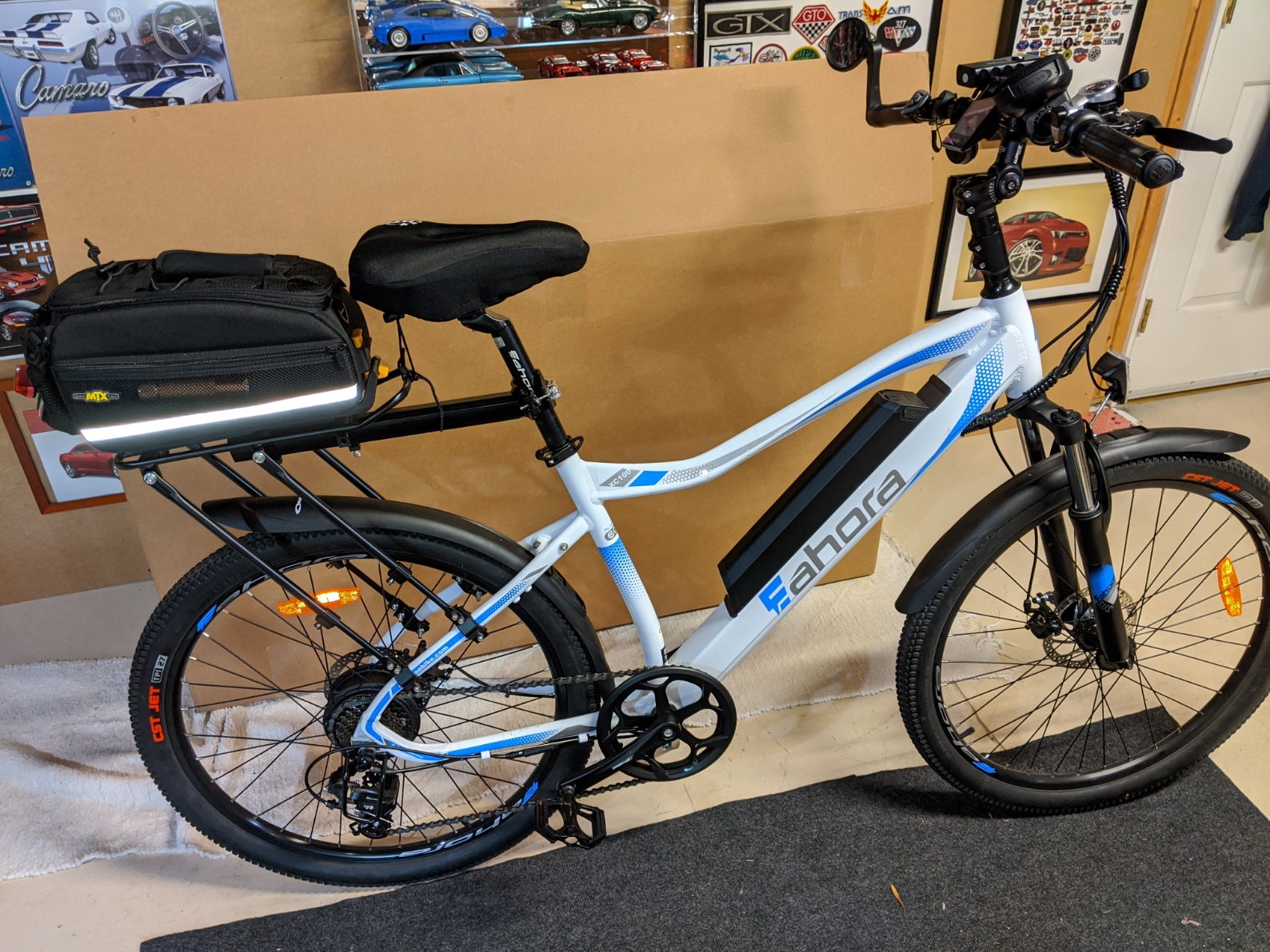

Hello , if you don’t mind can you tell me what type and brand of fenders do you have on your Eahora bike and where did you purchase them from . I am awaiting a red and blue Xcode 100 . You have really set up your bike nicely. Thank You for the information.
