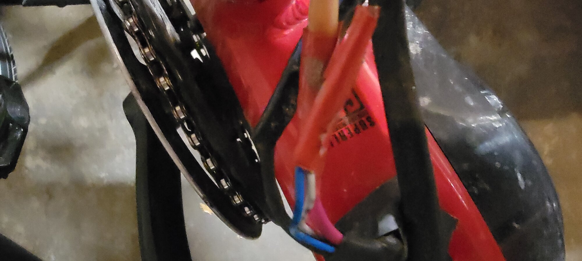

I have a 2015 Raleigh Tekoa iE bike, it's an awesome bike but no battery set up. I have seen some on Amazon and some other sites but none of them show the 4 wire hook up that is coming out of the frame. If anyone knows where I can get what the proper parts, I would appreciate it. As far as I know it's a 48 v, 10 ah and 500 w. I am attaching a picture to show the wires.

Yes, no battery and I've never owned an e bike before so at a bit of a loss. It has a 4 wire connector coming out of the frame. $800 for the original set up is more than the bike is worth so looking for something less than that that is compatible. From what I can gather it had a 48v battery 10ah and was 350w or 500?

Yes I see how that is on the cradle. The wires I have hanging are what's left of the original cradle. Finding the cradle and battery to fit my bike not a huge problem. It's what wires go where and are they the same as the originals, color wise. I really wish cradle was on the bike but it is not. Just don't want to fry anything when it's hooked up. I am assuming that 1 wire for power and 1 for ground but it has 2 more. I am told there is another power switch on the bike itself so you have the one for the battery and one on the bike, and you have to use both for it to work, so one of the wires could be for that. What the 4th wire could be for I am not sure.

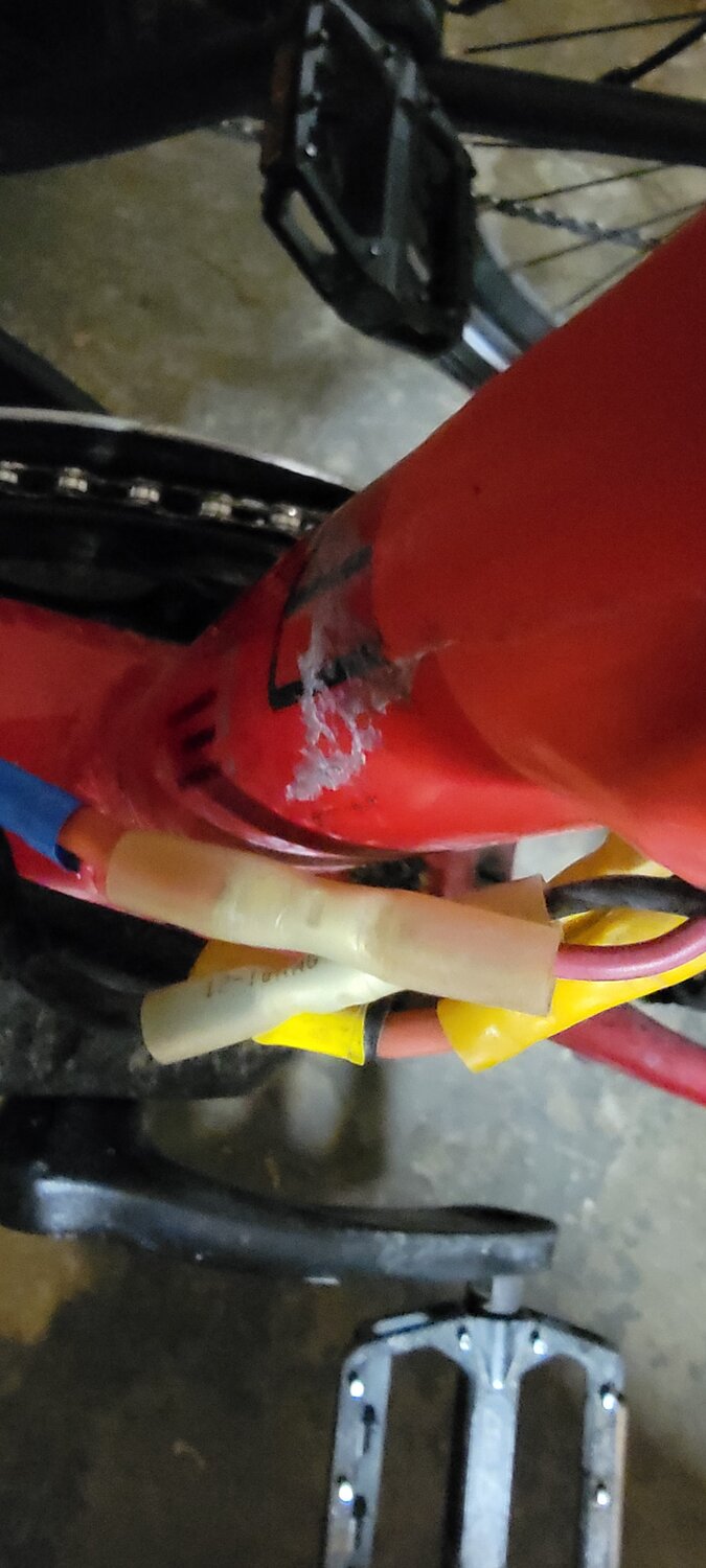

I am having the same issue and got stuck wiring the 4 cables how did you connect it at the end?
I was able to make it work. The battery matters! You need to get a batter that looks the ones on Page 1. I got my battery from Amazon.
On my bike I had 4 wires, black, red, white and blue. I connected the black to black and red to red. There were no blue or white coming from the battery carriage.The blue and white wires from the motor I twisted together. I also connected a watt meter to the system.
Just a few cuestions, how did you connect a watt meter, and what for?
Did you twist the blue cable attached to the white?
Or the blue with the red and the white to the black?
Since I'm not an expert i don't want to fry anything
