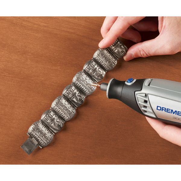

I've had good luck cleaning this type of terminal contact using a small wire brush attachment for my Dremel tool.
After cleaning the male and female contacts, you may have to build up the male pin with a bit of solder to get a good connection. I wouldn't try this unless you are proficient with a soldering iron. If you try this, BE VERY CAREFUL not to overheat any internal components!
