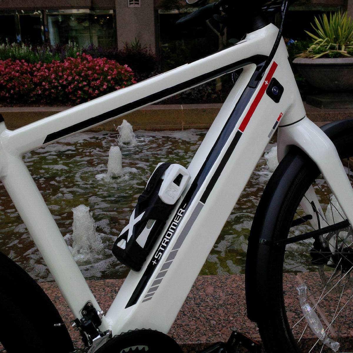

Most ST2 riders I've seen buy the ABUS Bordo lock. It's nearly as safe as a U-lock but can fit around larger poles.
An Abus Bordo Granit X-Plus 6500 is the top of the line of Abus folding locks. It can secure the frame and rear wheel of an ST2 to a bike rack, but not both wheels unless you buy a second one. They are sold in black, red and white versions. To mount the Abus lock holster to the water bottle bosses, I used two metric stainless steel button head cap screws, size M5-0.80 x 20. I also added nylon washers as spacers between the down tube and the Abus lock holster because the holster has curved ridges designed to mount to a round frame, and as you know the Stromer down tube is relatively flat. The right metric threading for the water bottle mount screws is critical or you risk stripping the threads, so be careful to buy the right ones. Also, since the screws are going into the frame close to the battery compartment, they can't be too long. The M5-0.80 x 20 size takes into account the nylon washers I used. The original button head cap screws on your Stromer are fine for water bottle cages, but way too short for mounting the 6500 holster. I was assured by Stromer that the weight of the lock wouldn't be a problem, with further assurances coming via internet photos of ST2s from European owners. They appear to be a favorite lock for Stromers on the continent. Attached is a photo of my white ST2 with a white Granit X-Plus 6500.

I have to agree with the posts here on the Abus Bordo Plus locks. I ride with one on my ST2 and after seeing all types of locks cut it was the most practical and convenient lock to use for me. Keep in mind that it is equally important to lock it to something that is equally as strong and securely fastened in the ground etc.. If the thieves have the tools and know how to cut the Bordo any U-lock or chain shouldn't be too much more difficult for them to break.

Thanks for the recommendation, I hardly use the theft mode on my ST2, havent had the need to use it for now, but I ordered the Abus Gordo Granit recently, one thing is that I am using a water bottle holder on my downtime and I don't want to drill into my bike in order to secure the Abus lock. Once I get the lock I'll figure something out~ Thanks again, the ST2 is one amazing bike!
