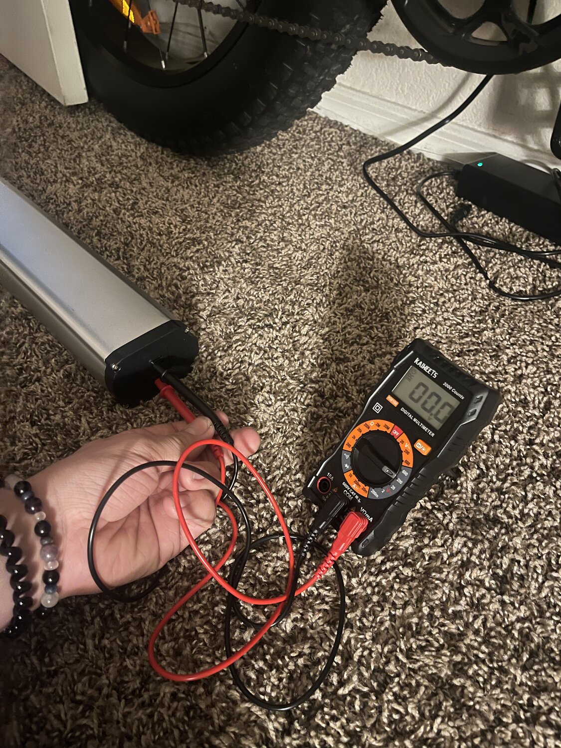

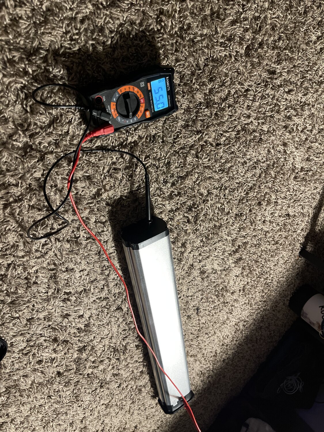

About a week ago while riding my bike around, the entire system abruptly shut down giving no signs of life. I checked everything from checking the fuse, cords for damage, off and on, etc. which had no errors. I took it to my LBS to get a test. Which lead to no readings of life on my battery. I even encountered the same issues with my own testing.
In addition I tested the charger port which did give life. But not the prongs where it connects to the bike.
Bike model: RURUI XT9
Battery: 48v 14.5AH
Would it be safe to assume my bikes battery is the cause or the controller? Any tips/advice would be greatly appreciated?
(Photos attached for reference)

The battery is the "storage" device for the electricity, which ALSO controls your controller. If you have power from the output of the charger and a good electrical connection of the contacts between the two, the battery can be the only issue.
Sounds like a loss of connection within the battery. I would suspect a loose wire. Not the sort of thing that is going to get fixed without opening up the battery case and looking inside.

On many batteries there is an internal fuse located just inside. If open, this will create your problem. BE CAREFUL on the OTHER side of the fuse as to not short out the battery!!!

Agree. Could be an internal fuse blew. or a wire came loose off the discharge port. The latter does happen.
It could also be the BMS detected a battery fault, like too much current, but they usually reset after a few minutes, or if not, then after you plug in the charger. Have you tried that?
