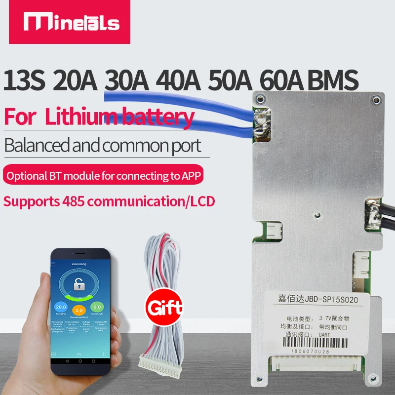

This is the BMS I'm looking at:
13S lithium battery BMS 48V smart BMS bluetooth 485/UART ternary 18650 polymer protection board intelligent BMS
I would NOT recommend this as a solution.
The description states to install this BMS all batteries must be matched by voltage and internal resistance which if you have a bad cell or group you definitely do not meet the requirements
LOL didn't read that part!
