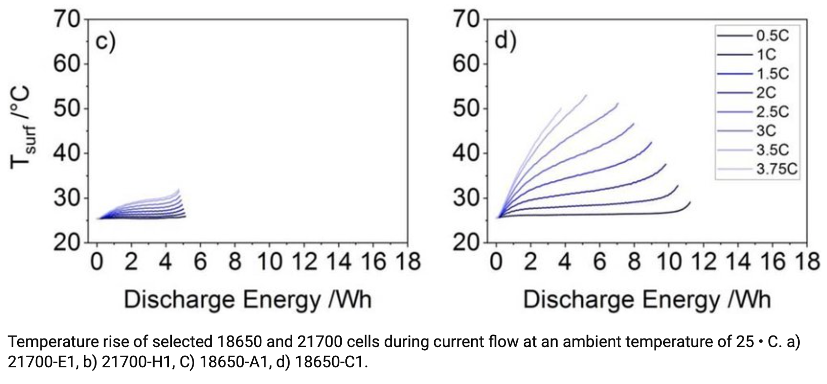

Believe what you want. The science doesn't change because of your beliefs. As I already said, the heat generation is dependent on the discharge rate. Riding on the level with little assist is different from climbing a long steep hill with maximum assist. When might you find a noticeable temperature rise? It depends on a lot of factors, including battery design, housing, BMS and load.Horse pucky. A well designed battery appropriately sized will NOT generate heat. My bikes all have temperature readings and I ride all winter in Minnesota.
Load being the key word here. Many (most) of us are using very lightly loaded batteries for our bikes. Case material can have a lot to do with heat as well. For instance, an alum. clad pack can dissipate heat very quickly/easily. Common sense would tell us when touching a case like that would be difficult to feel temp build up in anything but extreme cases.Believe what you want. The science doesn't change because of your beliefs. As I already said, the heat generation is dependent on the discharge rate. Riding on the level with little assist is different from climbing a long steep hill with maximum assist. When might you find a noticeable temperature rise? It depends on a lot of factors, including battery design, housing, BMS and load.

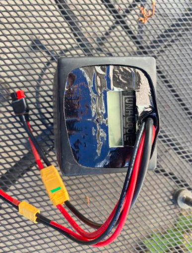

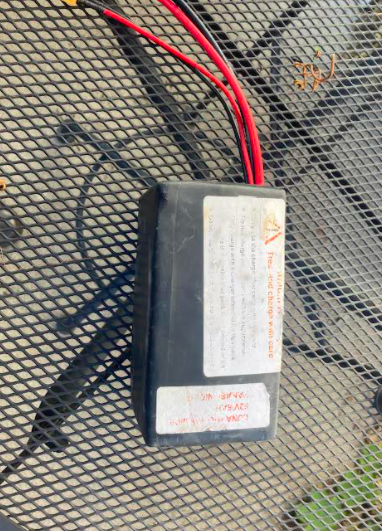

I believe my temperature sensors. With an undersized Luna 52V 6Ah pack I saw lots of heat generated. Same cells in a 20Ah triangle pack, very little heat produced pulling 30A.Believe what you want.
We're actually in agreement after re reading. But I'll reiterate. An adequately designed battery with increased parallel cells will generate very little heat. 52V 14S2P trashed in a matter of months running BBSHD @ 30A 1500W. My 14S6P shed very little heat. Certainly NOT enough for a 20 mile ride in below freezing temps to keep the battery from sagging due to cold temps.Believe what you want. The science doesn't change because of your beliefs. As I already said, the heat generation is dependent on the discharge rate. Riding on the level with little assist is different from climbing a long steep hill with maximum assist. When might you find a noticeable temperature rise? It depends on a lot of factors, including battery design, housing, BMS and load.
