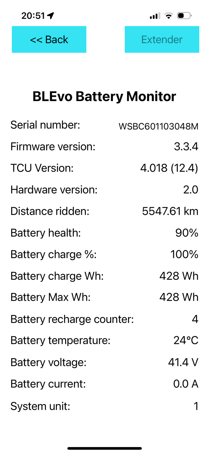

The first thing that has grabbed my attention is you said 12,000 miles but the odometer only reads 5547 km, which is 3,447 miles. Why?
Now, I cannot tell you why the motor ceases to assist down at 27% but please connect with BLEvo then and tell me what you see.
Well spotted. This is because the button battery on the display died and when replaced, odometer read zero. The Blevo screenshot is above
Well, that should have never happened! The mileage is stored with the motor not in the display! Of course I cannot explain why that happened to your Vado. (I replaced the button battery on my Vado for at least two times since the purchase and the mileage was kept. However, the motor was also replaced after 14,000 km ridden, and the new motor had the mileage of zero, of course).
