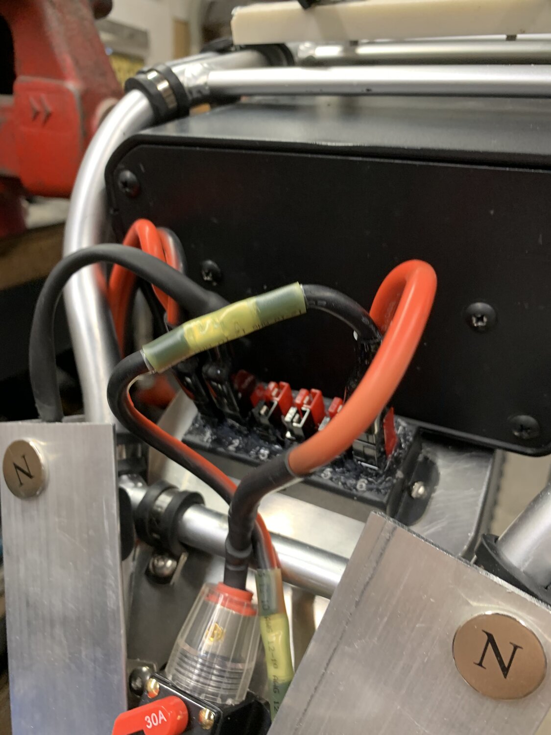

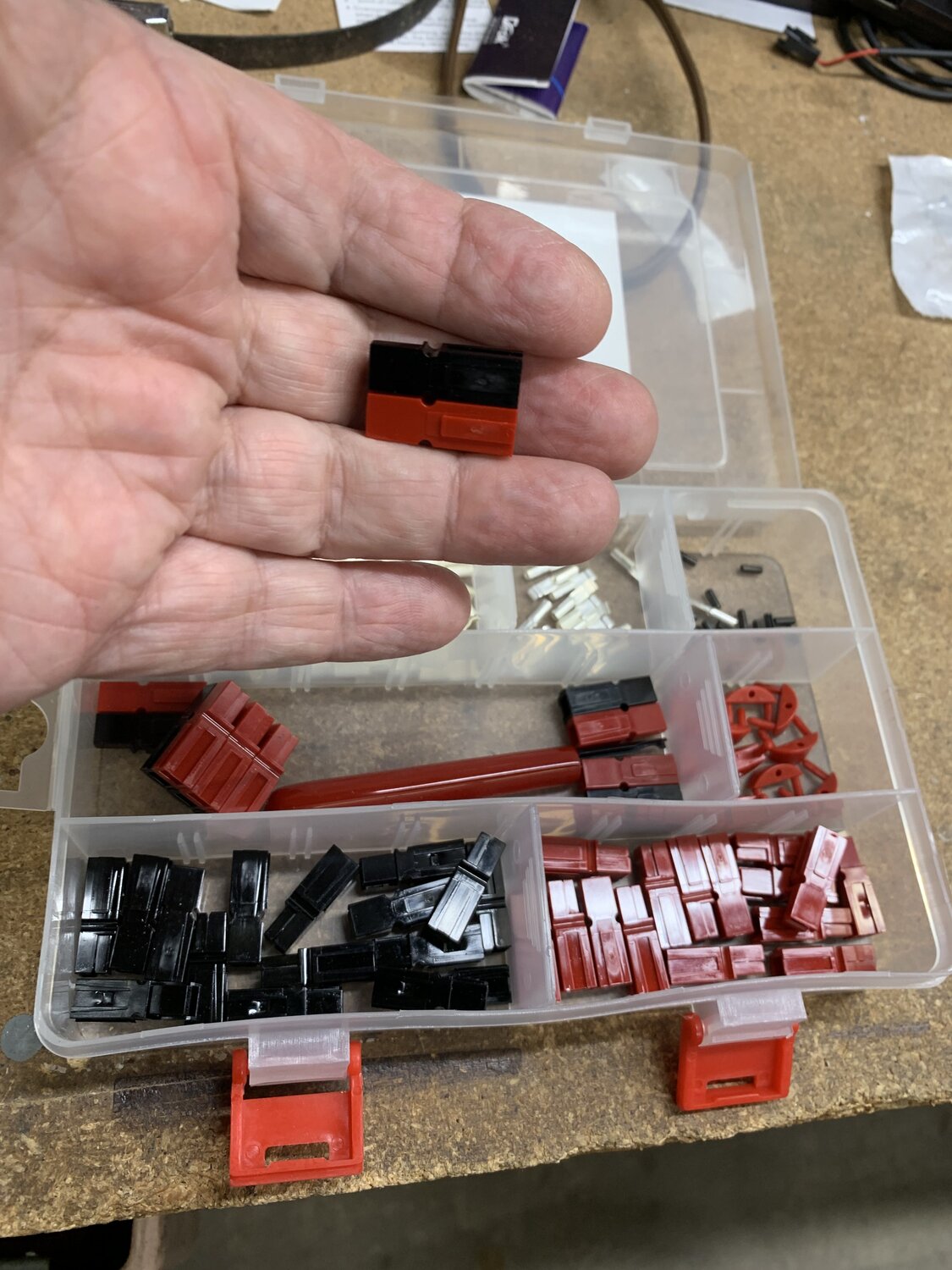

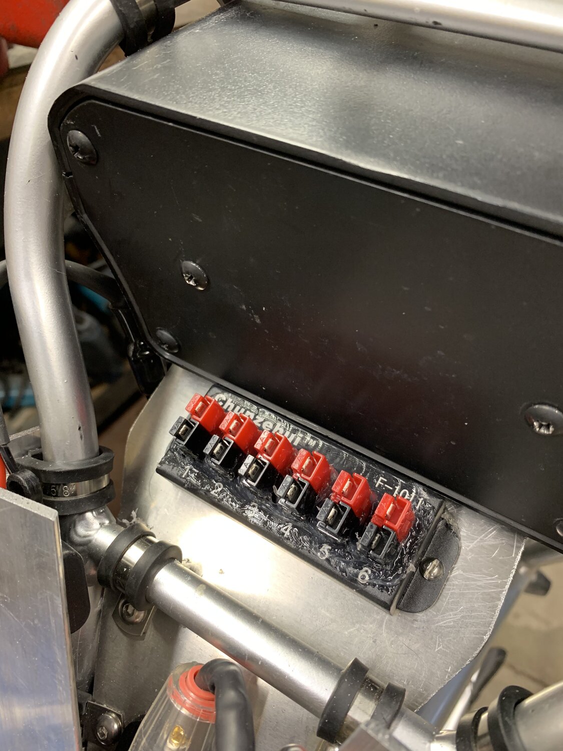

In my case, I stick with bikes that use quality external mount batteries. The first thing I do to a new bike, or one I'm building, it to convert to Anderson 45 amp Powerpole connectors. Some bikes & batteries already use this connector but there are adapters available for other types as well.

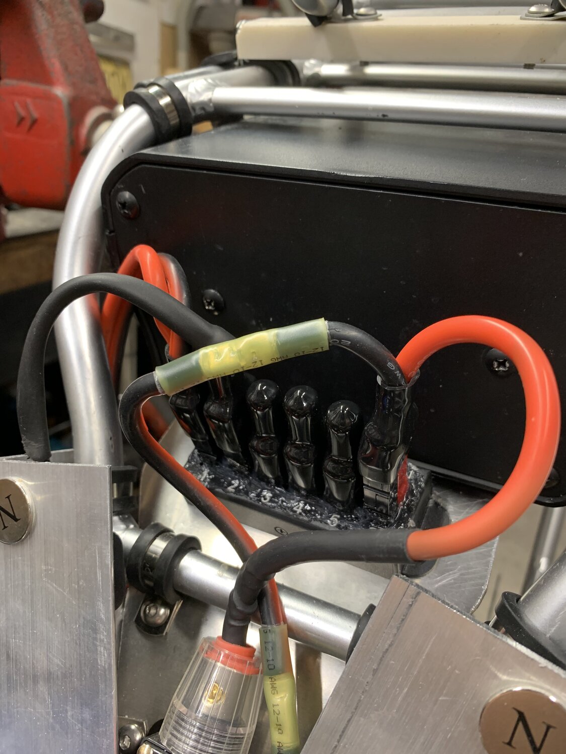

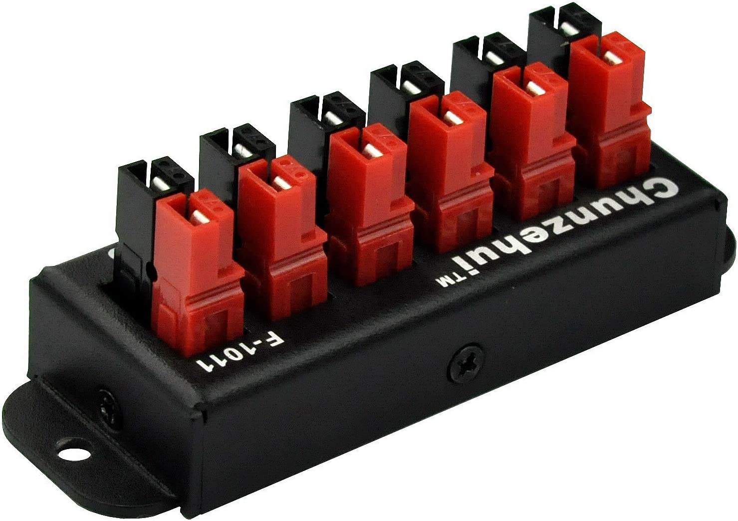

I then mount this Anderson distribution module in a convenient place:
I can then plug in almost any battery of the correct voltage.

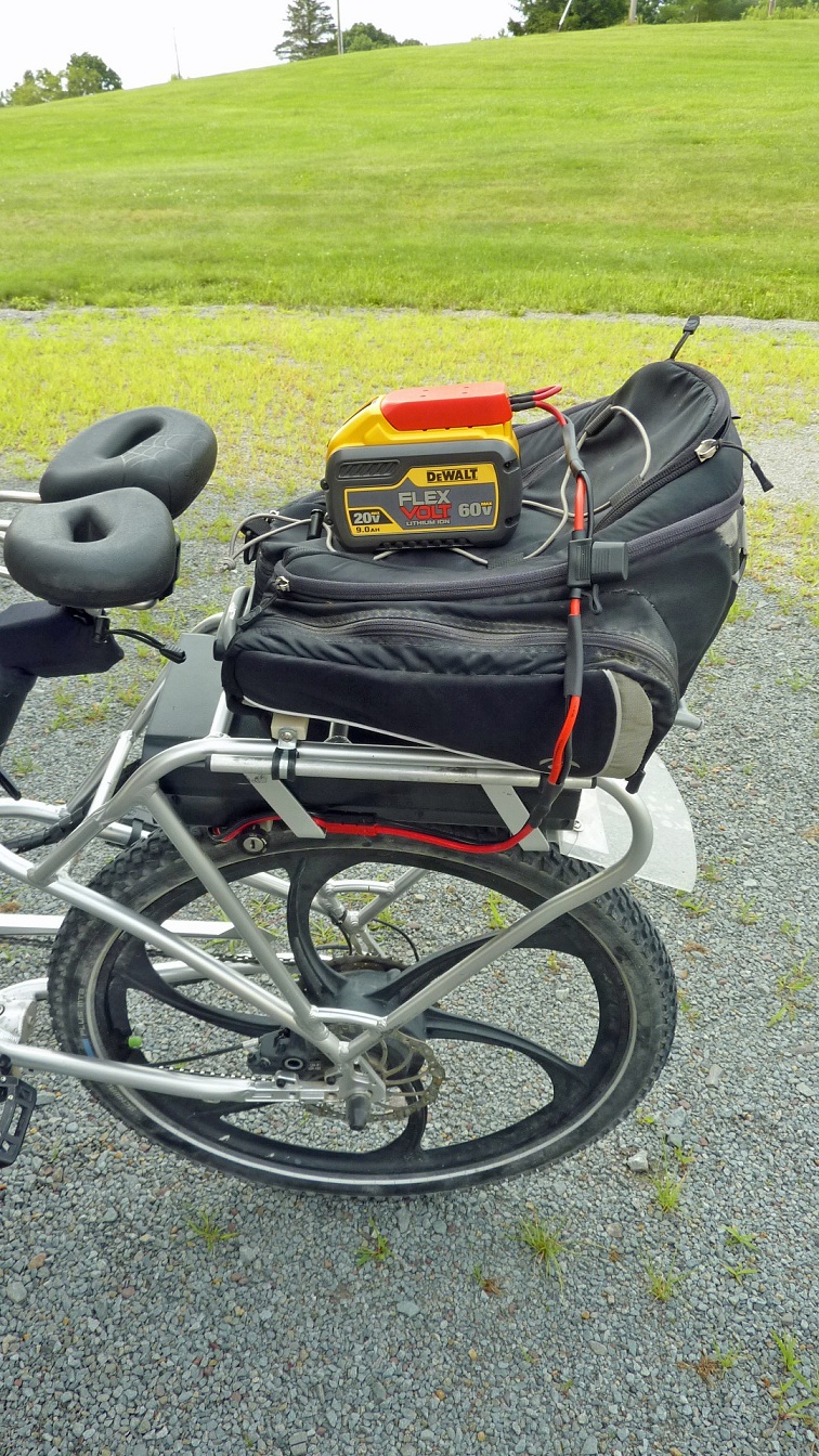

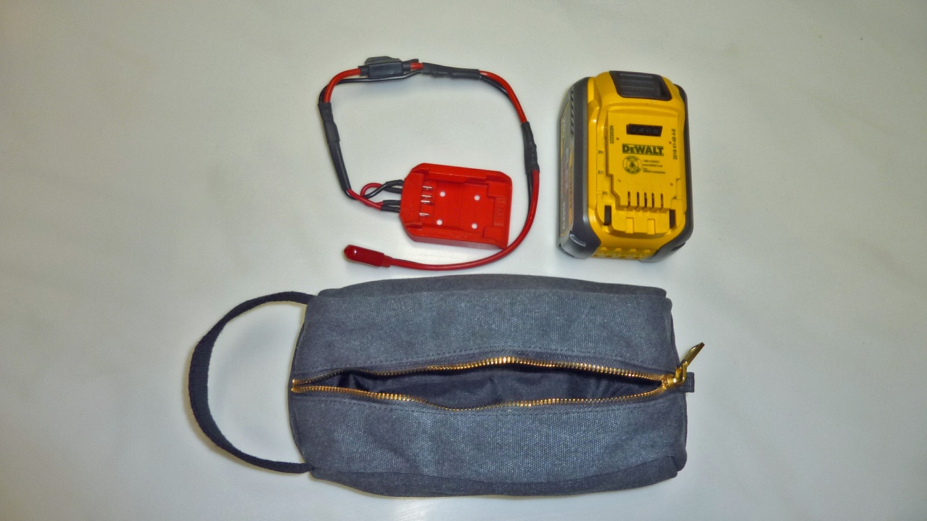

I can even use a cordless tool battery as a range extender:
The Distribution module is also a great place to connect accessories like headlights, horns, and USB or 12V adapters.
You can choose any connector type as your "standard" and adapt it to your needs. That way, you can use any battery of the correct voltage.
