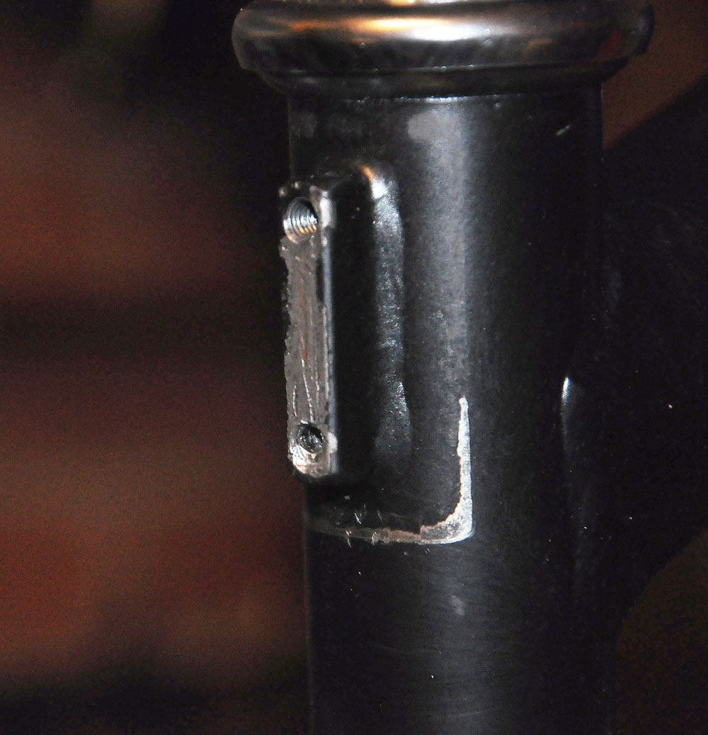

I want to use Brompton bags, so I'm hoping to install Brompton block adapter. It's not the same hole configuration but you can buy an adapter for Dahon which also has 15mm distance between holes. If this doesn't work I'll ask my local bike to drill holes.

Maybe double check on the Tern and Dahon forum pages, but I think they might have just two front frame mounting holes 30mm apart (which would work) and I think they might be M6 (2mm larger). That just means that the holes on the adapter could be 2mm looser than the M5 that would come with the Dolphin, and you'll only be using two fastening mounting points instead of three. A couple small lock washers would resolve wiggle room, and an upgrade to slightly longer 10mm or 12mm M5's might be a good idea. I'd also mentally revise the 20lb cargo limit down to about 15lbs or less if there are fewer mounting points bearing the load.

Great idea. There are a variety of accessory blocks for Brompton, some have two; some have three holes not sure which one you have on order. For sure looks close enough to try. Even the 16mm triple spacing with M6 holes, should fit because the M6 holes would have an extra 1mm of radius in there. Minor tooling worst case. Now you have me thinking...

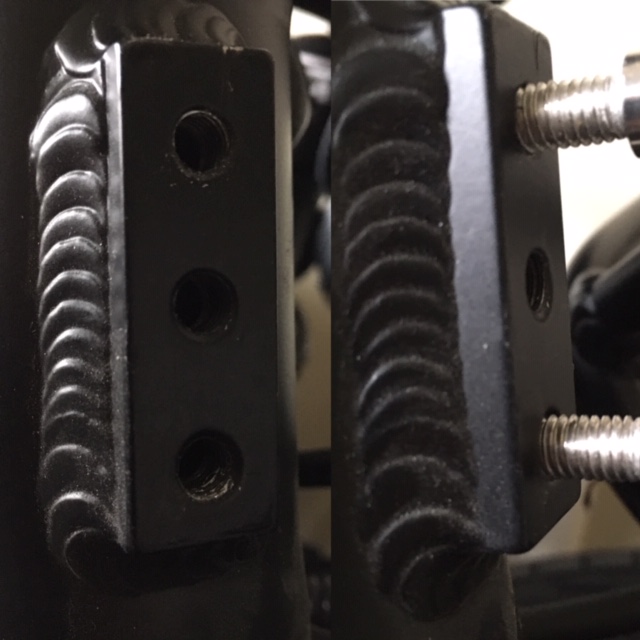

The Dolphin head tube is tooled with three x M5 threaded front luggage sockets and comes with the shorter 85mm M5 bolts you'd find for a std water bottle cage (which use a Metric 4mm head allen key/M4 hex tool). These are on a frame-welded luggage bar that sticks out about 7.5 mm (l) and is 45mm (h) x 15mm (w) with rough heavy duty aluminum welds. Eyeballing, it looks considerably wider than the Brompton's (see below). Depending on size of the cutout on the block adapter, it may require a bit of tooling. I'm watching this Brompton front Luggage Block installation video and I am now more confused than ever because they are using a 4mm hex tool, which I infer as the bolts being the same M5 (same as Dolphin) not the M6 as I had previously thought (slightly larger). Anyway, I wouldn't worry too much about the bolts, more the mounting block and cutout. The plastic types can be easily bored out if necessary (see last pic). Hope this helps and works. Looking forward to seeing the finished product!

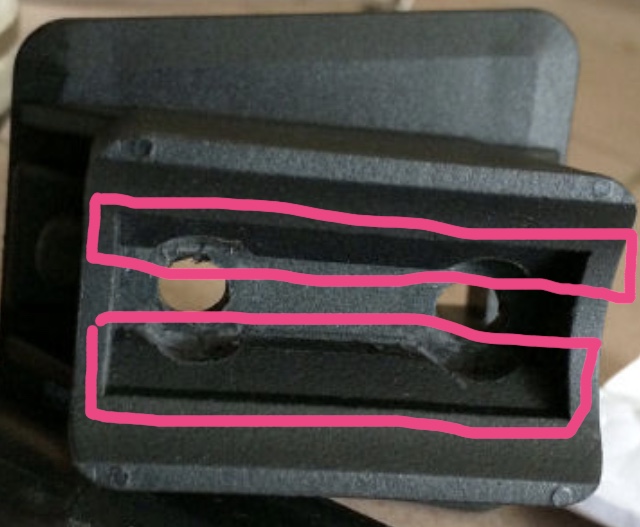

Thanks for this. I bought the Brompton mounting block. I don't even think I need any adapter. Since the block is made out of plastic I'm shaping it to fit my volador. I redrilled the holes to be bigger and added another hole in the Brompton metal attachment plate. Got M6 screws but 10mm is way too short. Going to pick up longer screws. Hopefully tomorrow I will have it done. I need to figure out where to put the light now. The cable is pretty long, I just need an extension arm so the light sticks more out.

Good plan. The bolts in that video look to be 20mm or longer. I put 15mm Titanium in mine. For the headlight, there's more cable hidden in the control box that can be extended out. Don't be afraid to invert the hanger and drop it down below the Brompton block. The light is mainly a safety indication for motorists. It doesn't cast a meaningful beam if it's really dark, esp at 23 mph. If you're on well-lit city streets, motorists really just need to see you, and register your speed and direction. I just ordered a Classon helmet that does a lot of that with blindspot protection, 6hrs of camera footage, signals, brake lights etc. Psyched.

From my calculations I think I will get 22mm bolts. But I need M6 not M5. I went to a hardware store yesterday and tried.
