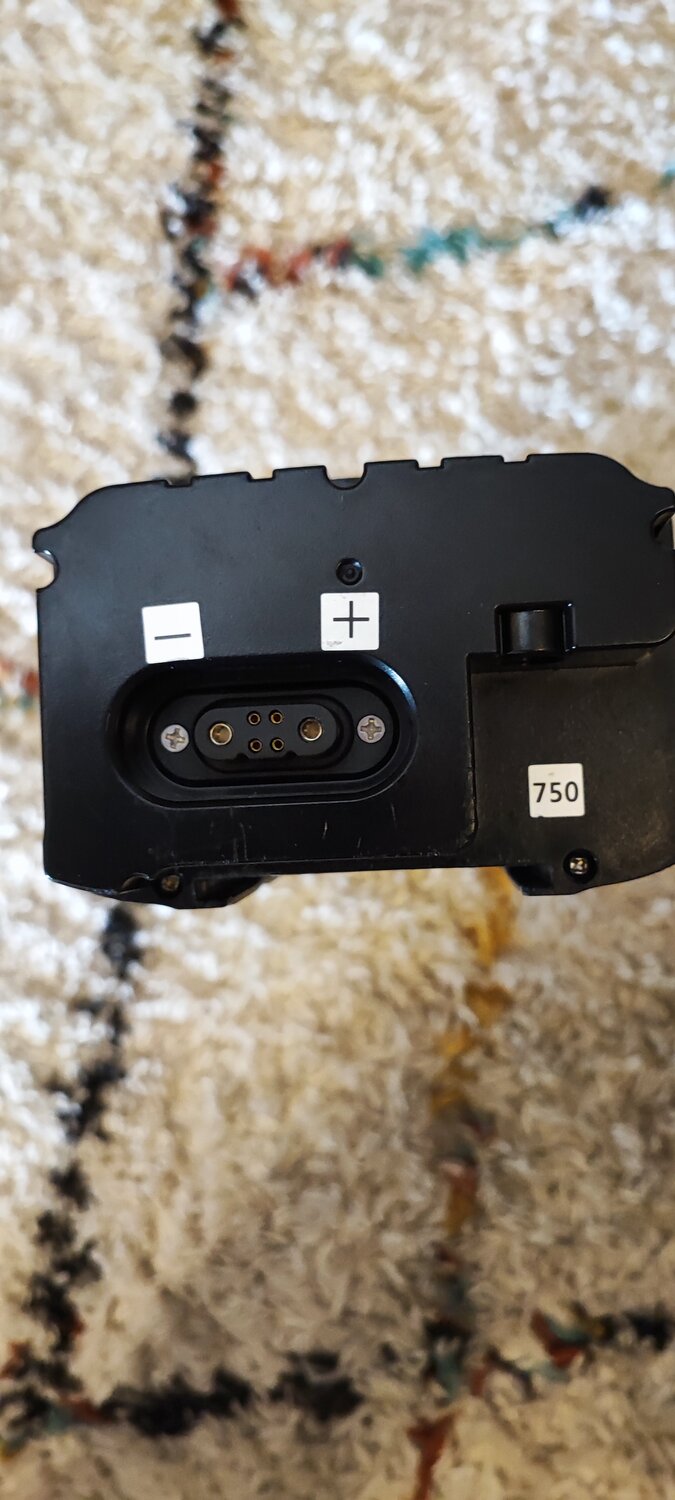

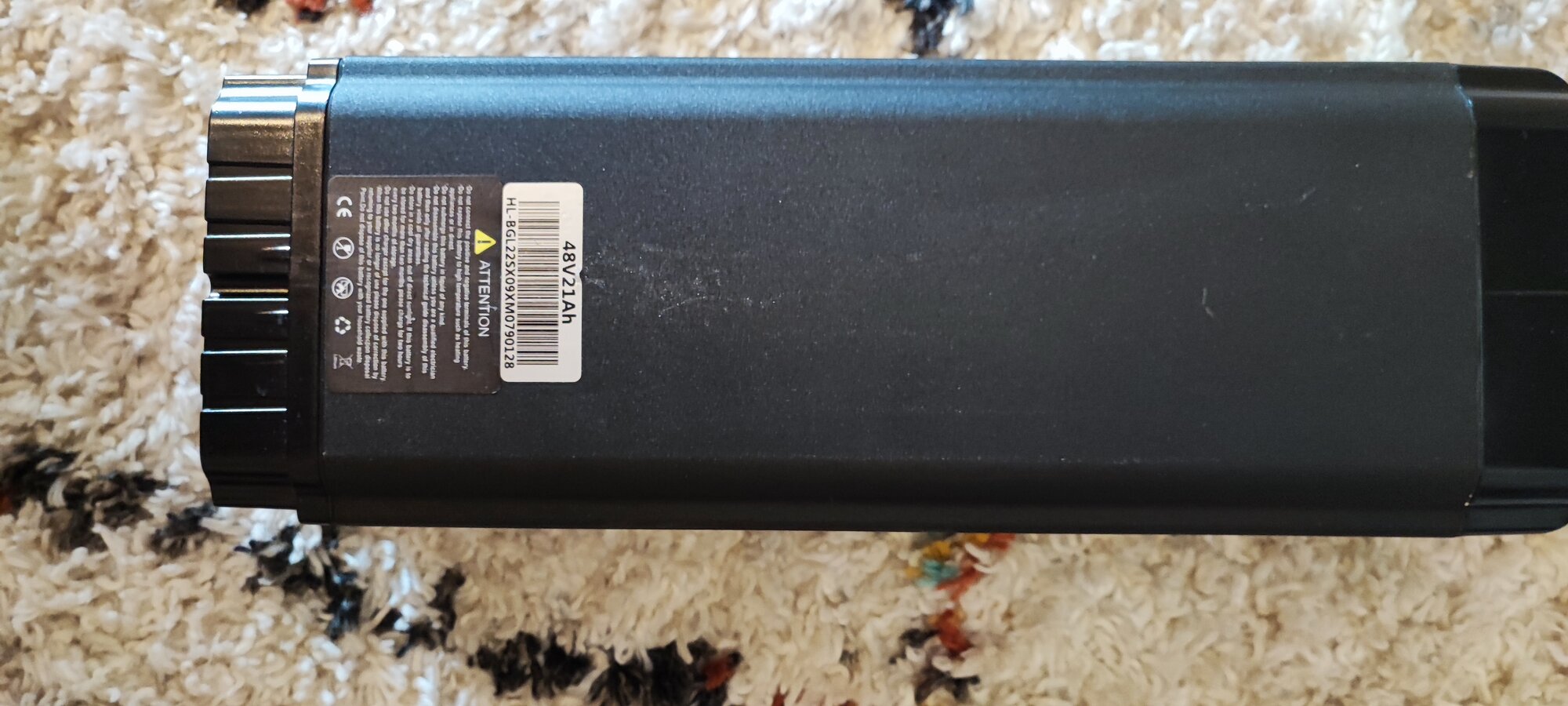

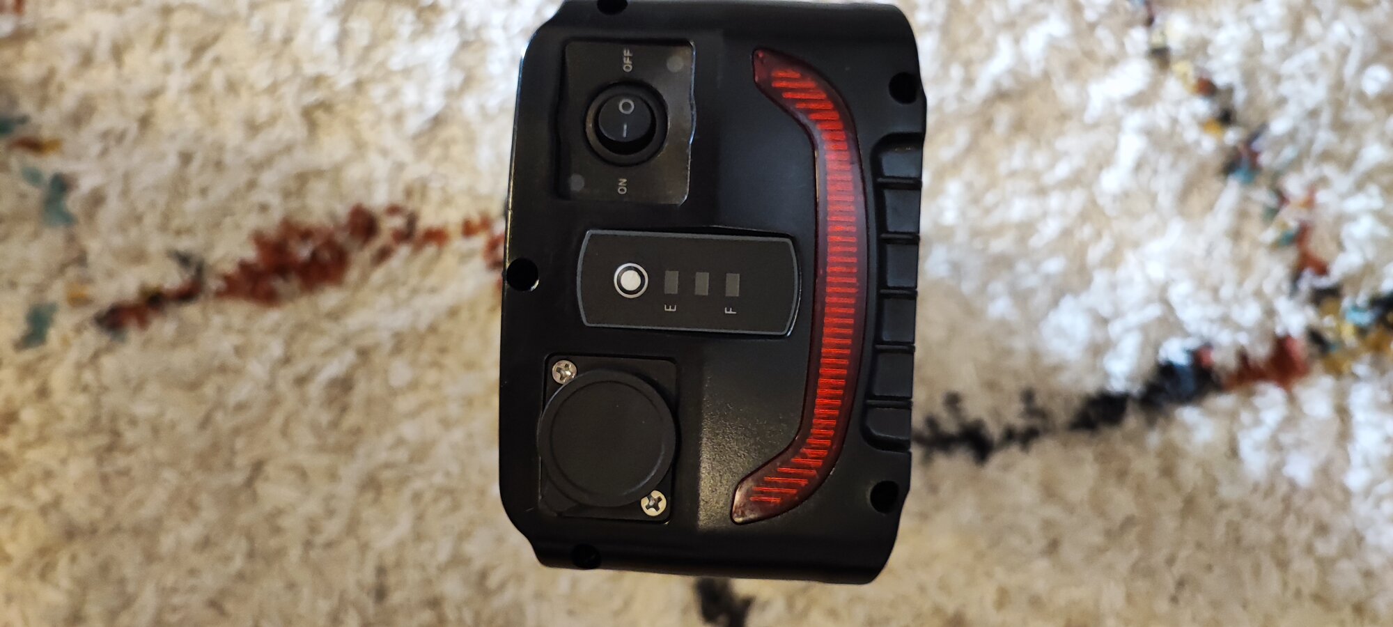

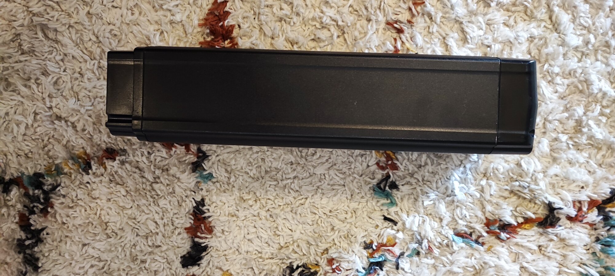

Hopefully my battery will be able to work with 750watt 48v bafang rear hub motor,with a 22a KT controller.
Aha gotcha thank you did you manage to view the photo of my battery is it sufficient enough.any input please
