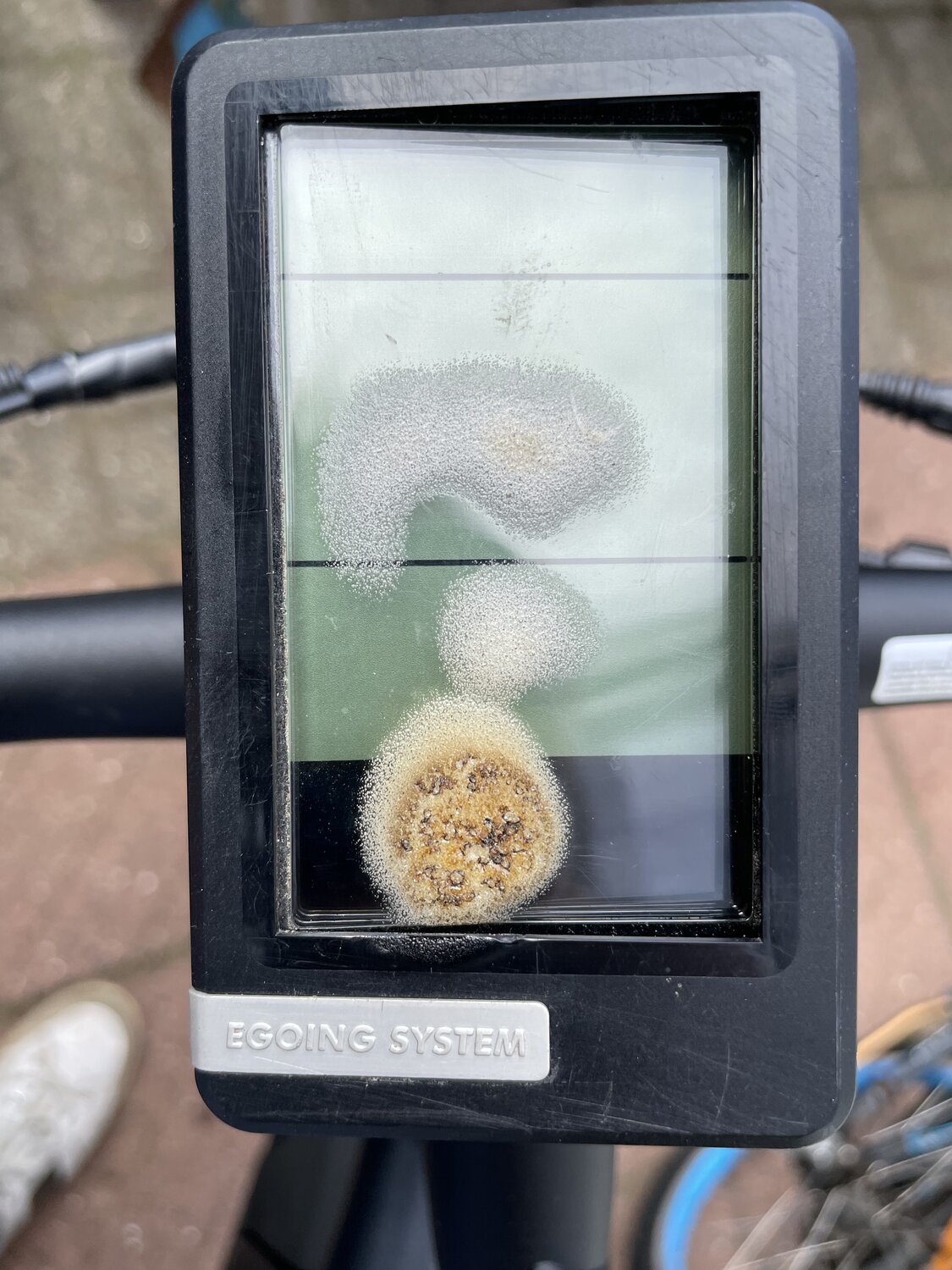

It has a bafang mm g330 motor and a display all branded "egoing"
Unfortunately some vandal has left burn marks on the plastic covering the display, making it hard to read.
I was looking to either replace the plastic or buy a new display and therefore looking to this forum for help, as I'm not sure which displays are compatible with my motor. Everywhere I look, new displays are for the bb01 and bb02 models.
Any advice?
Thanks in advance.

If it's of any help, because you have a Bafang motor, there is no assurance a Bafang display is going to work out for you. Bafang hub drives use a 3rd party controller, and the display that will work with that controller is what you are after. The controller and the display must be compatible!
Though there are a few exceptions, the Bafang brand displays are generally used with Bafang mid drives, which use built in/internal controllers by Bafang.
Point being, the display in your pic is not likely a Bafang display.

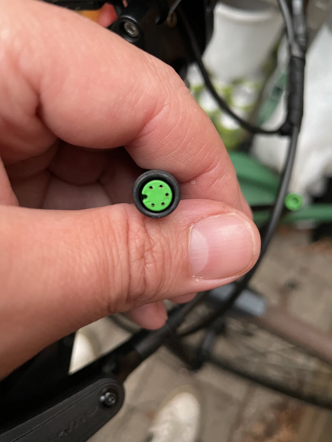

The display does have the green UART connector, does that say anything about compatibility?
Sorry, I can't be of much more help. I'd feel bad feeding you info that could be wrong. Have a look at this for some ideas maybe-
If that round green pin connector on the controller side is a male plug, which is a bafang oddity for their mid drive displays, a BBS02 display might work, but it's $76 shot-in-the-dark gamble.
Everyone else that I've seen uses a female connector on the controller side of the cable. That would be all the KT displays, the Brainpower S866 and S830, and my SW900 display, All of these use the same pinout by the way, and will power up if plugged into a foreign controller, but they won't work. My BBS02 display is the C965.
The attached image is the display side, so that speaks for a bafang display, right?
