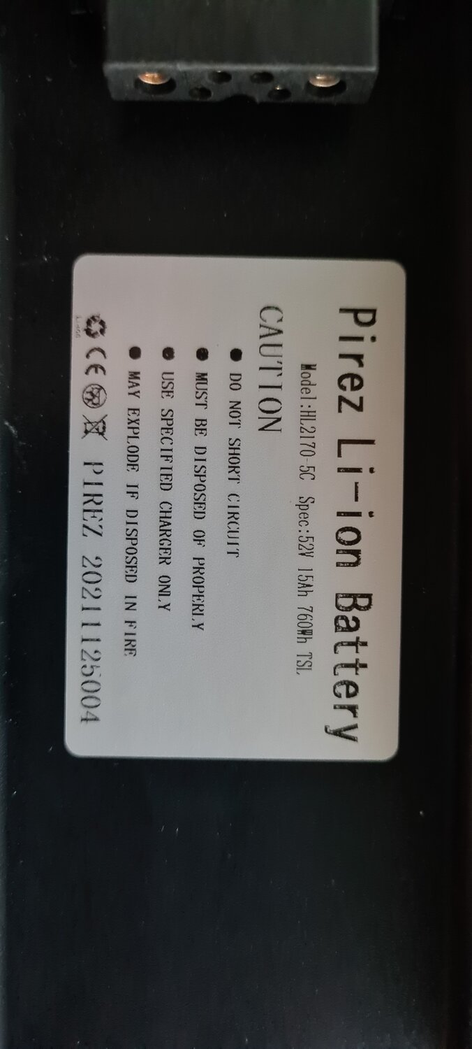

Here's the new battery.
I'm yet to get the motor hooked up to the pc to read the specs.
Yeah you should be getting more out of the battery.
Fully charge it to see if it will accept a full charge as that is one indication of bad cells. Then run it down to see at what voltage it cuts out.
On the display settings.. change the Battery to show VOLTS as % is notoriously mis_calibrated
On the other end it could also be lower rated cells not totalling 15ah

Sadly many batteries are sold and don’t meet the claimed Ah.
Well to some extent you will never get full Ah out of a battery as that rating is the sum of all the cells full rating and the BMS will shutdown before you get to empty.
But yeah... Some battery ratings seemed to be pulled out of hat while others fall short with crappy cells
Luna, UPP, and many others....

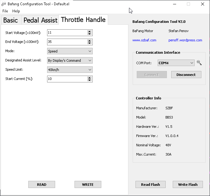

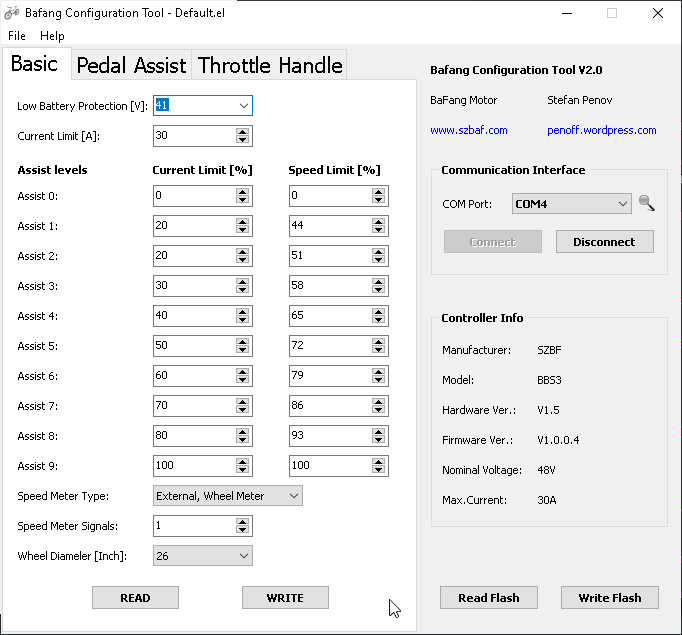

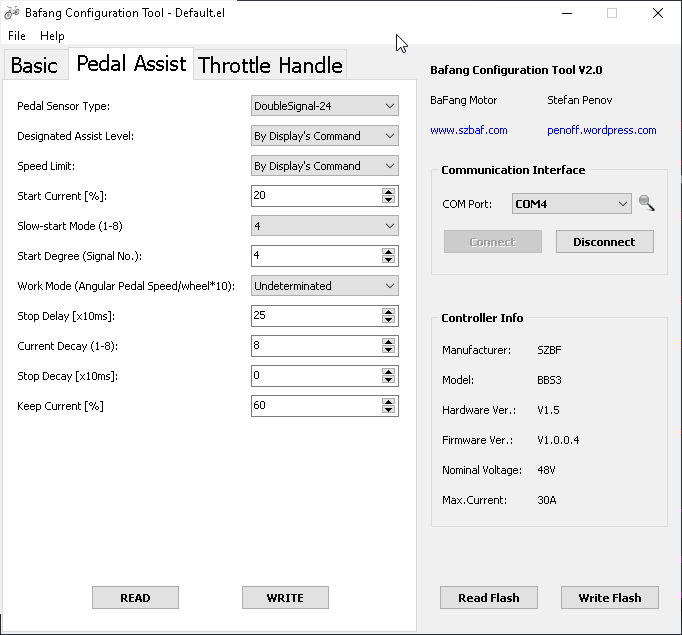

Ok, a couple of questions, firstly, how can i get my display to show things in Km/h and not m/h?
Secondly, is there a way to get trip information out of my motor?
IE: distance travelled, power provided over time graphs, velocity over time graphs, etc?
