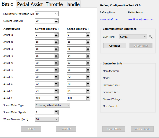

If you are still willing to entertain this... You can download the software here
Just select Free Download and don't be distracted by all the advertisements.
Software Developers Page for some background.
Once connected, click Read Flash and you should see the Controller Info.

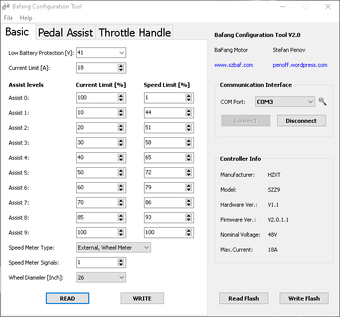

A 750W will have a Max Current of 25A, I believe the 500W is somewhere around 18A.
Yikes! I made several mistakes here but If you ordered a 750W motor they bilked you. You have without a dought a 500W. Bafang can be weird, but not weird enough to sell 500W motors with 750W controllers. No need for a programming cable in my mind. I'd insist on a complete motor/controller replacement. Period. Was this Lunamate?

Bought a programming cable from ebay, here's the results.
As mentioned above 18A was supposed to be a 500W, could anyone confirm this?
Yes.. It is 500w
Mine is a 750w and reads Controller Info / Max Current: 25A
