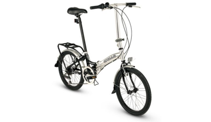

BAFANG BBSHD 52V 1000W Mid Drive Motor Conversion Kits for Ebike BB 68mm 17.5Ah. It has the DPC18 display and the 40t chainwheel. And the back rack 17.5Ah battery. I fitted it on an apollo folding bike 1662851202887.png
