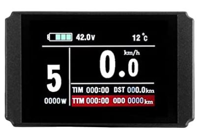

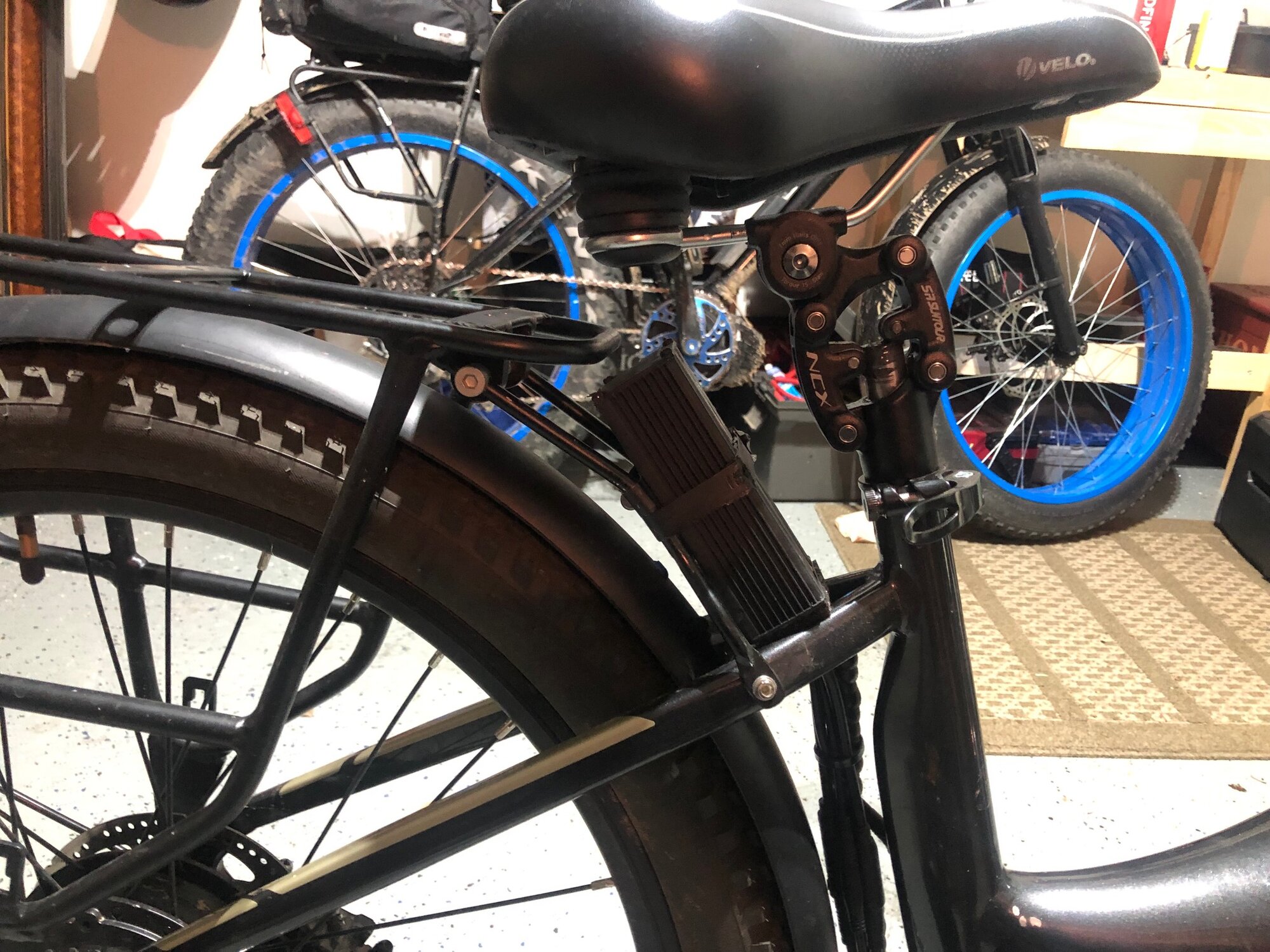

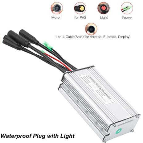

I took the advice of AHicks and replaced the stock controller with a 22a KT controller and KT color display on my wife's Aventon Level. The new controller puts out 1,050 peak watts according to my display. My wife did not like the quick acceleration of the stock Aventon PAS. PAS-1 was too fast for her liking (12-14mph). Her PAS-1 now brings the bike up to 6mph instead of 12mph. Many programmable parameters, throttle on startup, three different PAS profiles. Very smooth acceleration, almost no motor noise. KT's "Imitation Torque Control" feels much better than the speed based PAS on the Aventon. The "Fast" PAS profile is aggressive enough to keep pace with my 1450 watt BBSHD Mid drive fat bike in the background. Being a rear hub, the Aventon cannot climb hills in the same manner but it does remarkably well. I'm going to install an 11-42 rear cog to increase the climbing ability. I painted the controller flat black and mounted the controller externally to the rack brace below the seat. You will need a main harness extension cable and extend the batter/power wires. And I added 2.8"(rear) and 3" tires (ftont).
KT does make a smaller 17a controller that I believe will fit in the downtube.
. It will not fit inside the downtube. It was pretty much plug n' play.

Hey Tom - can you please provide the part number or link for the 22a KT controller (and for the smaller 17a controller if possible)?
I ordered thru Amazon. They have 4 in stock as of right now
Thanks! I will continue to try to find one that will fit in the tube but this will do for now.

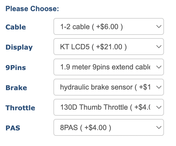

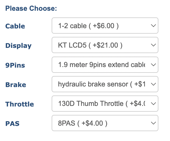

Hi @unikid -- I was wondering if you'd be able to share the details of which options you chose for the pace 350? I'd like to replace the controller on a gen 1 pace 350 -- it's my mom's and the level 1 PAS is way too fast for her, and we'd like to have throttle on demand to help get the bike moving from a stop without having to pedal. But this is my first time modding an ebike and I'm unsure which of these controller options are in/compatible with the pace 350.
Thanks!
Thanks!
These are the options I went with:
  • Brake - Without Brake
  • Cable - 1-4 Cable
  • Display - T-LCD3
  • 9Pins - 60cm 9pins extend cable
  • Throttle - Wuxing 130X Thumb throttle
  • PAS - KT-V12L
